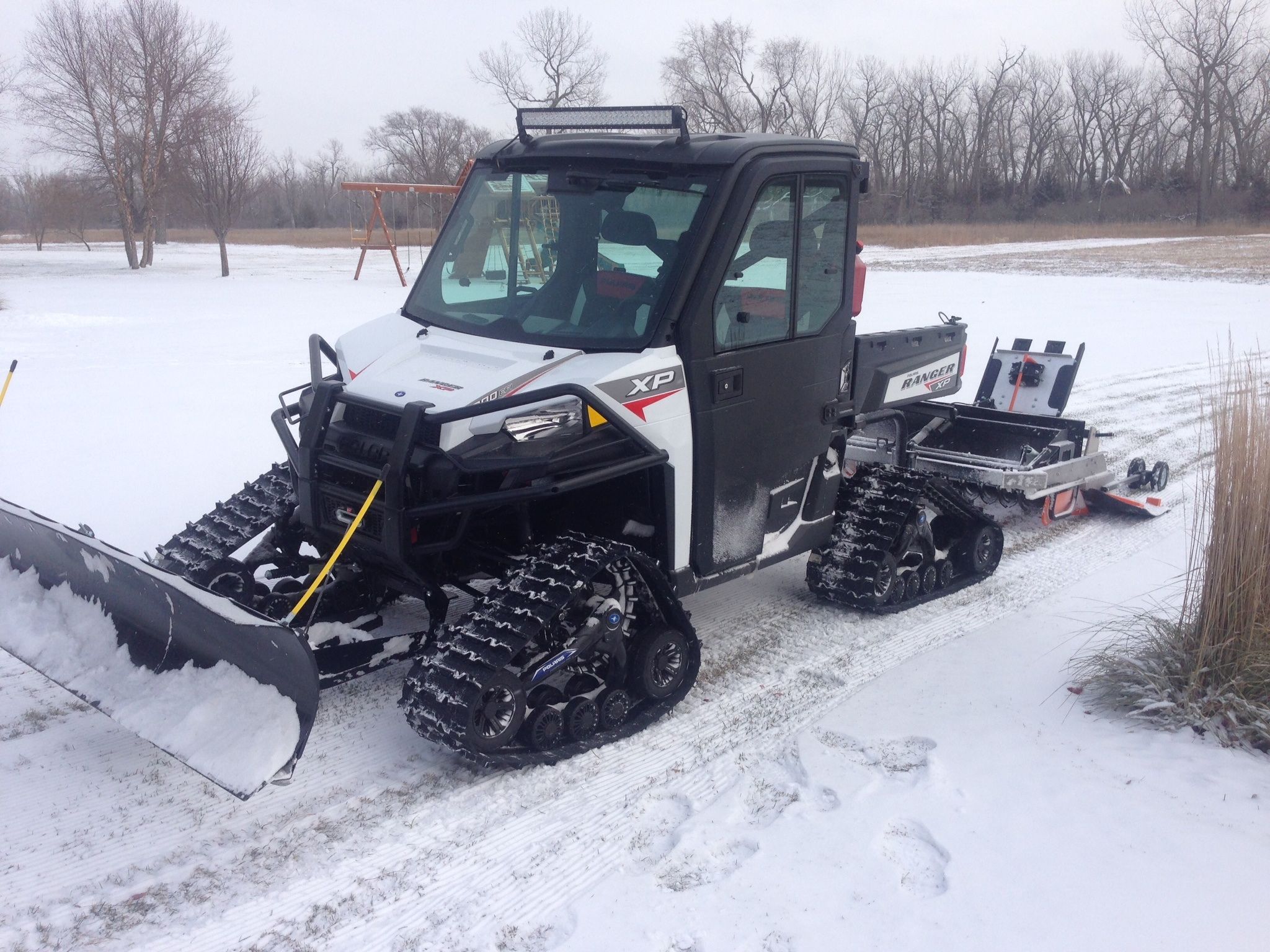

Hi Everyone,
We are in the market for a UTV (2 seater not 4) for our mountain property. We have 47 forested/rocky acres with some hills and are at 8600 ft. At a minimum I want a cab and heater. We will be using it as a snow plowing machine in the winter for our 1/4 mile of disintegrated granite road (with some hills), moving wood/rocks, and helping get to more difficult places a truck cannot.
My first thought was a Kubota RTV 1100C, but I am concerned about a diesel with no turbo at our altitude. Previous experiments with non turbo Diesel engines on tractors didnt go so well. The Sidekick was my next option, but they dont have a good plow option (at least from Kubota). It is basically an ATV plow with mechanical angle.
This needs to be a UTV, no trucks or jeeps. They are too big to get places on our property. So what does everyone think?

1000cc gas so HP should not be a problem......tracks optional

I have a Polaris Ranger 900 that I use up at my cabin at 10k feet. It does fine. The gearing has a much bigger impact on these machines than the power numbers.
I remember you being overly concerned about not having a turbo up high in elevation. I have a few pieces of diesel machinery without a turbo and they do just fine up there. Remember, up at this altitude, the air is thin. Although a turbo helps, you really have to put on a big turbo to get the mass of air needed to reap the benefits. Then the machine would be super laggy until the turbo spooled up enough. Most turbos sized to the machine can't get enough oxygen molecules crammed in the motor to really achieve full fulling, your always leaving some fuelling on the table. The computer measures the mass of air over a sensor and adjusts fuelling based on that reading. That is why having a non turbo motor at high altitudes actually gets to full fulling and I would say makes comparable power. Now if you can get a tune to adjust the fulling independent of the mass air flow sensor, then it's a non issue. You would just be burning a lot of diesels at that point and making a black cloud.
