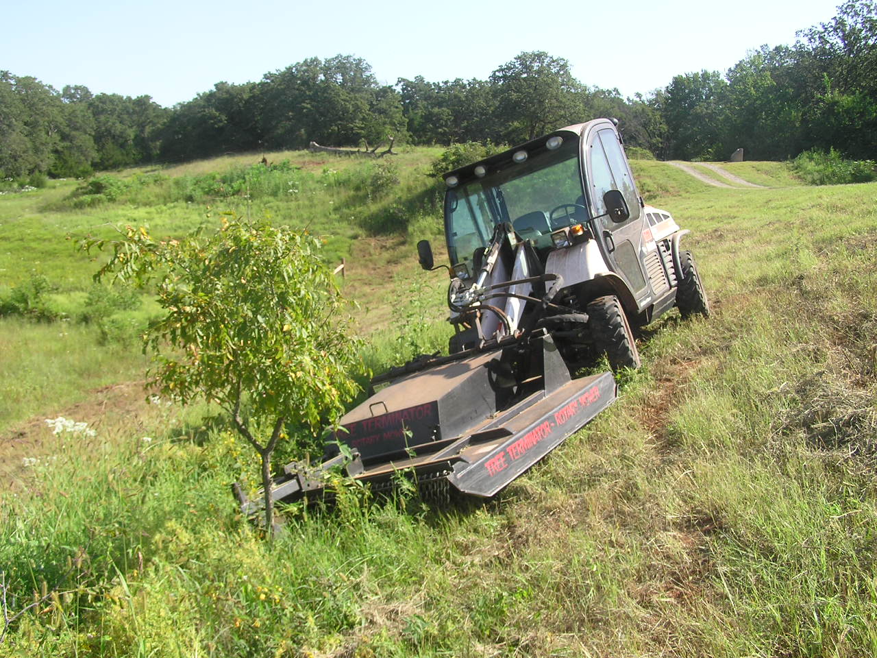

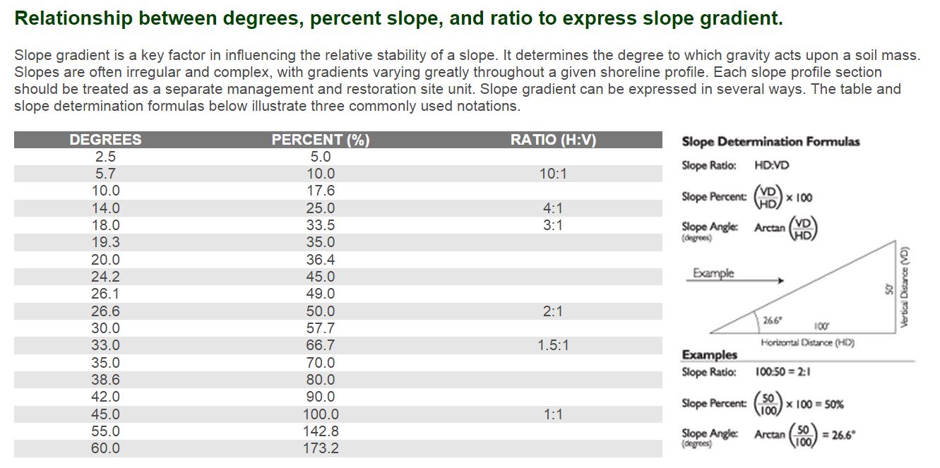

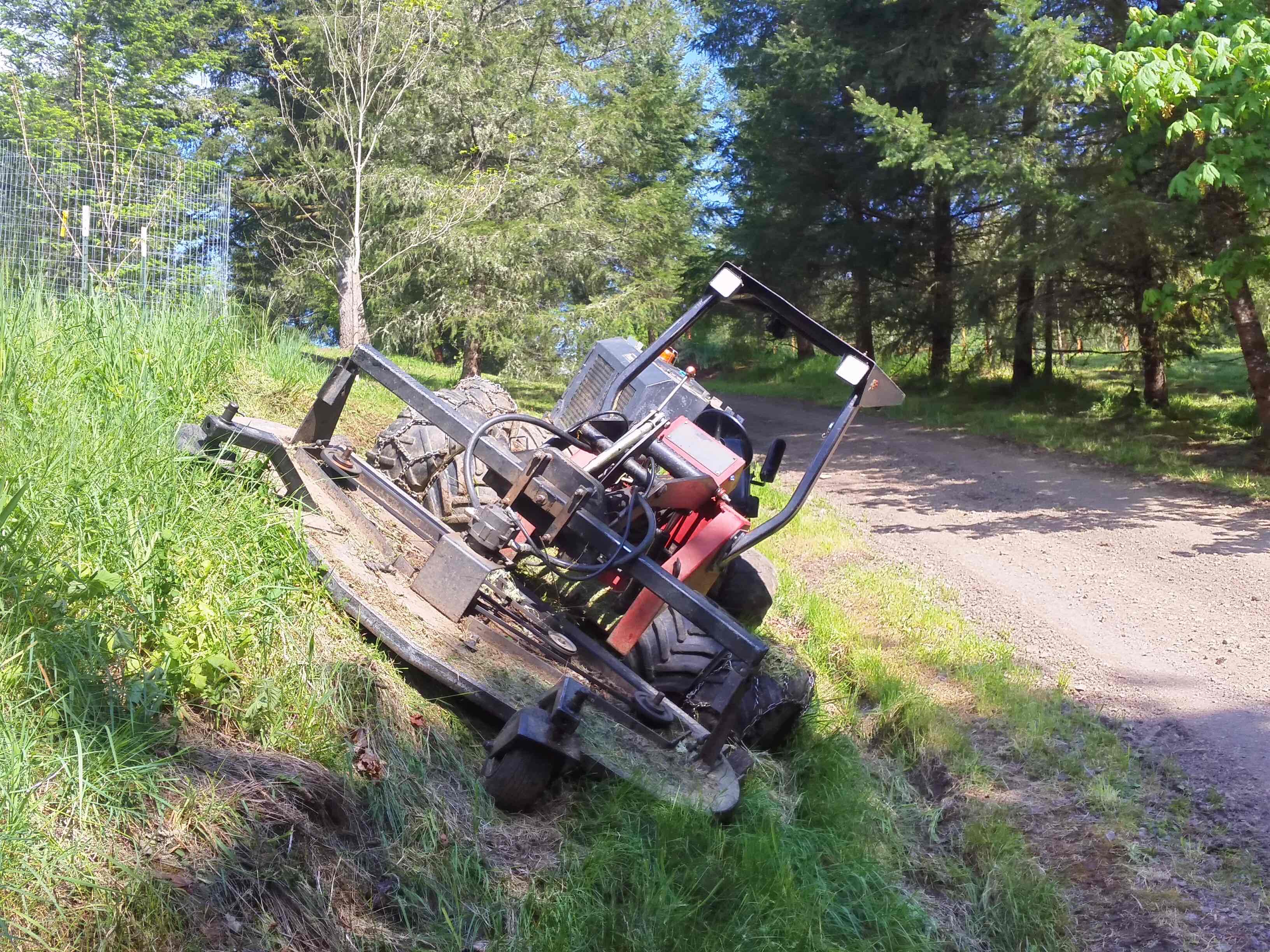

Here is a visual of an 18 degree slope, serious Pucker Factor the first time I mowed it. :eek:

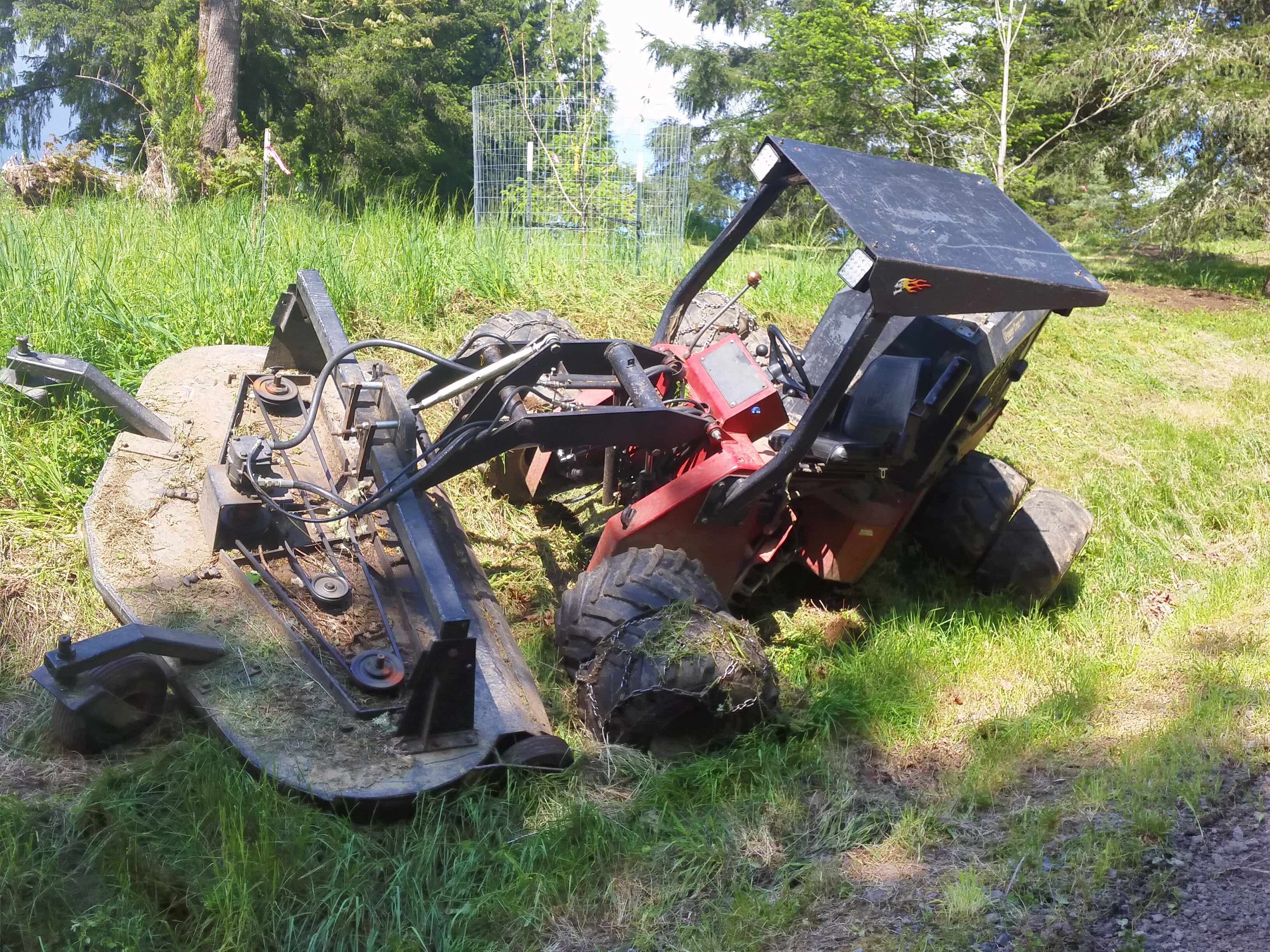

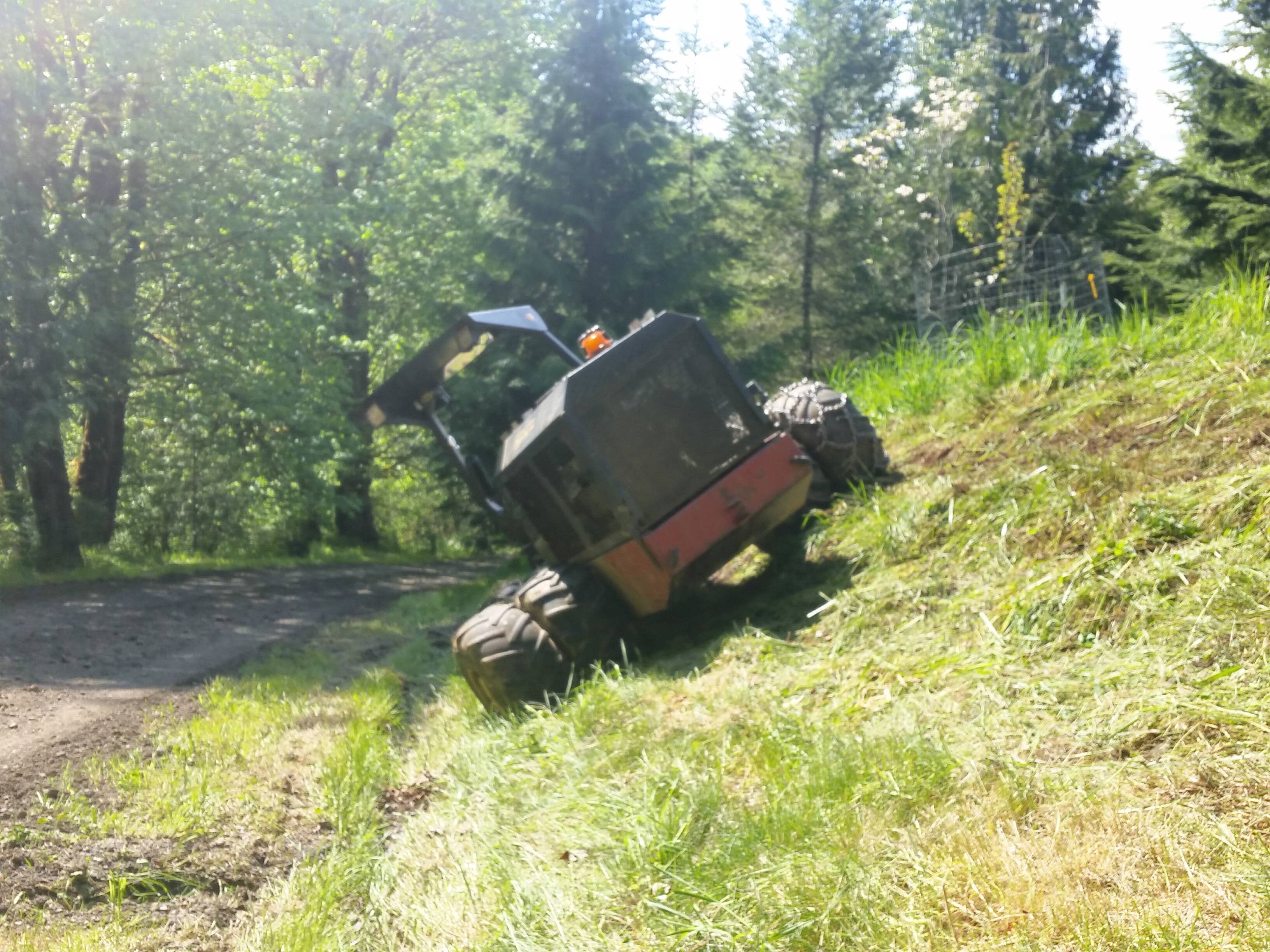

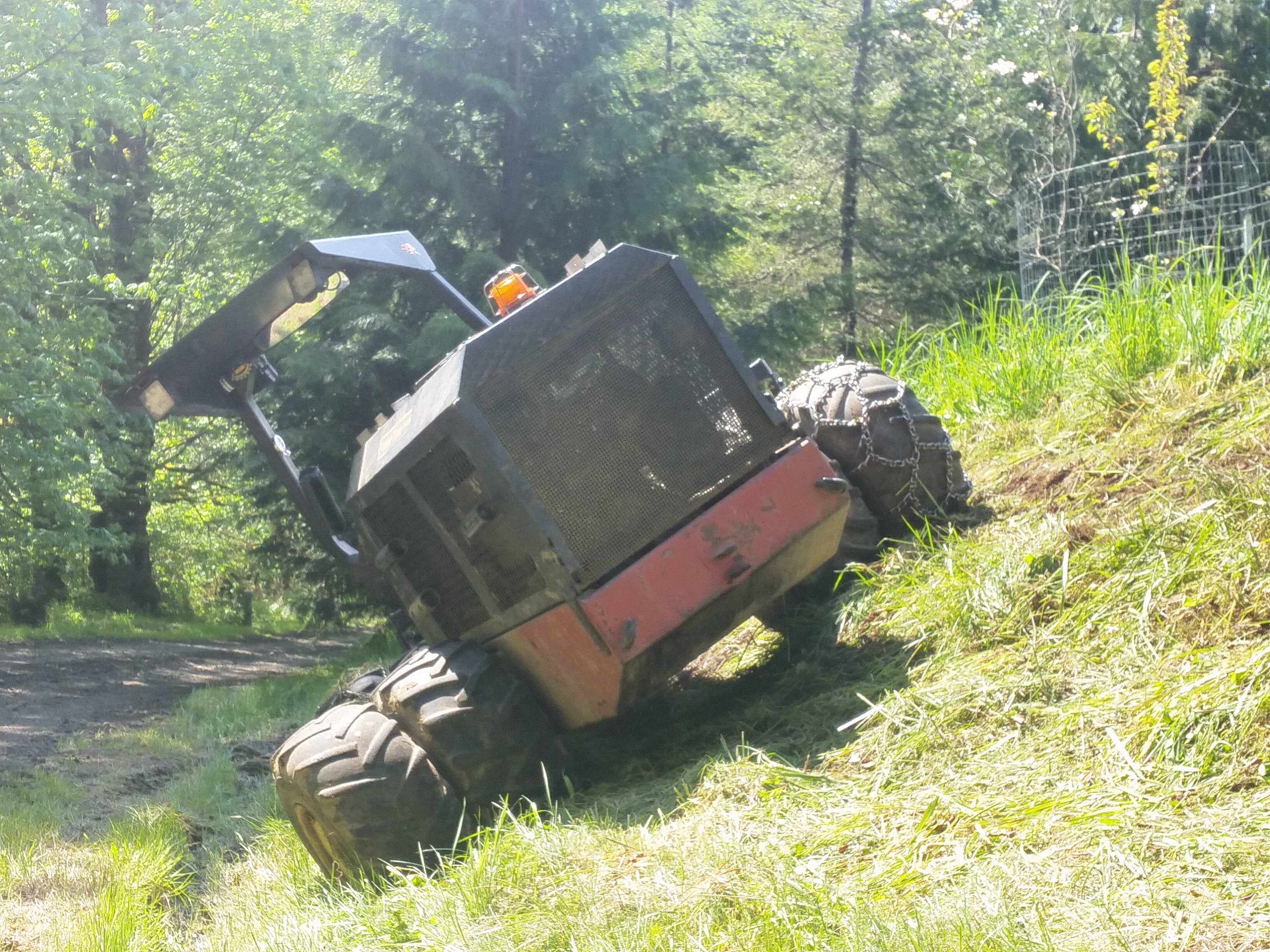

So today i had to get in a bit of mowing. I knew this section was steep but figured it to be in the 35 to 40. Actually it (according to my inclinometer so it could be wrong) is 45. I was just starting to turn up the hill and wanted to hop off and get a picture. I can run this angle and have with the bucket up and a load of something light. Would not run it with a bucket of rocks.
BTW, my tractor is NOT set up for this severe slope. It slides a lot and you have to crab to get her to stay straight. Setting up refers to no chains, great tires and pressure around 2 to 4 lbs in the tires.

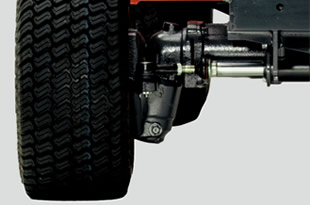

Made me go back and look again at the BX, can anyone tell me what these rod-like things are--axle? steering control arms?--and how sturdy? Whatever they are, they're gonna be in danger of hitting rocks, stumps, dirt. This is one thing I look at on every tractor.
