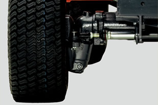

..... can anyone tell me what these rod-like things are--axle? steering control arms?--and how sturdy? Whatever they are, they're gonna be in danger of hitting rocks, stumps, dirt. This is one thing I look at on every tractor.
The shiny horizontal rod is the hydraulic steering ram (cylinder) with the steering knuckle on the end. Since they are near the center of the wheel, they are somewhat difficult to hit since the wheel will climb obstacles and tend to keep the ram/knuckle clear. But it IS possible to catch them on something like a stump or a rock that the wheel just misses. They are very solid but CAN be bent.
- Jay
