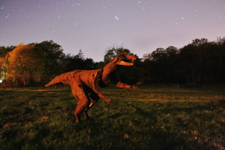

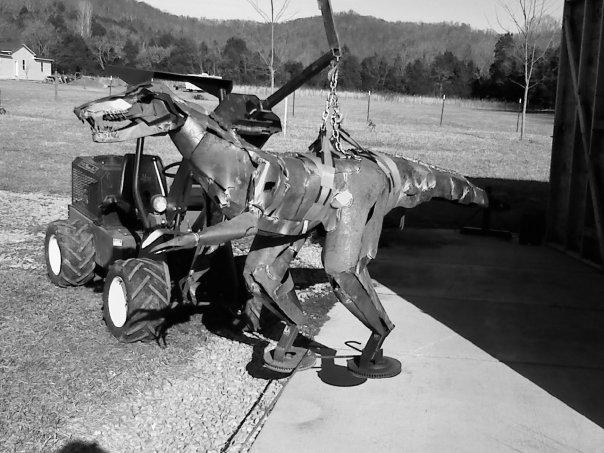

And a pic of my home-made lift boom taking Rusty out of the barn--he's about 350lbs. And another of Rusty roaming the front pasture. (Iknow, I need a hobby.)
Looks like you've got one - skeerin' the neighbors!
All welders are crazy people. I like it.:thumbsup:
