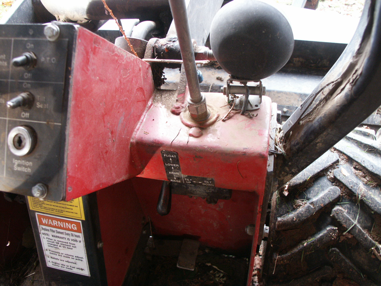

I definitely get leak down with the machine running, regardless of how fast it is running. I assume its because of the leaky control valve. If I could fix it I would want to. Is there an easy cure?

I believe the check valves you guys are talking about are called load check valves, and will not prevent the cyl from leaking down. It is designed to prevent the load from dropping while shifting between neutral and up/down. There are other external pilot operated check valves to hold a load in place until the leaver is moved.
Most leak downs are caused by worn FEL valves. If a cyl should leak down with a needle valve installed, then the cyl is leaking internally.

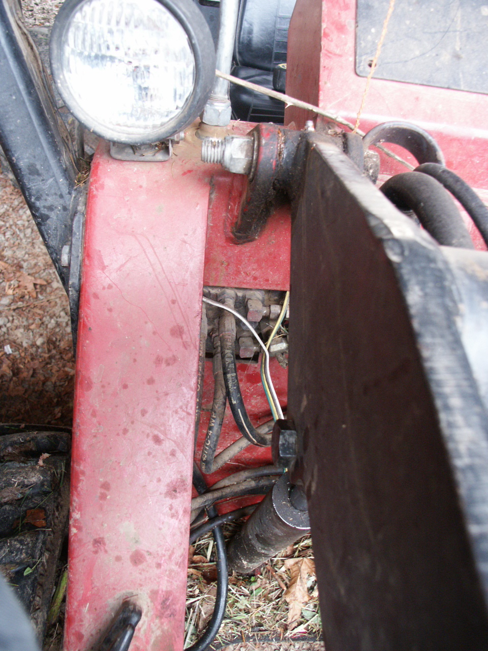

Just FYI, the leak down does not really cause me any problems. Using the PT as a man lift seems a little to dangerous for my taste, other than for say less than a minute. I would say as a minimum use some kind of mechanical cylinder block that cannot be removed while there is weight on it. I have attached pictures of mine. Please note, I did not do this for a manlift, but to work under. Edit: Of course working under it is just as dangerous. But I think using two of these brackets, one for each lift cylinder, would be reasonably safe.
