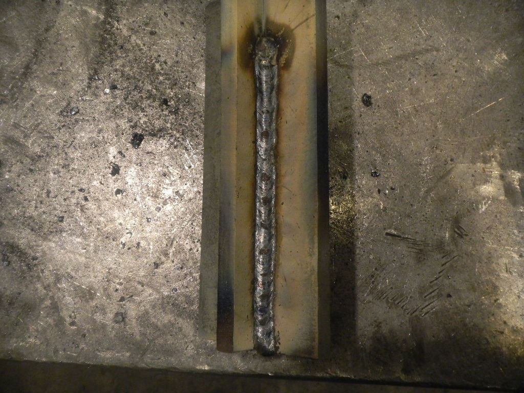

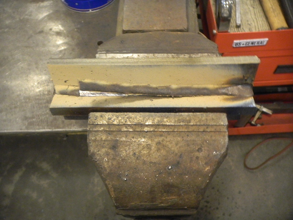

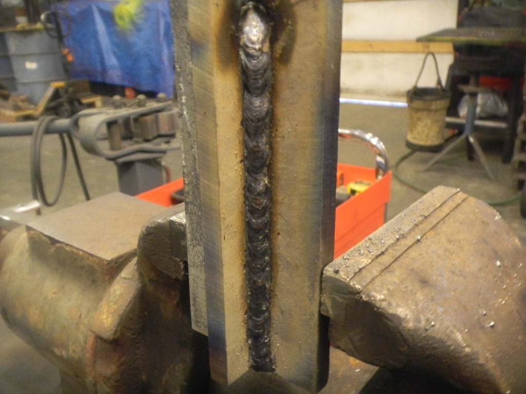

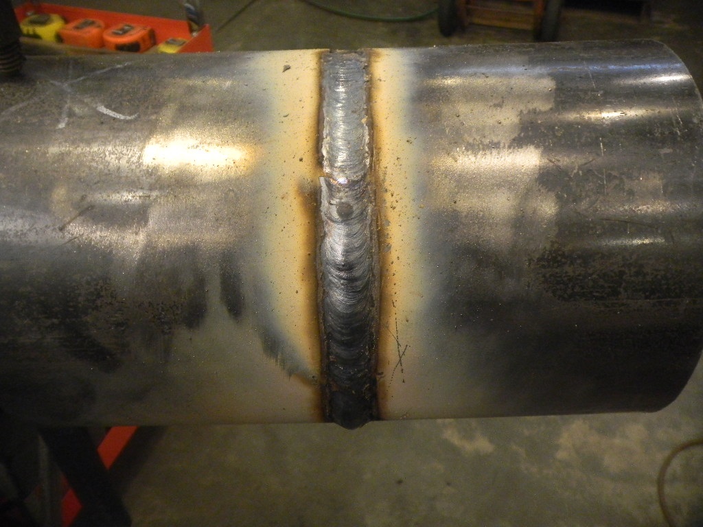

GManBart yesterday I found some 1/8" ESAB Acclaim 7018. This morning I thought I'd see how it runs on the Everlast PowerArc 200ST.
The flat fillet was run at 90-AMPS.
The vertical up fillet was run at 85-AMPS.
The cap weld on the pipe was also run at 85-AMPS.

SA,
It would be interesting to put an ammeter on your PowerArc 200ST. Those welds look more like 115 to 120 amps to me. 85 amps is right for 3/32 rod for me.
/ Ugly beads, critics welcome... #131
Oh I know, this is one powerful little welder:cool2:! It runs 10 to 15-AMPS hotter than my Lincoln V350-Pro. Now this is a comparison with the same joint prep, same type, and size rod.
Very nice!

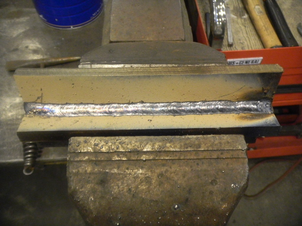

Ran a couple more fillet welds today....they all looked like this. I couldn't move any slower if I tried, so I'm wondering if the drag angle was too much and caused the pointy ends?
These were one after the other on the same plates, about 5" long each, and each used 2/3rds of a 7018 rod.
Hard to tell, without being there to watch you weld.
Really those welds don't look bad at all! Just wait until you get the PowerArc 200ST.

You are spending too much time in the middle of the bead , and stacking . Learn to roll up and down that joint , and soak it in . SA is the man .
Thanks....I'll give it a try. I was moving up and down a little bit, but probably not enough. I'm going to play with the rod drag angle, see what happens, then try more up and down (I like to change only one thing at a time when possible).
On a positive note, I've tried using the grinder with a cutoff disc to reuse a few of the plates I've welded on previously, and I gave up....the welds were solid enough, and penetrated deep enough that I would have been there forever. I think that's a good sign!
