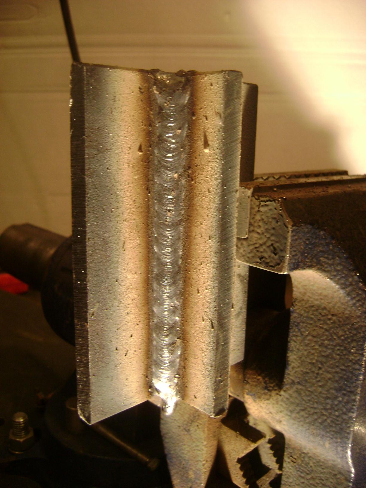

Try counting 1 1 thousand 2 1 thousand
That is only a short term fix. A guy is better off learning how to read the puddle. And learn how to anticipate what the puddle is going to do, so you can make corrections to control the puddle.

Just starting off is OK get that down before puddle reading

I'm still learning, and really trying to learn to read the puddle. That was part of why I got the undercut...I figure that's just part of the learning curve. I ran out of time or I would have run a couple more beads with that new knowledge, and I think it would be better.
The goal with my practice isn't to get a good bead, it's to learn what it takes to get a good bead, if that makes sense. I figure once I learn to really read the puddle I won't have to think about timing, or what a chart suggests as an amperage setting, or most of the other variables....the puddle will tell me if I'm right or wrong, and the resulting bead will either confirm or deny it.
Then again, I don't know anything about it, so I could be completely wrong :laughing:

Another thing is how your put the rod in the stinger put it in so it's on a 45 degree and wash the sides and don't worry about the middle.

Miller made the machines for other manufacturers but these models might have been before ITW owned both Miller and Hobart. Vertical up 7018 can be done more than one way. Some people pause at the sides longer and make what looks like criss crossing steps (usually lower amps), some people do shorter pauses with less pronounced steps and other people just weave side to side with barely a pause at all and just keep the rod moving. I've seen some vertical up 7018 on pipe that looks like it was roll welded in the flat position.
