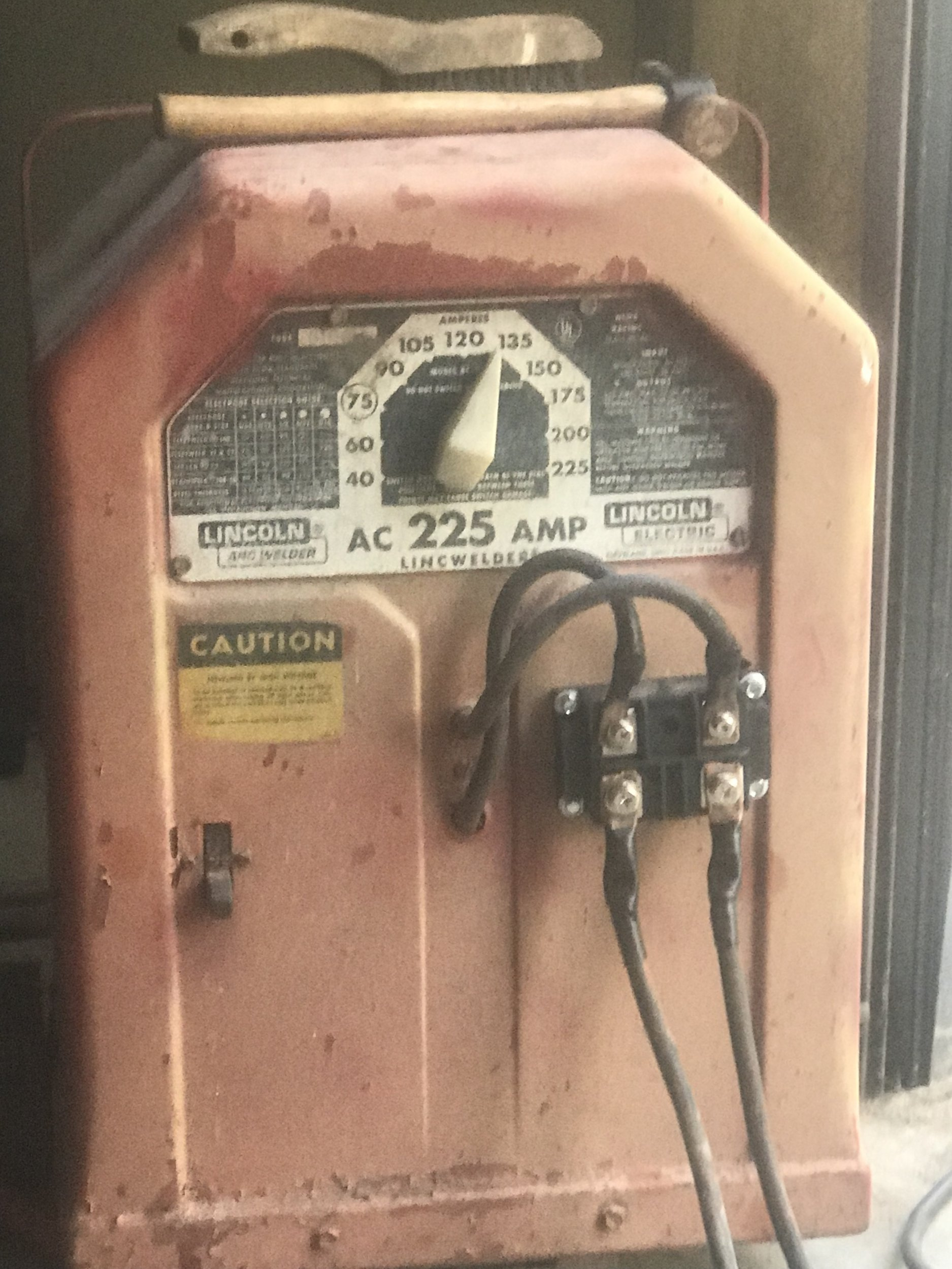

My Miller Thunderbolt. My father bought this new back when I was a kid.
/ AC to DC stick welder conversion #8
I was able to switch between AC and DC with my setup. My rectifier assembly had plugs and jacks so that you could either plug the rectifiers into the welder or plug your welding cables into the welder. I would be concerned with junction temperatures of the rectifier assembly you showed, but if it is working it's great!

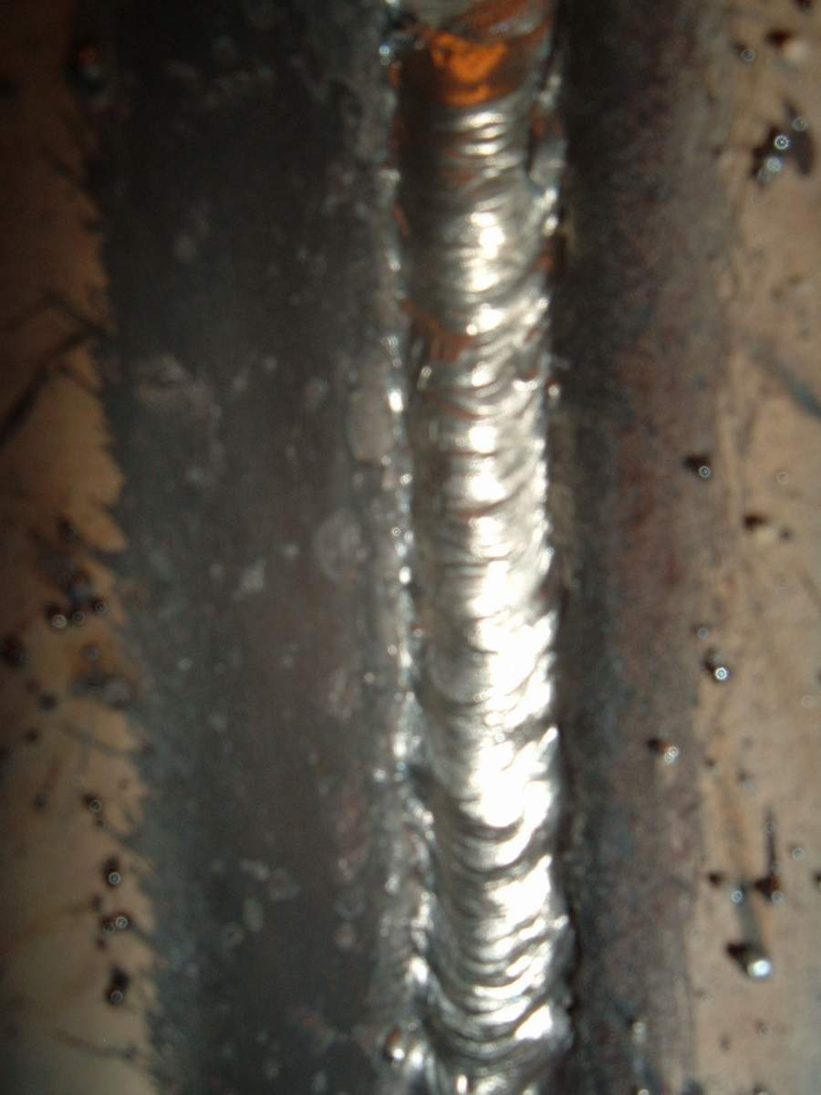

/ AC to DC stick welder conversion #20
They do and I used them a lot but they are a little loose on vertical and have to use a little weave to get them to hang in there and a bit tougher to make a flat bead. It takes a bit more skill than DC. The first pic is AC, second is DC and they could be improved some with a little practice. I am far from a daily driver anymore and its real work to hang with it till I weld a little for a week or so.
