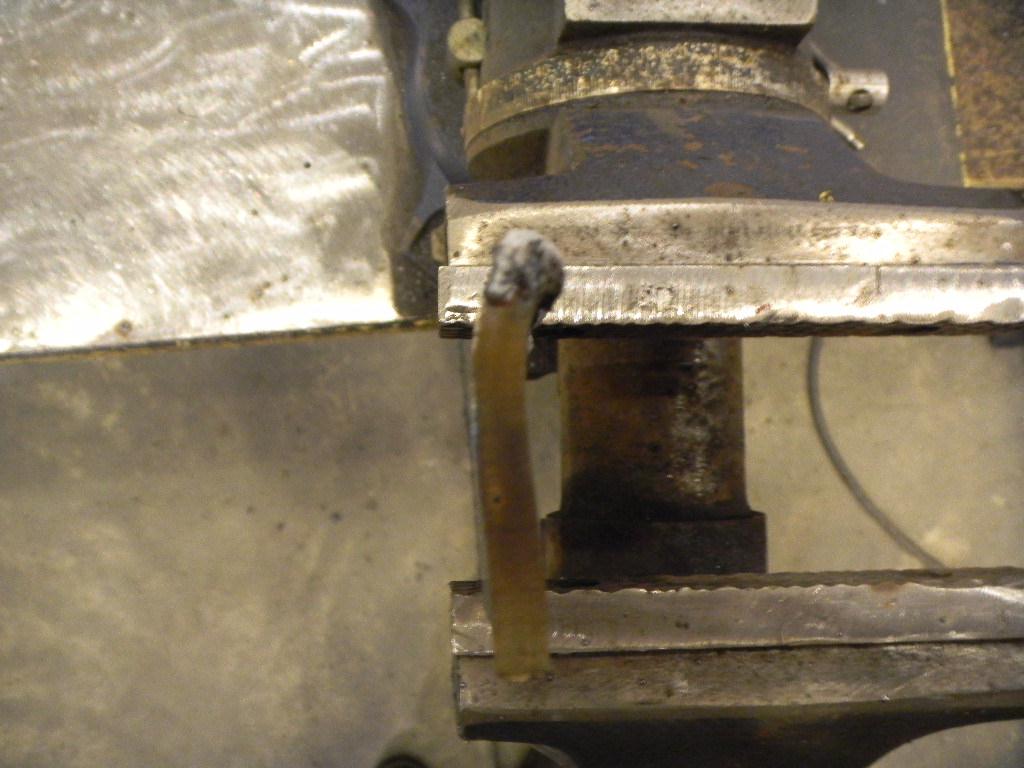

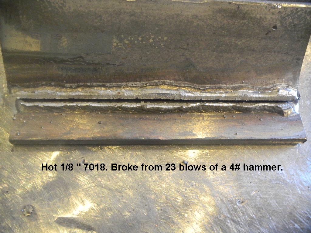

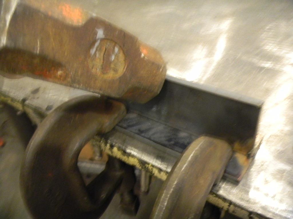

That doesn't look bad at all. Doing some break tests would help to see how much penetration you're getting.
So just weld on one side, then put it in a vise and hit it with a big hammer?

/ Ugly beads, critics welcome... #168

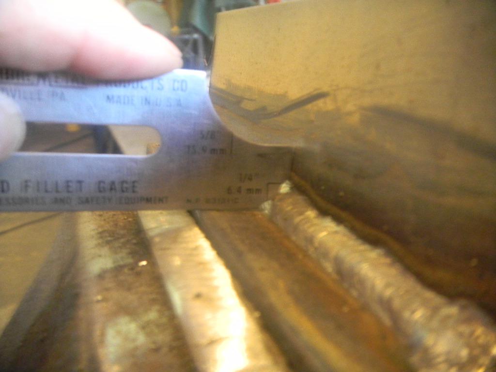

/ Ugly beads, critics welcome... #170

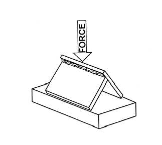

If you have a shop press with a gauge on it. It will tell you how much force it takes to break the weld.
