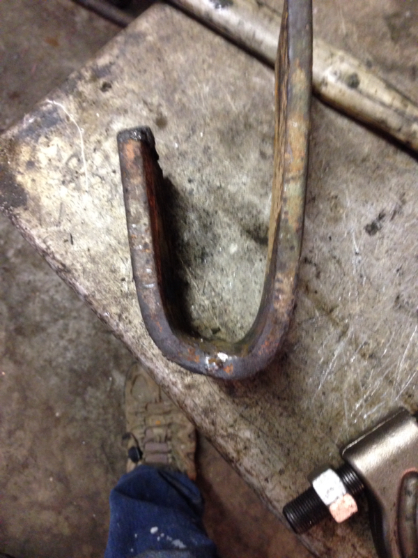

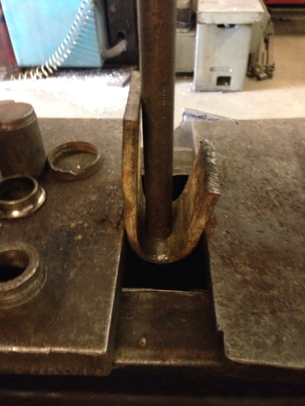

Back when I was taking a class in high skool, we had a rig where we'd bend our welds. It was interesting because you'd have the perfect looking weld, but it would crack when bent. The test piece was two 1/4x2" bars with a butt weld. You'd put the weld, facing up over a bottle jack that had two rollers a couple of inches apart. You work the jack and it would bend the bar into a U between the rollers. I referred to it as the "torture rack".
/ Ugly beads, critics welcome... #182
We use to call them the heart break machine. :laughing:
I'm going to buy or build a shop press, and plan to do some torture testing of my own!

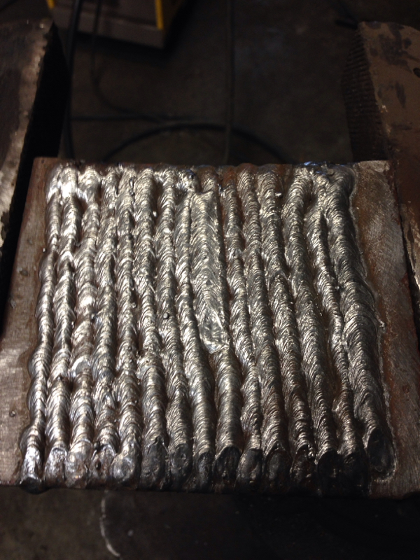

#195
Thanks George!
I had enough time today to tack up a plate on some square tubing so I can weld overhead while standing normally. I ran four beads to start a pad as SA suggested. As you look at this they were right to left, but we're actually done left to right. This will take some practice!
#199
That looks very good! :thumbsup::thumbsup:
It is hard to make a weld look good on a flat plate! You are doing really well with your welding:cool:!
Thanks!
I ran a few more beads today, and was getting a pretty good curve in the line, so I stopped, drew a line with chalk, and ran another four beads just now. I also learned that if you don't keep a bit of rod angle at the end, the slag can fall on the rod and put out the arc....did that about three times before I got the message :) That's why you'll see the poor finish with undercut (left side of the picture). I was running these all left to right, so I think I'm going to try right to left next.
