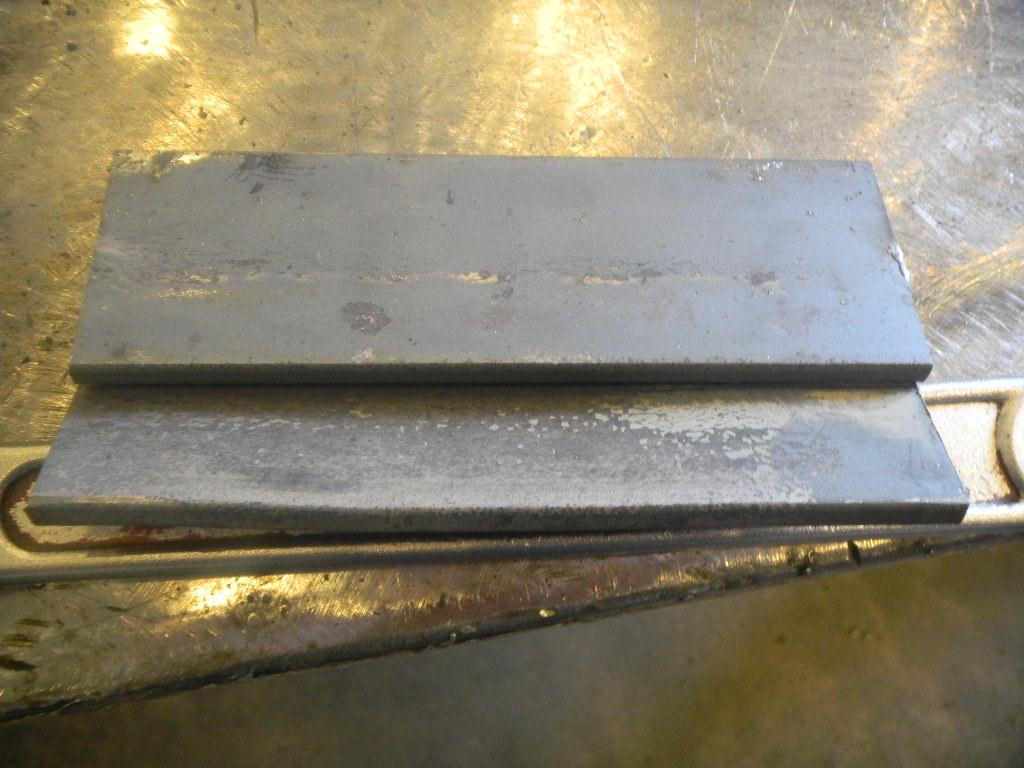

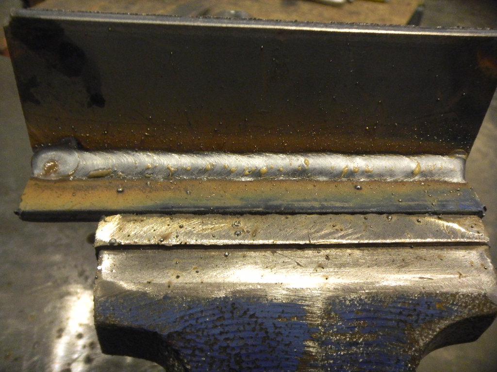

Did some fillet welds, but ran out of stock, so I tried this square tubing....this was the best of the four sides. Still needs lots of work! This was with 1/8th 7018...not sure I had the amperage correct or not. It was getting dark so the picture isn't great....sorry.
/ Ugly beads, critics welcome... #84
Little cold.
Do a little up and down movement. Hold for just a second on the upper part, give the puddle a chance to fill. Gravity will take care on the bottom for you.;)

Little cold.
I feel better after reading this. I was increasing the amperage each of the three prior beads and it got a little better each time. I left the setting where it was, and have another piece of square tubing so I can bump it up a little and try again.

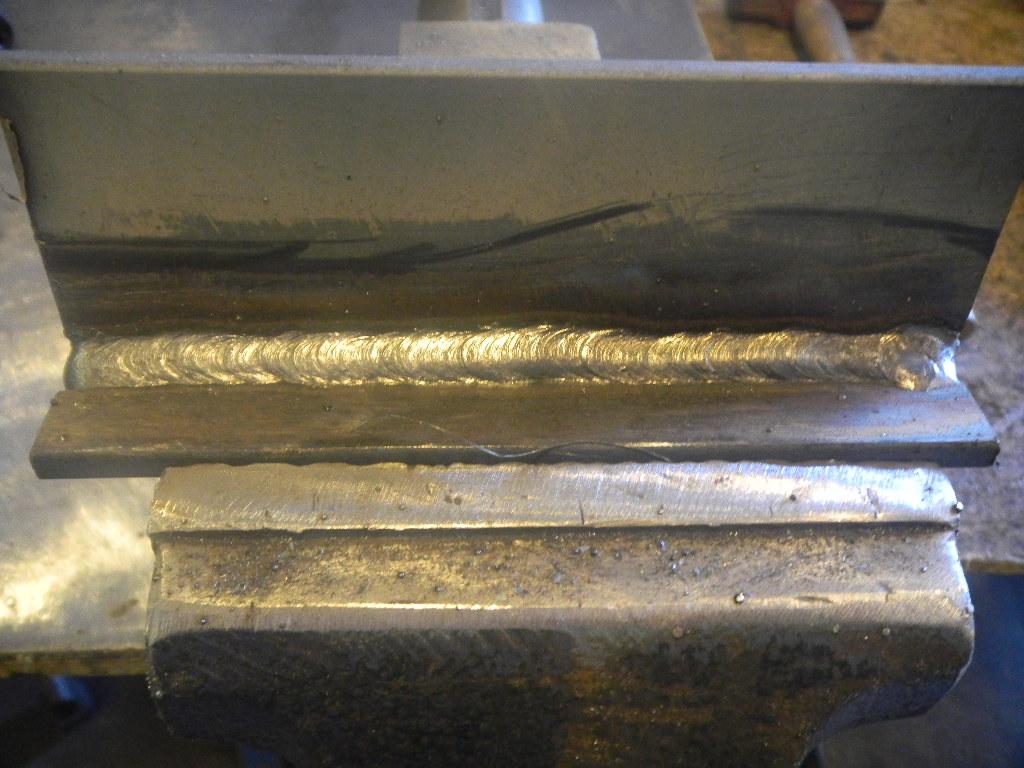

Fillet take 2: I went up about 10 Amps, and while not perfect (undercut and porosity at the start and overlap with the prior bead) it seems better. I didn't clean the slag well from the prior beads, so that may be part of the problem when I started a new bead...just have to revisit that. Thinking maybe I went up a little too much in heat, but I'm not sure. The undercut could have simply been me not pausing enough at the top of the zigzag, or the rod angle, right?

Sometimes you can get under cut with the improper rod angle.

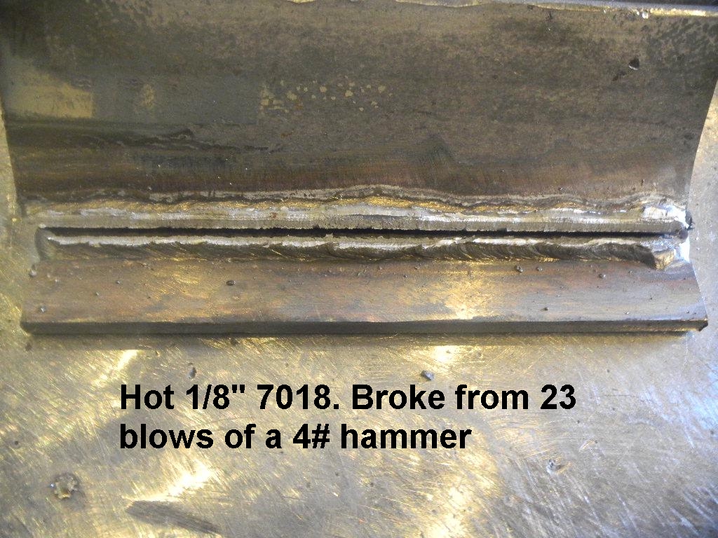

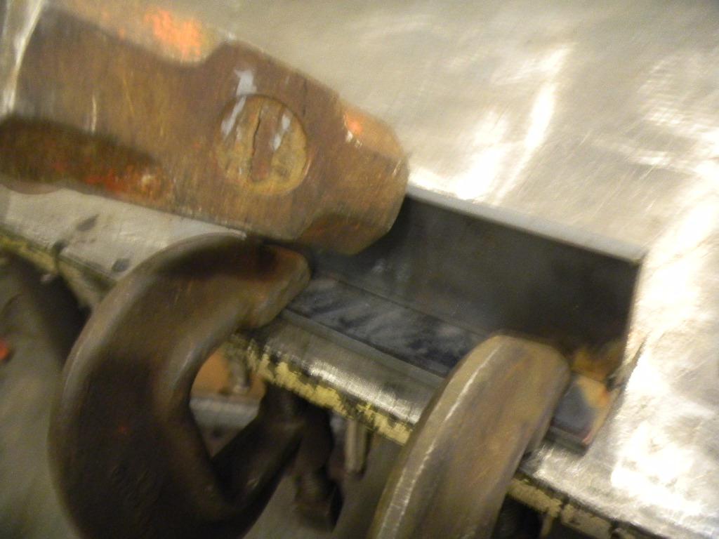

Here is a bead pad I did today. 1/8 7018 at 100 amps. image-4069344295.jpg Then I took a 7/16x3 bar and cut in half and mig welded it back together. Although it wasn't a proper bend test I was pretty happy.

It looks like you had the rod angled more to bottom plate and your heat may be just a touch hot for your current skill set. Could go a little slower to get nice round ripples in the bead. Pointed means a faster travel speed was used. It can be OK sometimes but the weld has to completely fill up to the proper size with no undercut. Try using a shorter arc length too.
That makes sense.
I thought I probably went up a touch too much on the heat, but didn't have another piece of this square tubing ready to try again. I'm pretty sure the rod angle was a bit too close to 45* as well and needed to be flatter.
