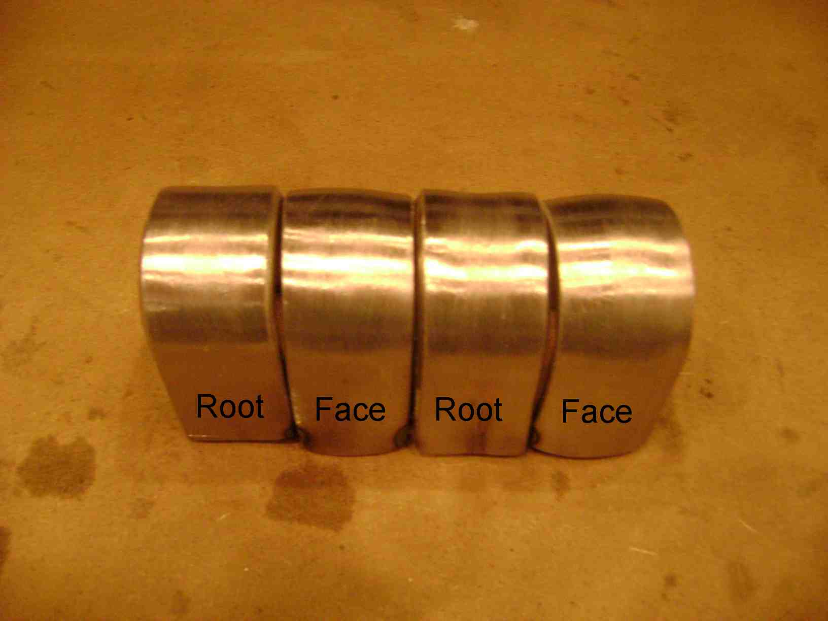

Normally after pad welding, students move onto lap joints, then fillet joints. After that it's V-butt welds, and bend testing.

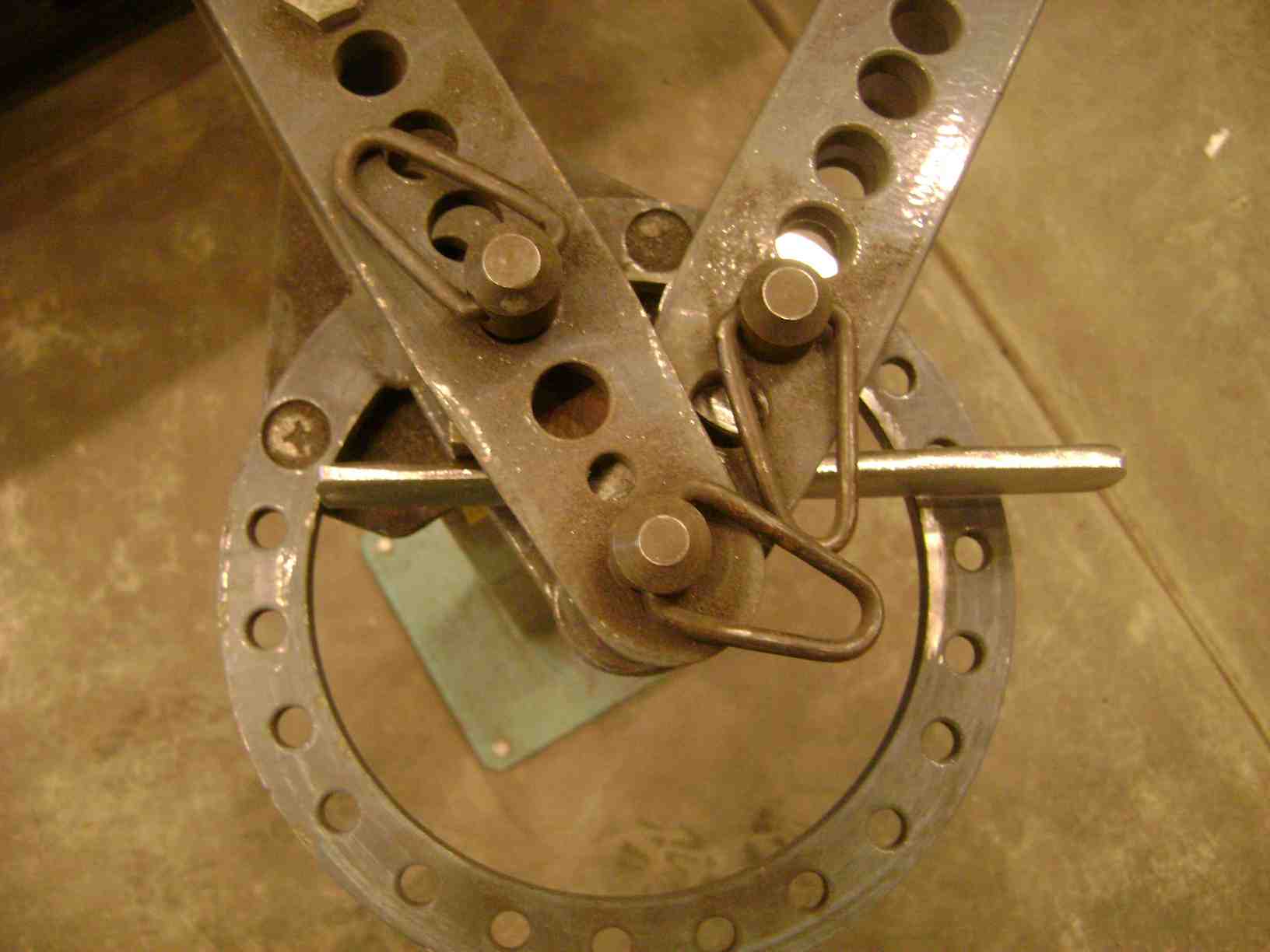

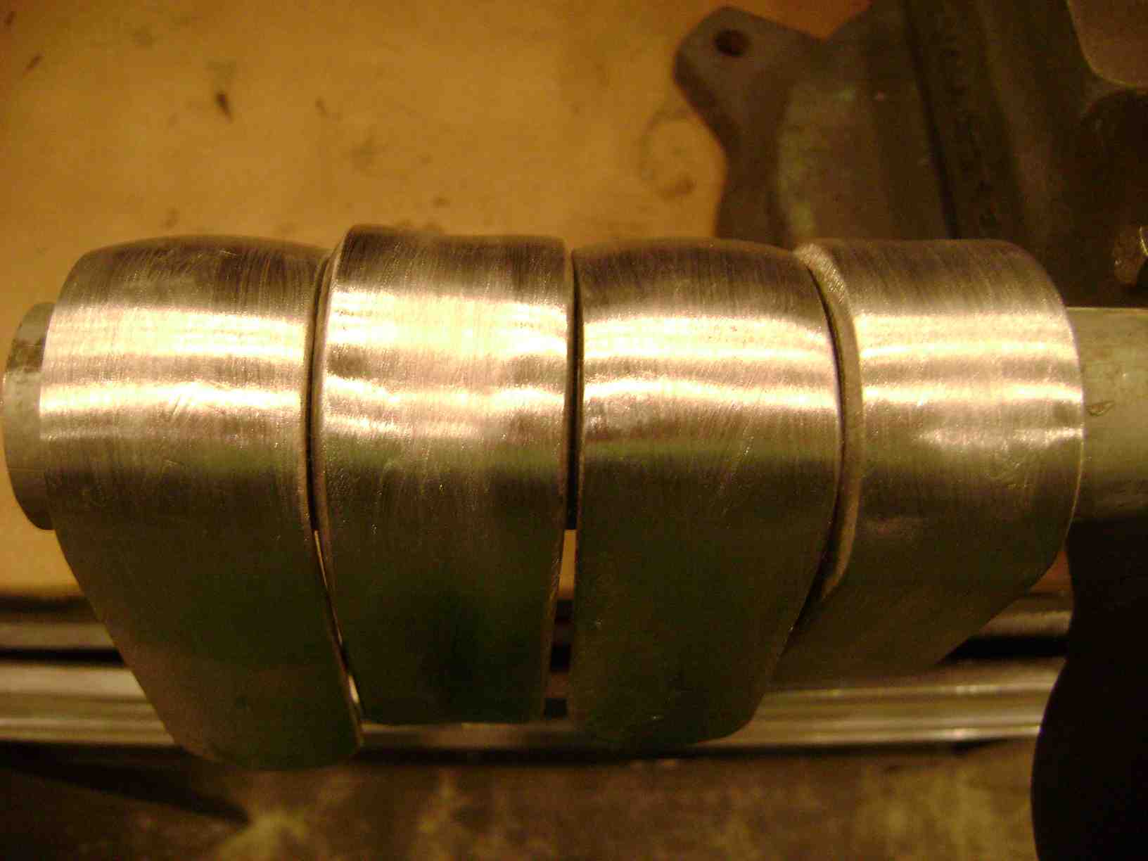

One of my welding projects is a vise stand that will help with bend testing soon :D
A compact bender from Harbor Freight will do the same thing. Just make sure you use the 1 1/2-inch round die to wrap the coupons around.
That's a great idea!
