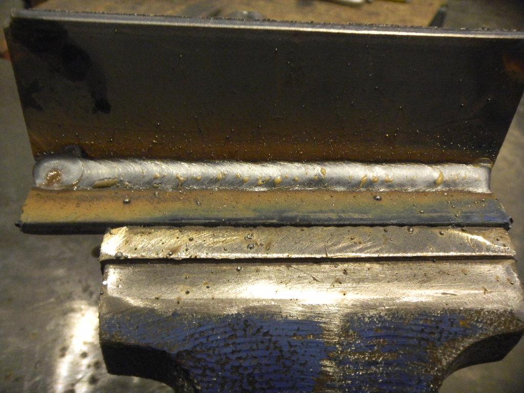

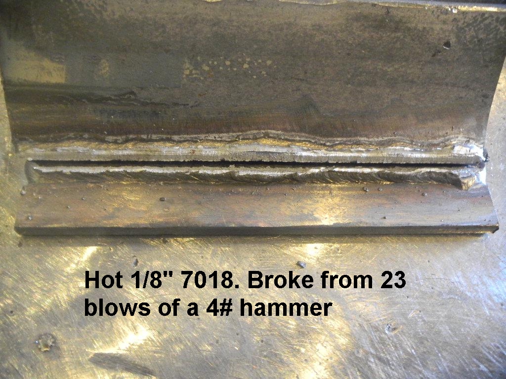

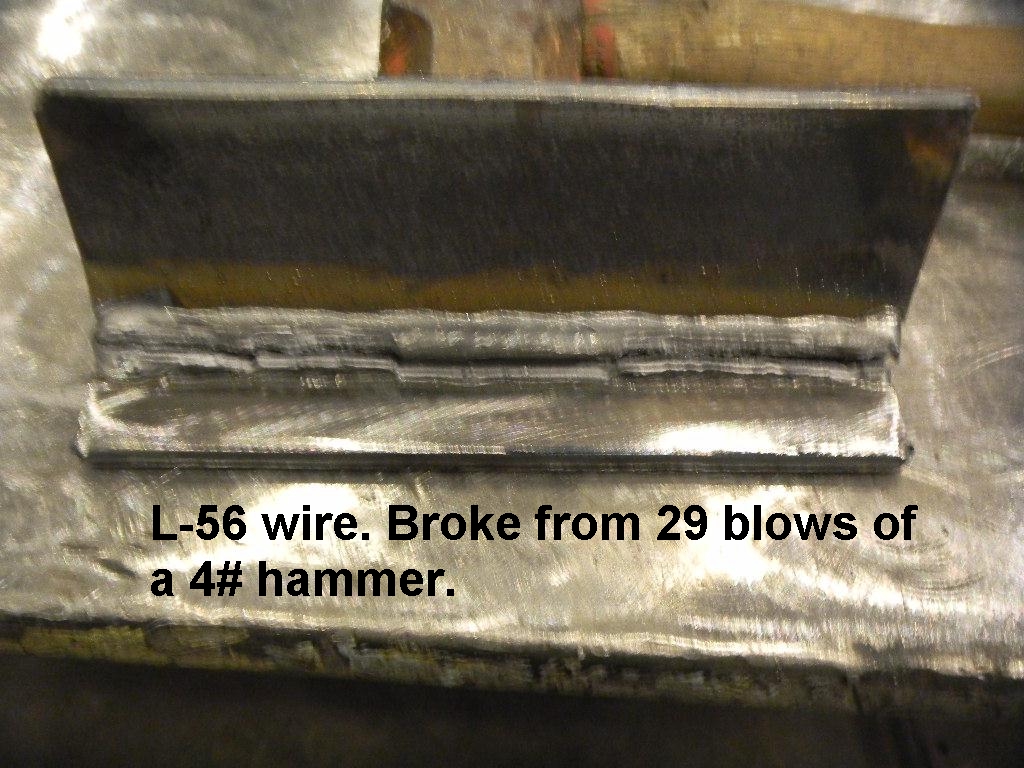

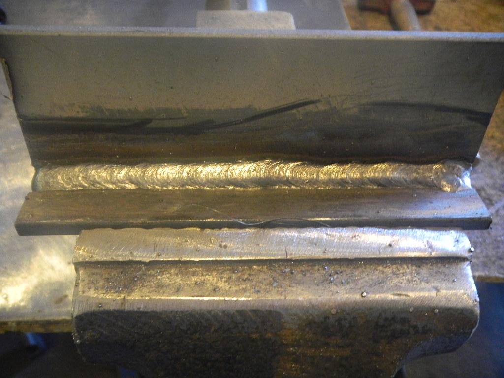

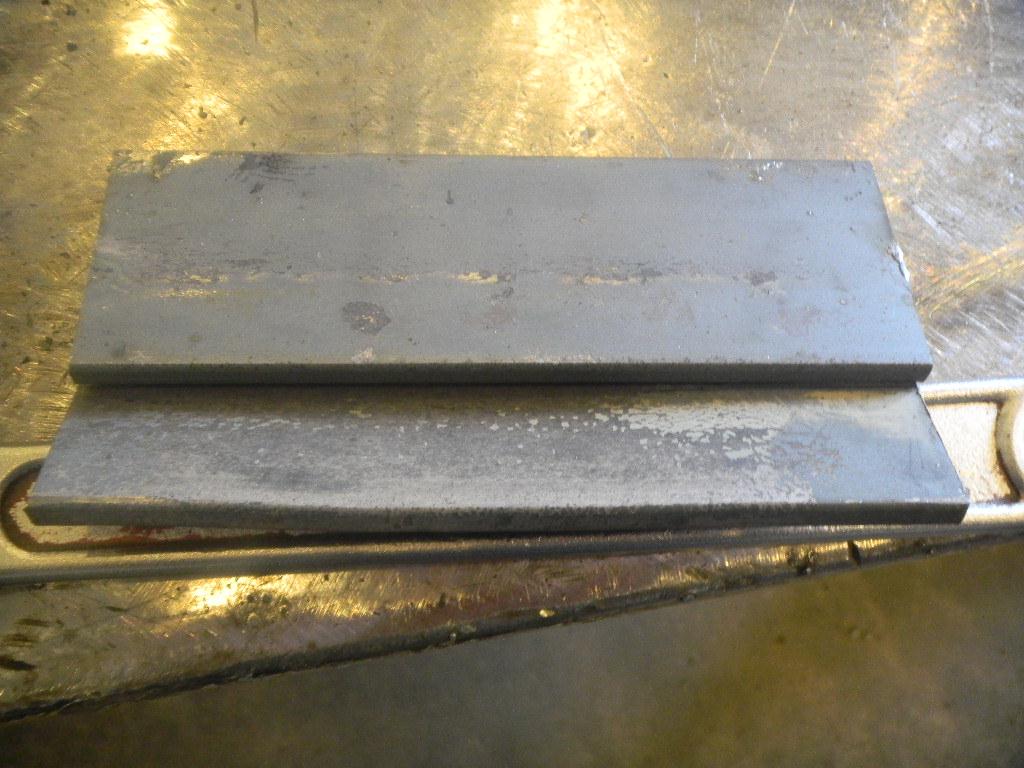

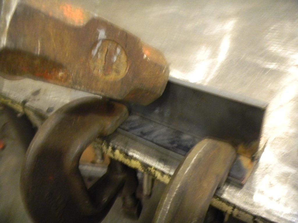

When you start doing fillet welds, you can clamp the plate down, and hit it with a hammer on the opposite side of the weld. Beat the top plate over the weld. 7018, and Lincoln's L-56 Mig wire, I beat the tops plates down onto the bottom plate, then had to beat the top plate back the other direction to break it off.
7018 that never seen the inside of a rod oven broke with 18-blows of a 4-pound hammer.
7018 right out of the rod oven broke with 23-blows of a 4-pound hammer.
L-56 Mig wire broke with 29-blows of a 4-pound hammer.
