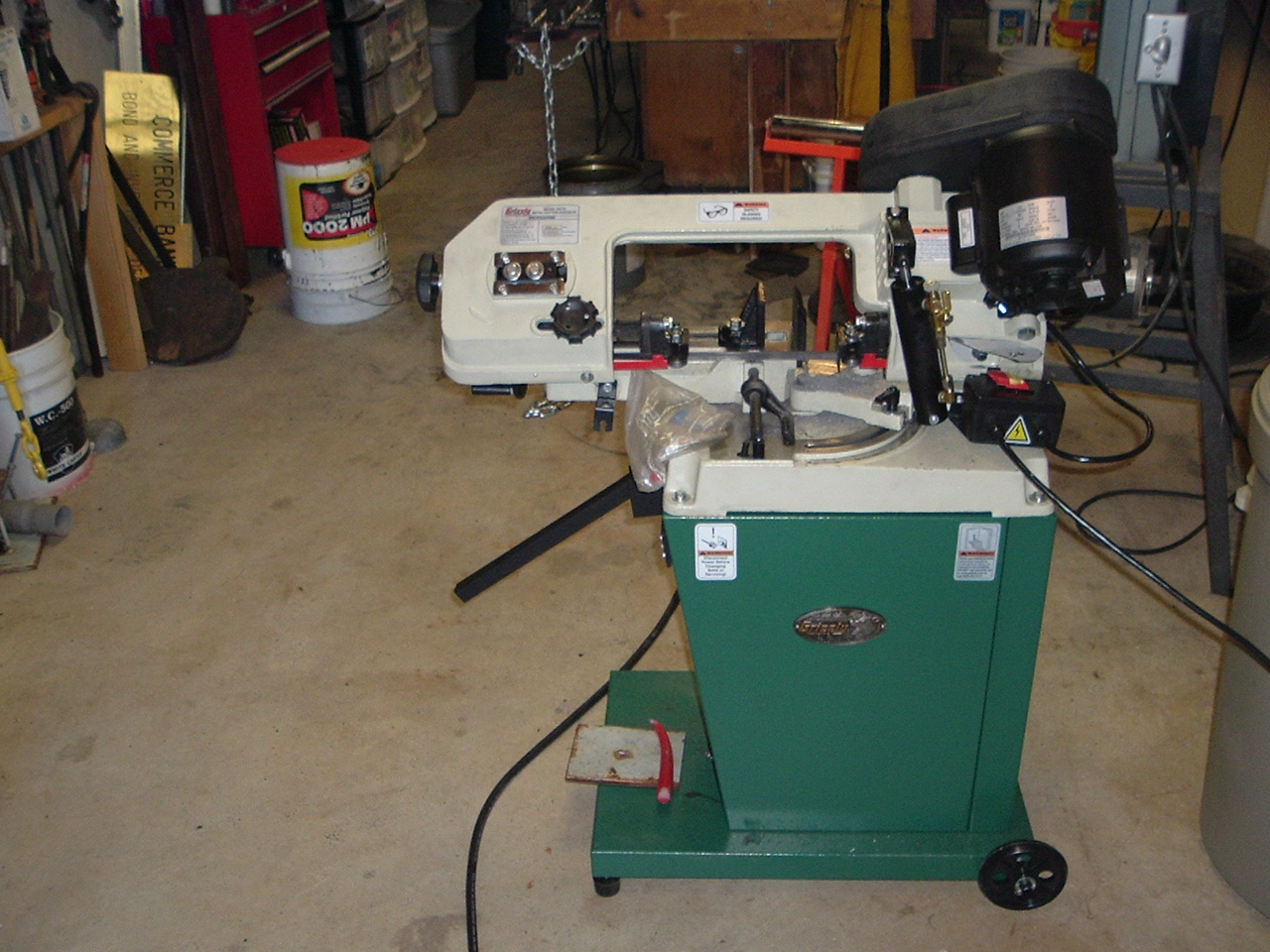

A bandsaw is really nice.. quieter, and no sparks.:)
That's the kind of bandsaw/cutoff saw I was talking about. I'm not sure why, but some folks seem to call horizontal bandsaws cutoff saws cutoff saws...maybe to differentiate between vertical bandsaws :confused:
Regardless, that's the kind I'm talking about. I went to an auction on Saturday because they had a clean Wells Model 8 listed with decent pictures....got there and the saw was nowhere to be found. All the other tools and machinery was there from the pictures, but not the bandsaw. :(
They seem to come up on Craigslist pretty regularly, so I'm checking that daily. This one came up last night...kind of a monster, at 10x16" cut, but would likely last forever:
MODEL 1 WELLS HORIZONTAL BANDSAW
/ Ugly beads, critics welcome... #104
Maybe diferent parts of the country have different names for it, but to me and around here a cutoff saw is a 14 inch circular abrasive saw. Lotsa noise and lotsa sparks. Works, but is considerably cheaper than a good horizontal bandsaw. They are often priced under $100 in some places.

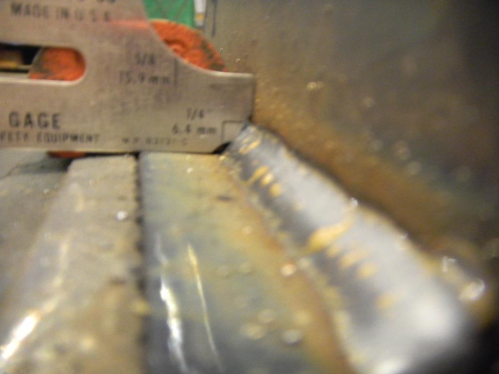

You may never do code welding work. If you ever do, you will need a set of these. Generally getting the proper leg length is not a problem. Getting the proper throat is the hard part.
I can't imagine ever doing code work, but I still want to try doing things the right way, so they may be handy to have.
/ Ugly beads, critics welcome... #115
When you do code work enough, you get to the point where you can make the size weld called out on the blue prints. It's like anything, you do enough of it, it becomes easy.
I've been on jobs where the welding inspectors would reject a weld for being 1/64" to small!:rolleyes:
