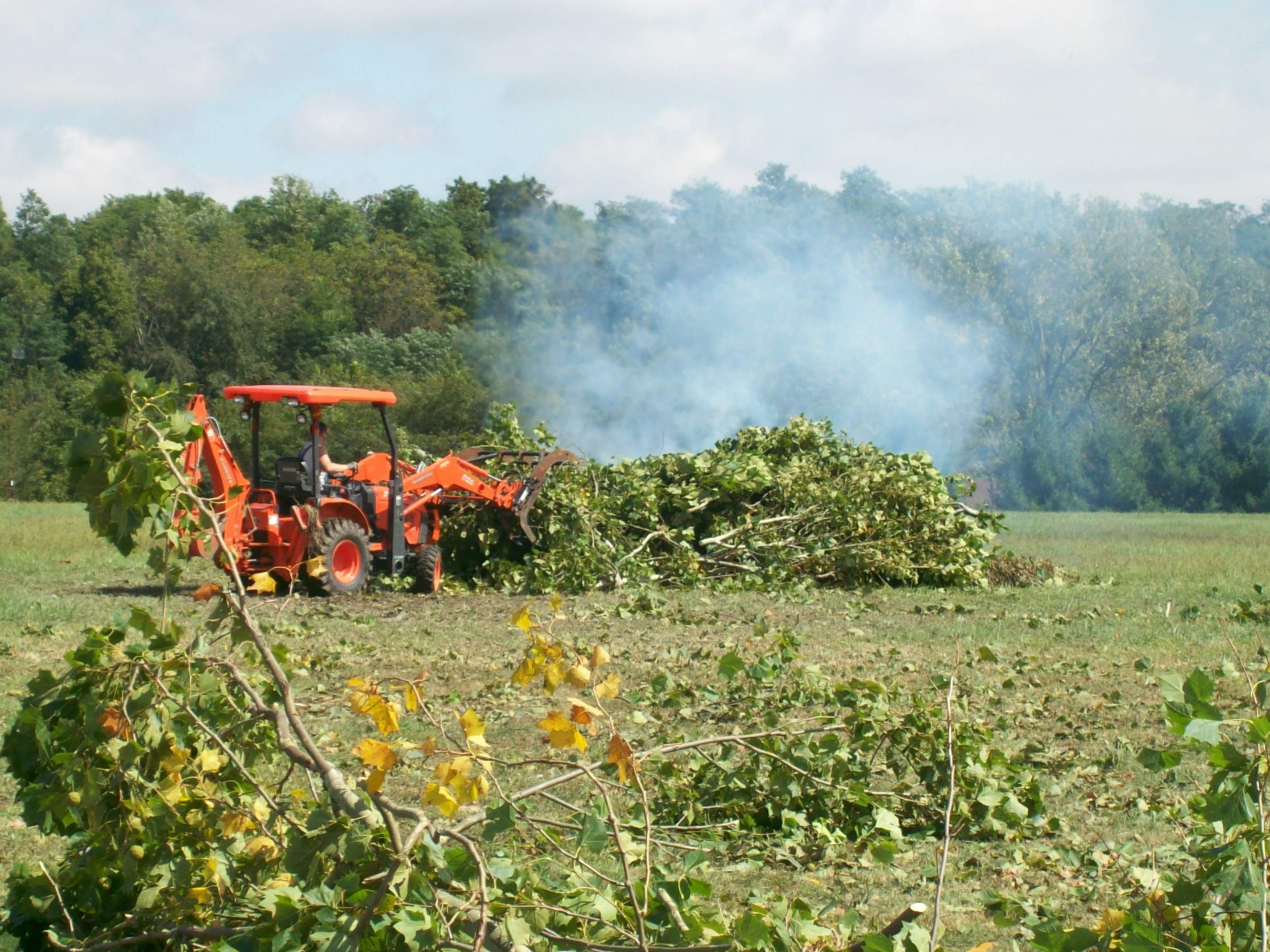

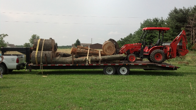

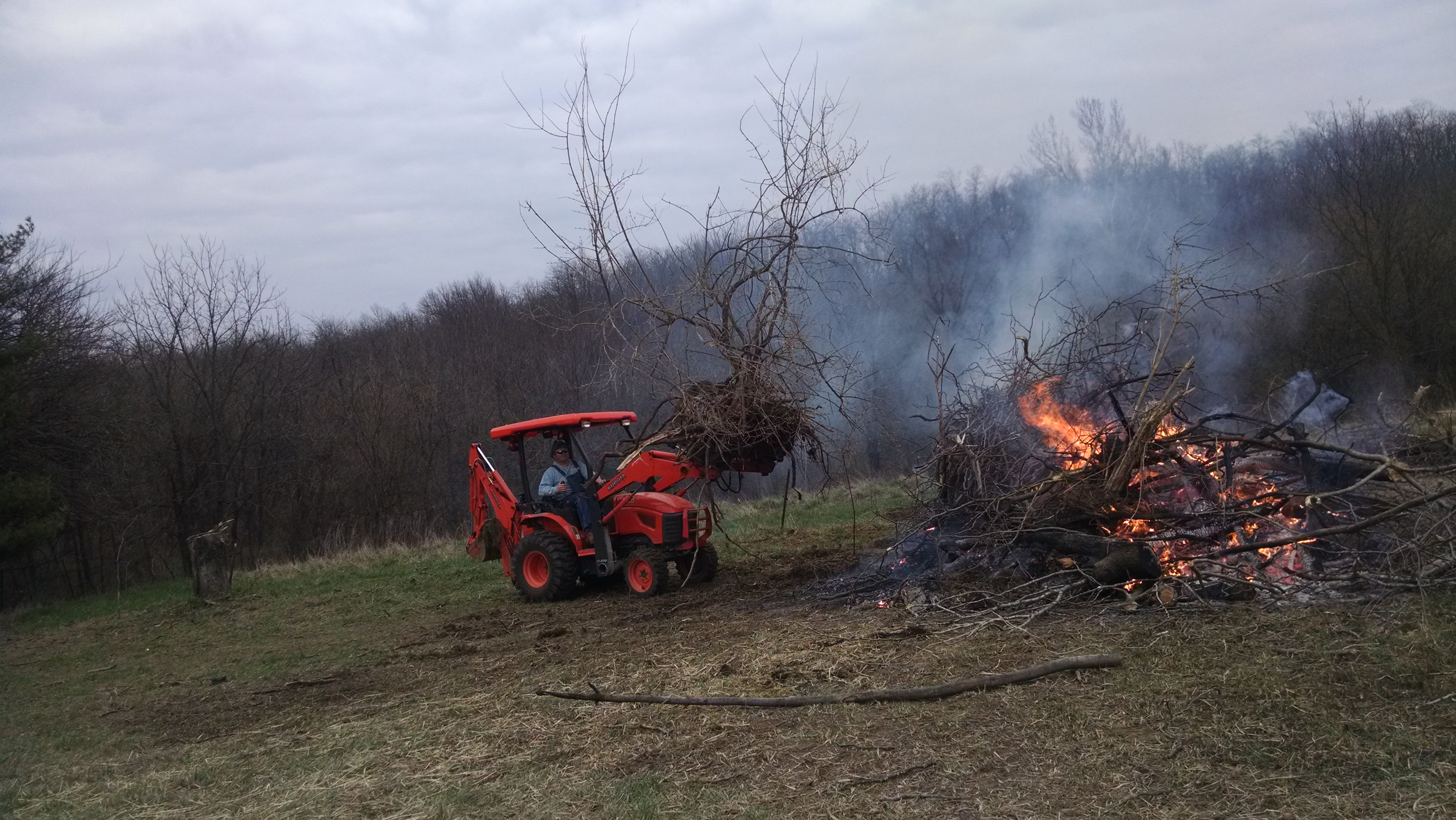

xfaxman how do you like the telehandler and did it work good with the shear? I was thinging that it would speed cutting around fields and still be able to handle hay bales and a hay accumulator?
Someone mentioned using a shear with a grabber on it and I don't want that as it don't take much of a tree to push a excavator around little own a tractor. Below is some stuff I have cleaned up after storms and saved for lumber my favorite clean up tool is the b26tlb and grapple.

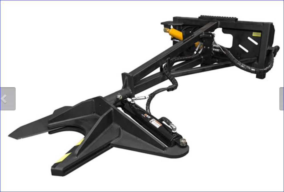

That old cedar tree cutter isn't made now, but you might look at this style: Tree Shears - Long Reach Tree Shear - XLR12UN | Sidney Attachments
And: "Commercial" Skid Steer Mount - Precision Manufacturing

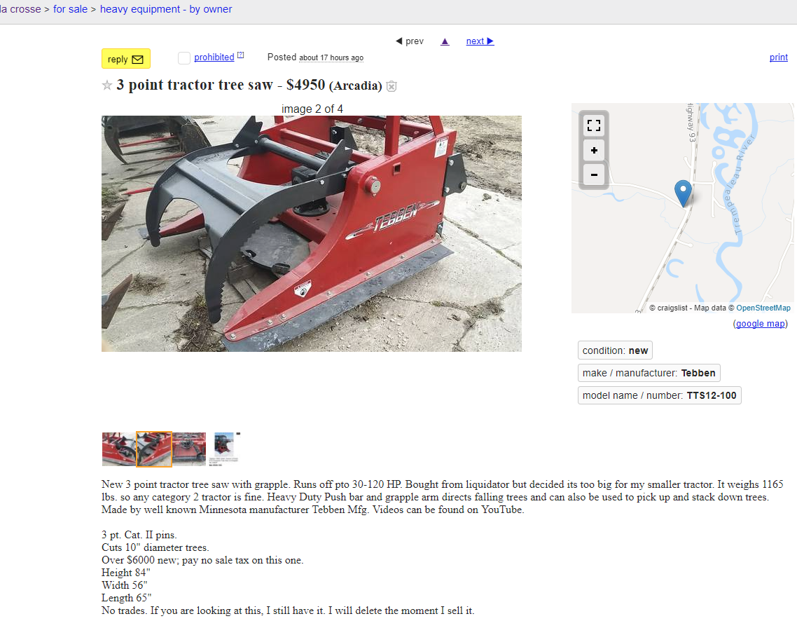

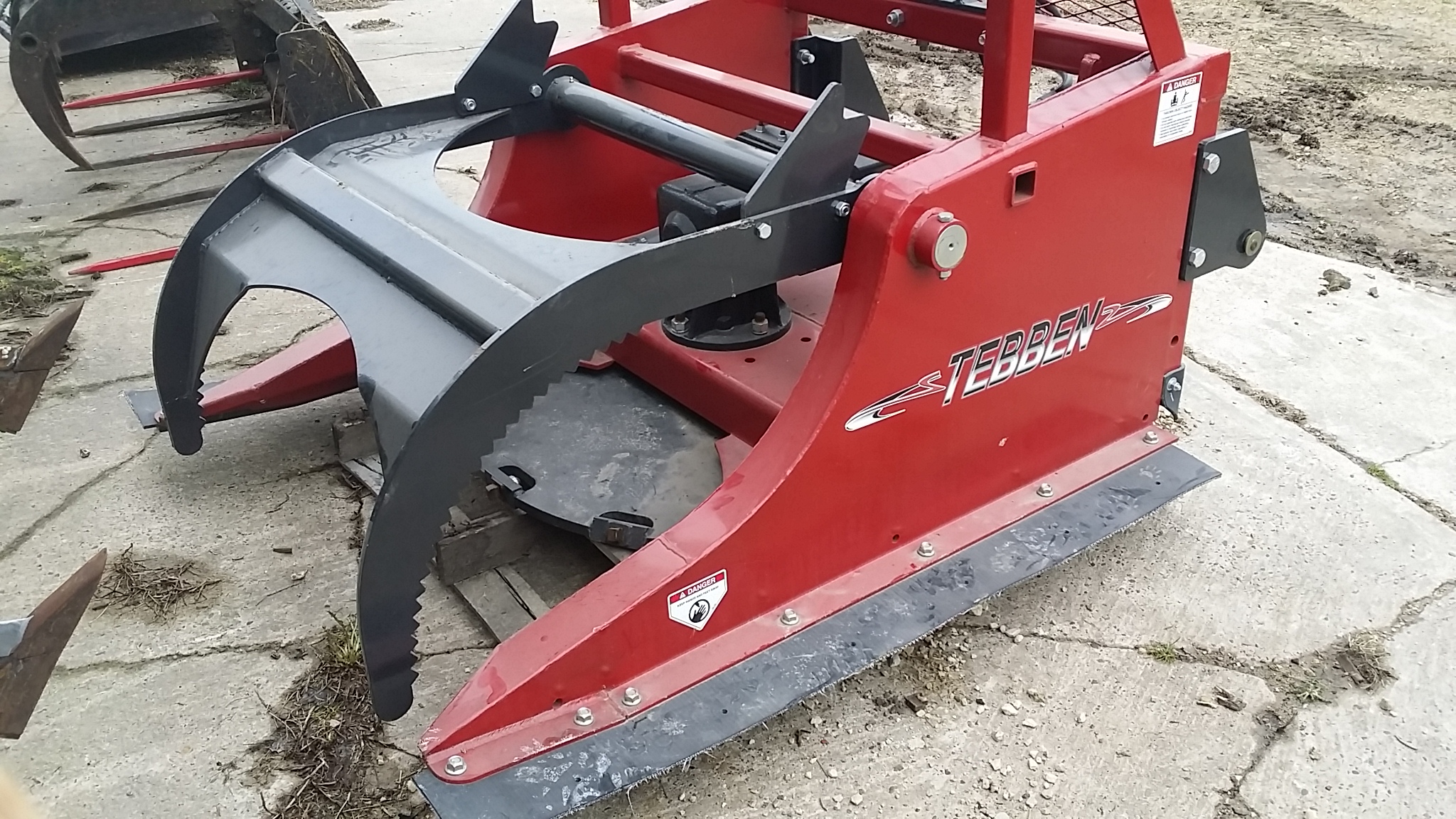

Not sure if you moved on something yet but the pto driven tree saw will remove a lot more tree(s) in a shorter period of time. Cuts clean to the ground. PTO version on a tractor has zero loss of power. Private party selling one cheap on craigslist in Arcadia, WI.2017Dec Craigs.PNG20170420_154356.jpg.
