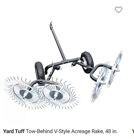

Anything that will move a significant amount of sticks as described is going to be a bit rough on turf, especially if it uses straight tines or wide stiff ones. If it isn’t a highlight area of your yard, a dethatcher would move most of it, or at least help you pile it up for gathering into something to haul it with, and wouldn’t destroy the turf with a few passes. But the turf is only going to tolerate so much abuse. An old style horse drawn McCormick hay rake (towed by the BX) would be the cat’s pajamas because it’s designed to lift hay from the stubble and windrows perpendicular to the line of travel. It would require a second person to operate the rake, but Ive ridden on many miles and would swear by it. Still doesn’t solve the problem of actually picking up the sticks and loading them for disposal, but would likely capture anything over 12 inches long and drop it in very neat piles. Unfortunately, most of the ones I see these days are yard ornaments for country folk wannabes.

The same goes for any pine or landscape rake. A stiffened pine rake might work, but the best option I’ve found is picking up the bigger limbs by hand, then using a Stihl backpack blower BR800 C-E Magnum to move all of the other limbs up next to the trees.

For the price of some of these suggestions, you could buy a rotory cutter and just beat the limbs to death until they are small enough for your bagger or a lawn sweeper to pick up. That’s not to say they are bad ideas, they just might not necessarily work for your specific situation is all.
