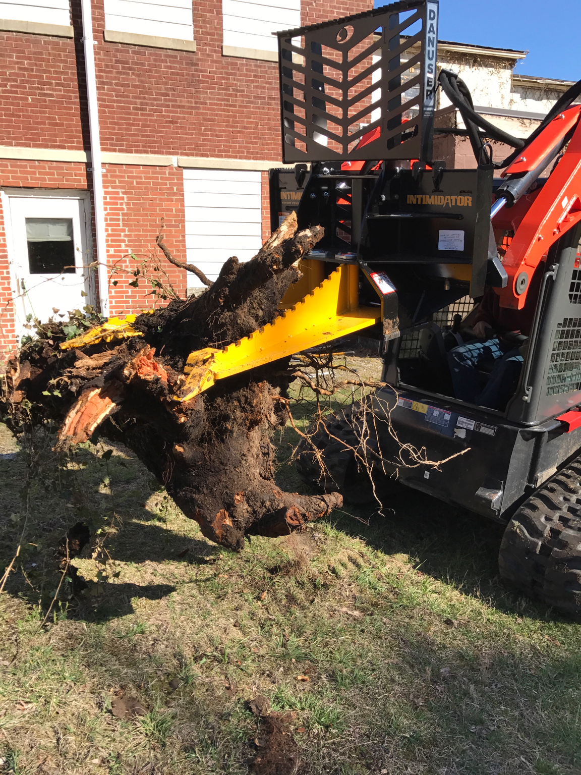

I like the idea of a tree puller or tree shear, but every time I've found that pushing the trees over and carrying them away with the grapple seems to work about as good as anything. I'd like to try a puller though, just, well, because I think it would be fun. I would only use it on a 3 point hitch though. Seems to me that having a grapple on the front, and shear/puller on the rear, would be a very nice setup. With just a tree shear on the front, you can't grapple and carry numerous trees that you've just pulled. I just don't see the advantage there?

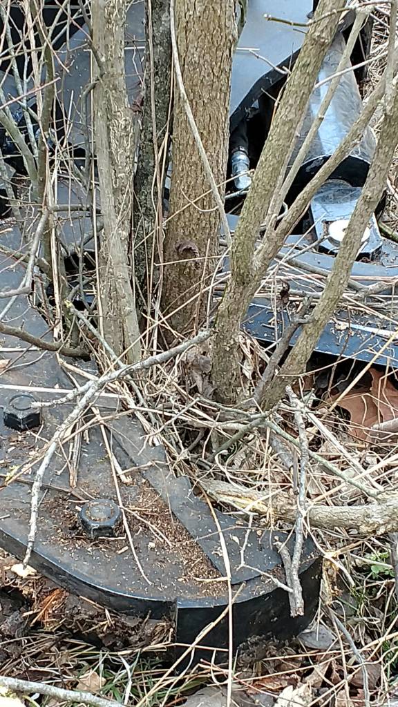

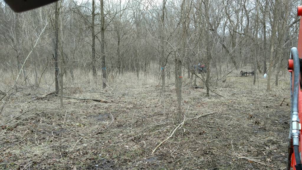

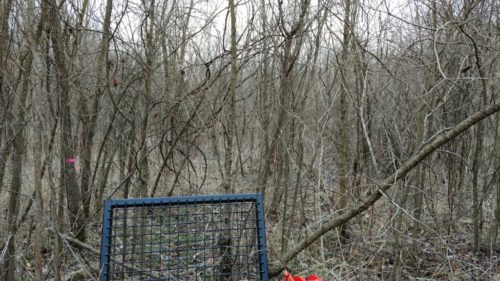

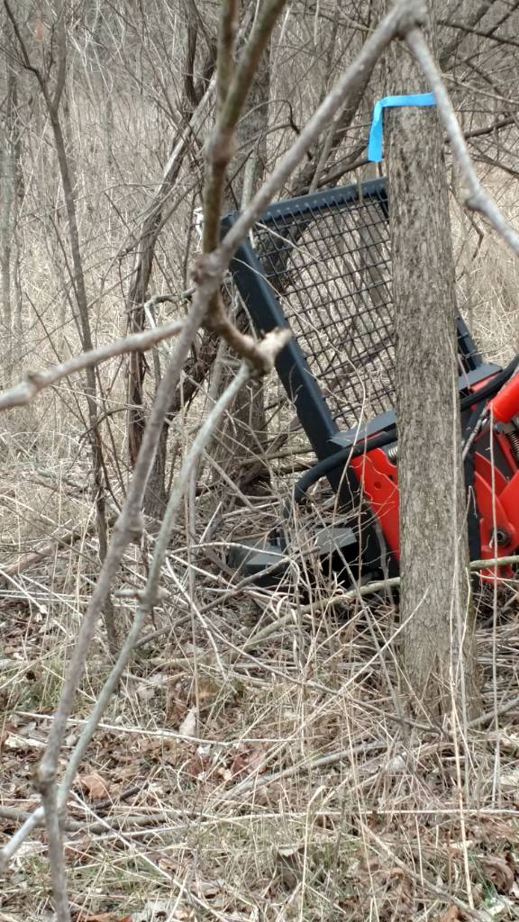

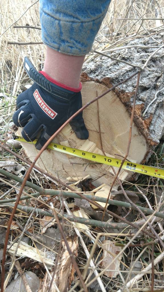

I got to use the tree shear today and I found it works great on my B26TLB Kubota as it handles the frozen ground with a little slime on it very well and it was able to move in and out of the trees I wanted save. With 7gpm to my loader 3 valve and about 2300 psi I was very impressed about 3-5 seconds to cut a larger tree and no way to tear it up with this machine.
Largest tree I could get it around was about 14" cottonwood and took and extra bite to get it but it did it. On the larger tree's I would cut them several times to make it easier to remove them with my grapple. On small groups of trees I could cut 3 or 4 at once. I attached a few photos but have not figured out how to do video. IMG_20180120_132025714.jpgIMG_20180120_115717548.jpgIMG_20180120_115721436.jpgIMG_20180120_104918830_BURST001.jpgIMG_20180120_110646158.jpg

Glad it works good for you:thumbsup:
/ Tree shear #69
Looks like a sizeable project!!!! Glad it's working well.

Has to be selectively cut we planted them in rows 15-20 yrs ago and didn't keep up and keep cottonwood from coming in. We looked at using a mulching head but don't have a high flow machine. We have a really heavy landpride brush mower but most of this is larger than it wanted to handle.

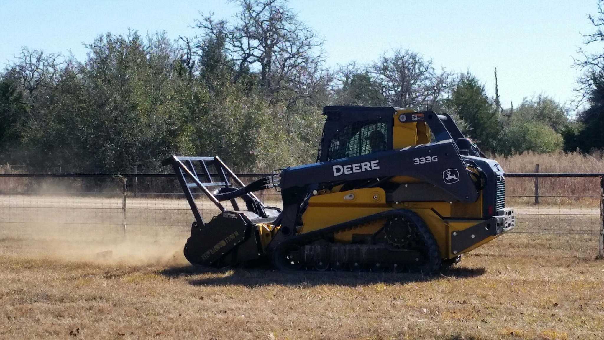

Good to have a neighbor with a mulching head. 5 stumps in 15 minutes.

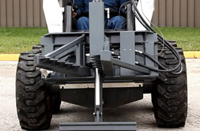

Good question, and I have what I would use as a method to reduce the change up from horizontal cut to vertical. Figure out what you need to drop, then what you need to piece out in sections. Then do as much dropping as needed, then switch to slice and dice. May not always be practical, but minimizing switching positions will save a lot of effort. It can be done without a huge amount of effort, but realize you're rotating the better part of a 1000# tool on a shaft with no assistance from anything but your own brawn. So the fewer times you rotate the shear, the better for conserving your energy.
Here is a rotating shear, found with a simple Google search; don't know anything about it, but here is the link. I suspect it's expensive, because of what it can do, and from what I can see most of the really heavy duty stuff is best suited, IMHO, for skidsteers due to their higher capacity hydraulic systems and increased flow at the implement: Tree Shears Attachments for Skid Steers, Loaders and Tractors
