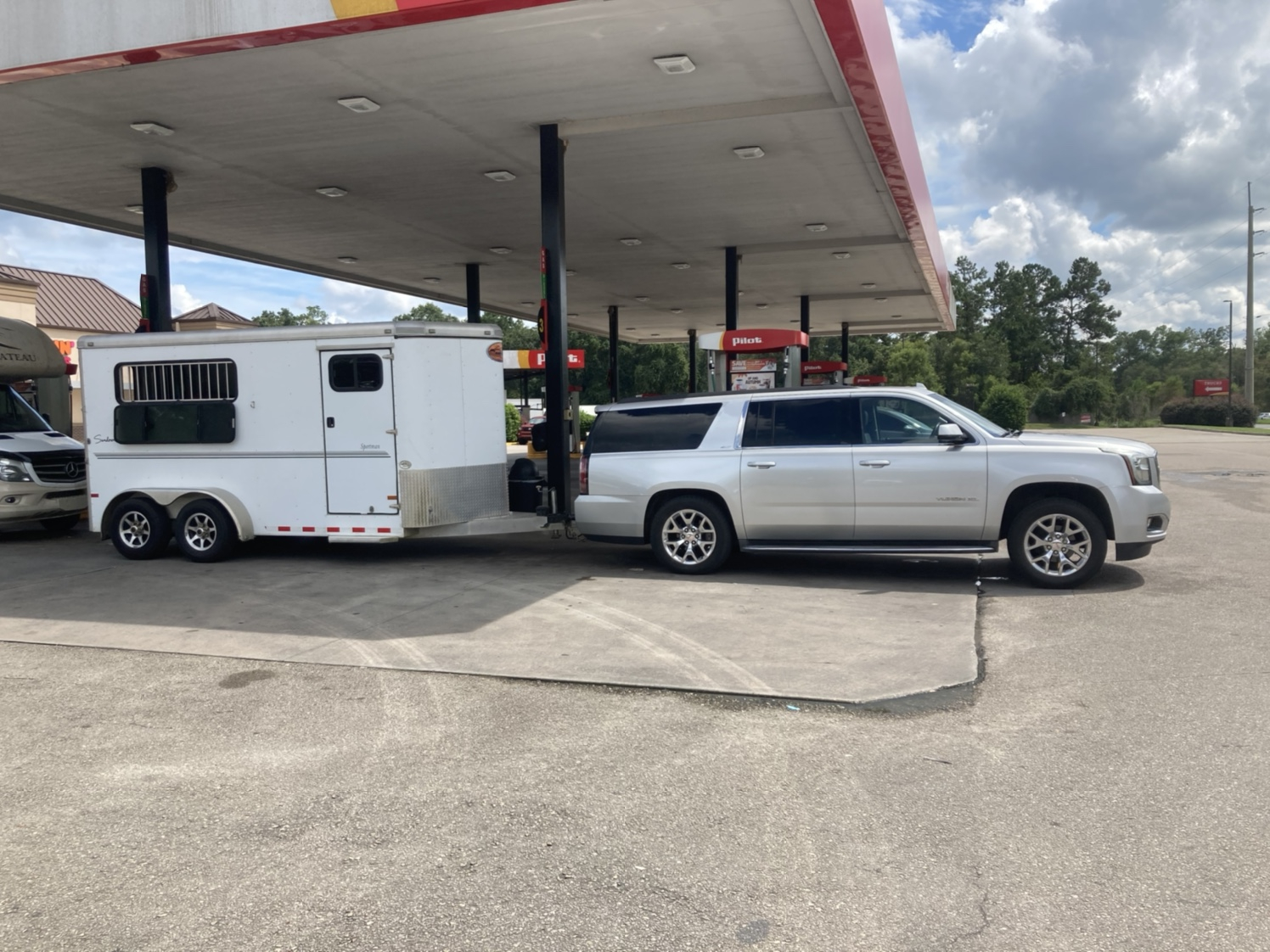

See attached picture. This is a 3 horse trailer with one horse loaded in the front, one in the middle, last slot empty. The vehicle sag is exaggerated some as we were sitting in a slight swale. We may only bring one horse home. In your opinion, what is best way to load? Center stall over axles? All the way forward or rear? I have heard a lot of different opinions, but you guys always come through. With 2 horses-one to the front and one in the middle? Thanks in advance!

First question: how well do the horses get along?
Two horses having a pseudo-shoving match is no good. If they get along, putting them side-by-side is usually comforting, to them and they will ride better.
Second question: How heavy are each if they horses?
In general, too much tongue weight is safer than too little tongue weight. It looks like you have too much tongue weight, based on the rear sag, but the hill is making that worse.
It looks like you would have even better options, if you used a weight-distributing hitch.

That’s not a lot of weight, either way. If you didn’t like the way it rode with both in front, try both in the back two stalls. That’s one great thing about smaller horses. I would guess it would ride best with one in the front most stall and the other in the rear most stall, but I doubt any setup makes a drastic difference.

I would put them at the back in the center and rear stalls over the axles. The weight of the trailer alone, with the axles so far back, should give you the tongue weight you need, 10%-15% of trailer weight. Our Warmbloods weigh 1400#-1500# so which stall they are in makes a difference. Also consider the weight of the tack in the tackroom. If your trailer has the collapsible tackroom in the rear putting the saddles back there can put some weight at the back.
The trailer looks pretty level. Because the Sundowner bumper pull hitch is not that far off the ground, you may consider a drop for the receiver hitch to help level out the tow vehicle. I like a slight nose up for the trailer which would also help.

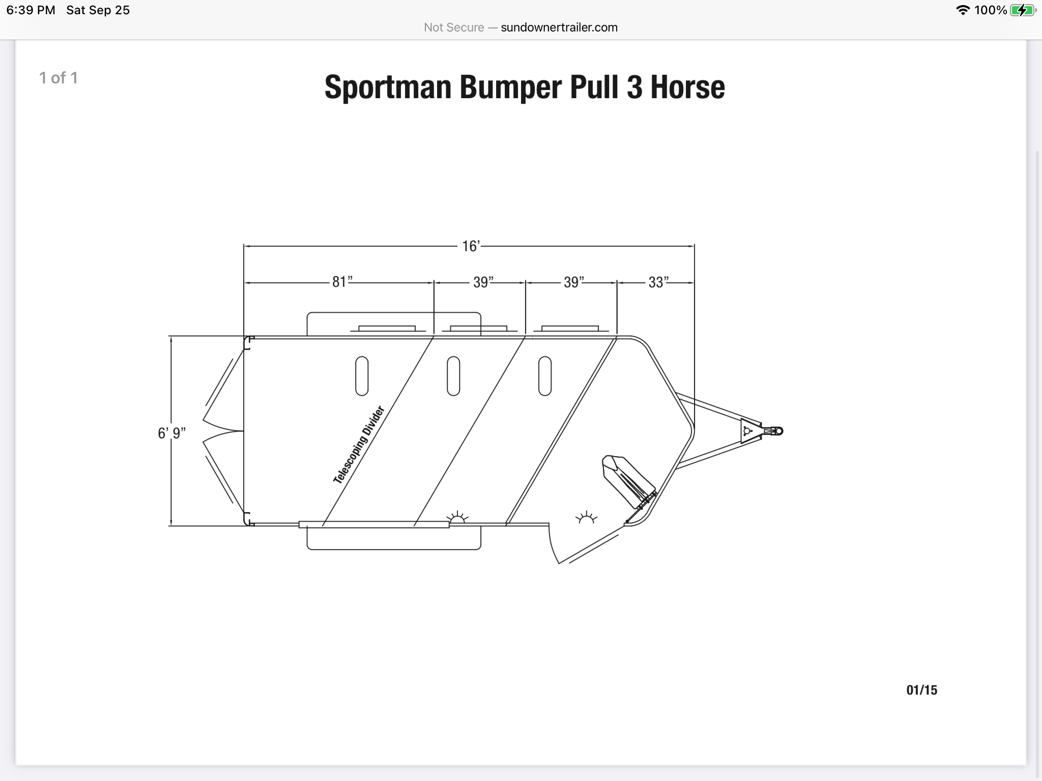

It looks like you might be able to keep most weight over the axles and slightly aft if you don't use stall 1. Also, I know a weight distributing hitch is not made to deal with resolving tongue weigh issues, but it is made to transfer tongue weight to the front axle. And it is a some trouble each time you hook up.

A weight-distributing hitch would be good to have, for this setup, in my opinion.

Your earlier post with the drawing helped a LOT. It gave a better idea of where the stall weight is compared to the axles. The first picture made me think most of the stall weight was forward of the axles.Thank You

Here is how I would load that trailer, as long as there wasn’t a bunch of heavy tack. If the tack added to a lot of weight, I would consider switching the lightest and middleweight.

The tow rating of the pictured vehicle is 8300lbs.
/ Trailering Advice Needed #19
Key words “up to”. Just because that series vehicle might have been offered like that doesn’t mean yours is.
