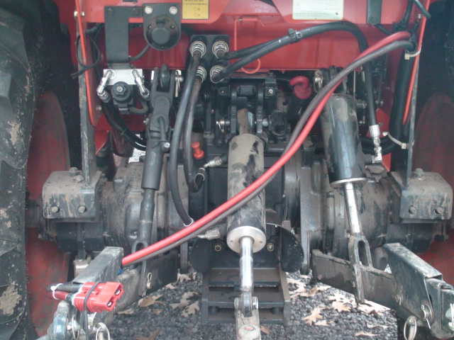

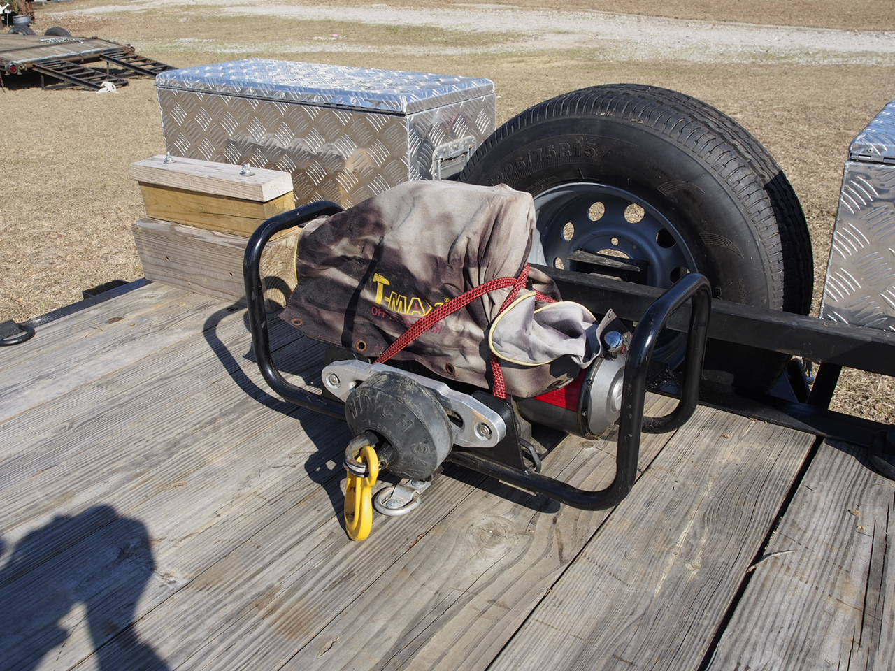

/ Trailer Winch Wiring #70
Here is my setup. All of my standard jumper cables are 1 gauge CCA or solid copper 25' in length, with Anderson type QDs on both ends. My truck and Jeep batteries also have mating QDs and winches mounted. And the jumper cable alligator jaws also have QDs. Very flexible setups.
My 20+2 equipment trailer has a 9k# winch in a portable mount. The winch was used recently used to pull an old Ford tractor with low/flat tires that had been sitting in a field for quite awhile. Lots of physical resistance that really tested the 9k# winch setup. Less capable winches would be okay for ideal situations with a rolling load on a hard surface.
I welded a truck step bumper 2" 5000# receiver to the trailer's front structural assembly. I would not consider using less than 2 gauge battery cable and 0 gauge would be better as the available voltage drops the longer the cable is due to wire resistance. And for the most part, the larger the cable diameter the less resistance to current flow.
Added photos of tractor/winch setup. All the same wiring principle.
i just finished doing something similar.... i've never thought i/of doing it the way the OP did (and now it won't work with my tube on the car trailer). as for wiring i have an extra battery that i use and if i need more juice i have a set of long heavy duty jumper cables I can run to the truck battery
