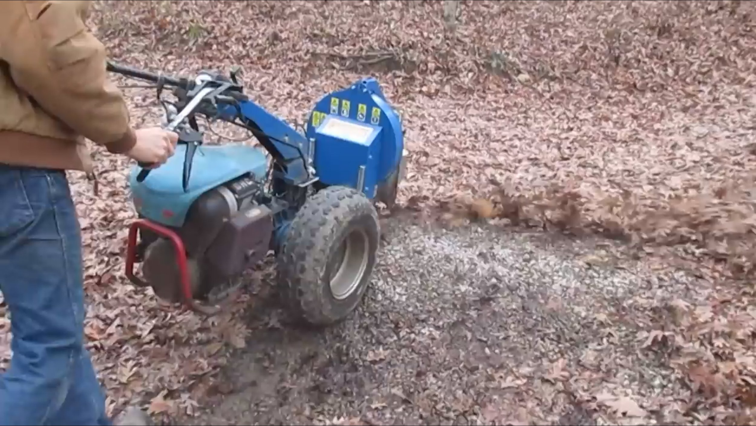

When timber was cut in 2018,, this trail was cut to access some large poplars,,
I did not use it since then, because of some large trees left across the trail,,
I did not have the right equipment to move the trees.
i now have a grapple, so I moved the trees, then,, I used the Gravely to clear the one inch and under trees that had popped up.
The Gravely went through the small trees almost like mowing grass. :love:

The problem with horizontal type mower is the 3" high* stumps they leave. Folks trip on them or poke a hole in a machines tire.
* some height. The three-point mower i used last summer left 6" ones.
/ trail clearing technique and tools #1,220
After the 2nd or 3rd year of mowing those mini stumps are gone and it's just grass.
Mowed through the middle of 8' brush with a 15hp Shibaura. Pure grass after 2 years - no stubs.
