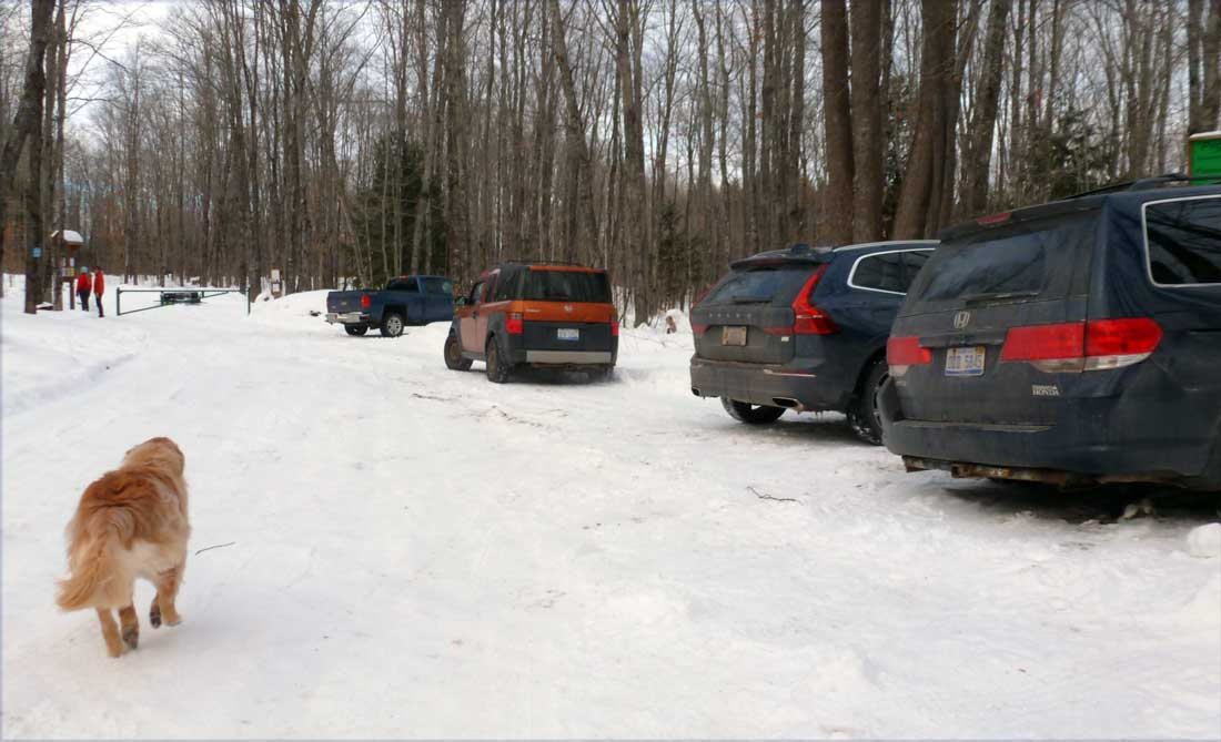

Grants are announced on the 15th of this month. We asked $$ for a mower, snow plowing, general operational costs and making the parking lot, into a real one. Here's what it looked like last spring. Might get all the $$, none, or some part of it. If we don't get any, we might not be grooming this winter. A&S can not not pay for it all again..... :(

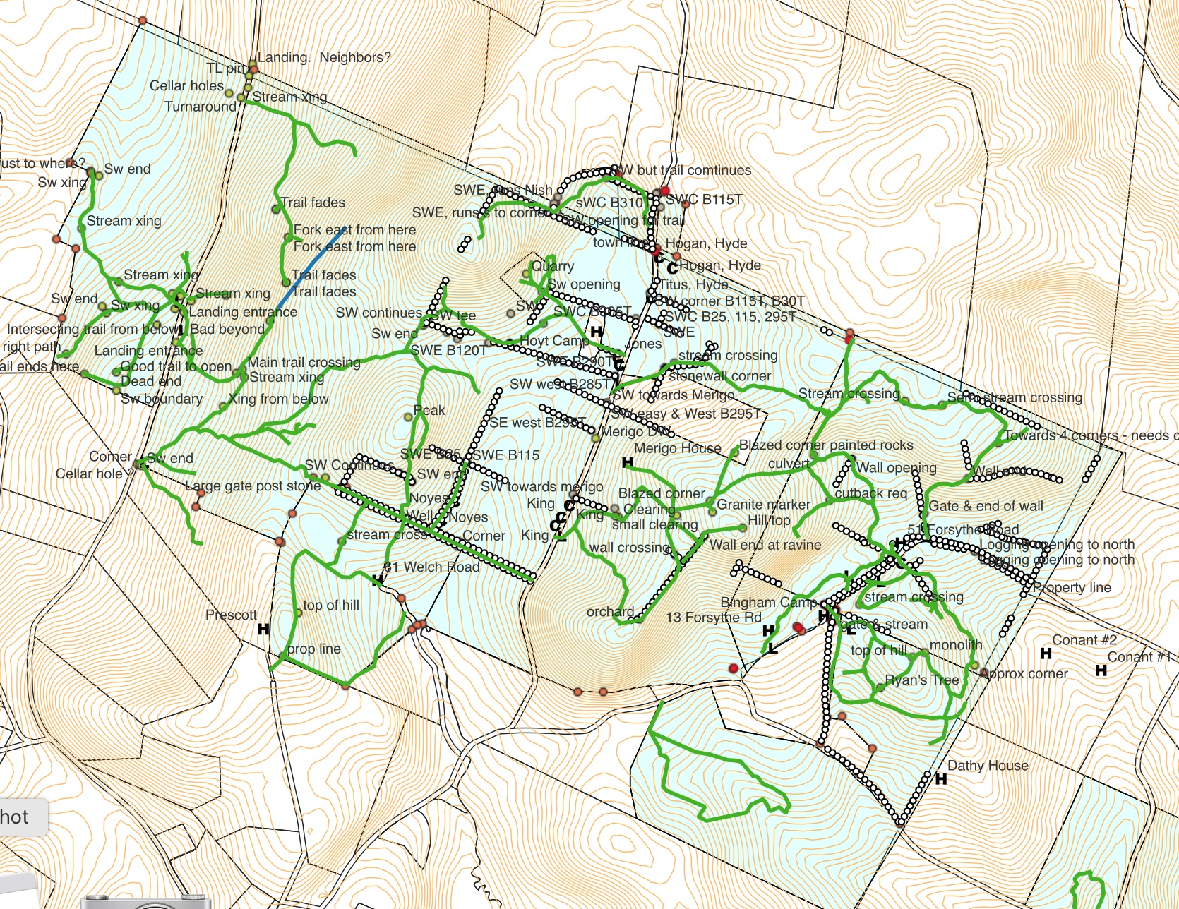

I've been using Gaia as well, and have historically been doing my map work in ArcGIS. But recently I switched to QGIS for mapping which I really like. I haven't tried it yet, but it's available to run on an iPad so my goal is to get map creation and field work all on a single platform. So far that has been elusive, but I'm optimistic that I am close to getting there.
Here's an example map with top lines. I can also overlay on sat photos, etc.
