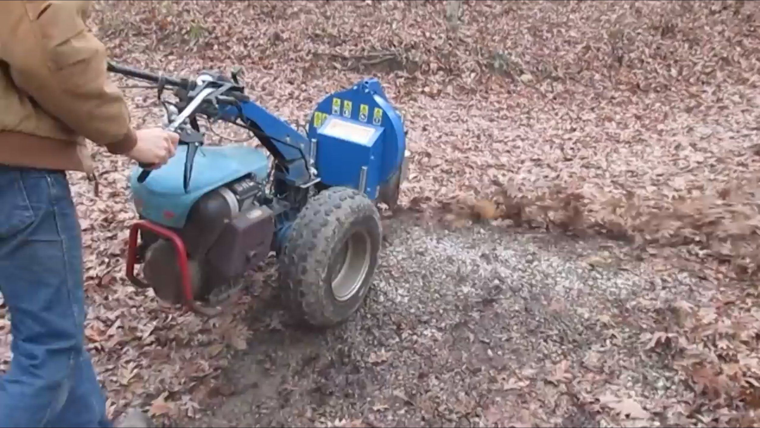

Handlebars? Caravaggi makes a leaf blower attachment for the walk behind like my BCS that retails for a little over $1,000. Not as powerful as the highest power Stihl backpack, but a respectable 1300 CFM, 175 MPH, plus not having to carry it!
screen grab from Earth Tools video…
But it wouldn't fit in the back our our truck or 6x6. The stihl backpack is quite easy to wear and use. Not to mention, blows like a rocket launch.

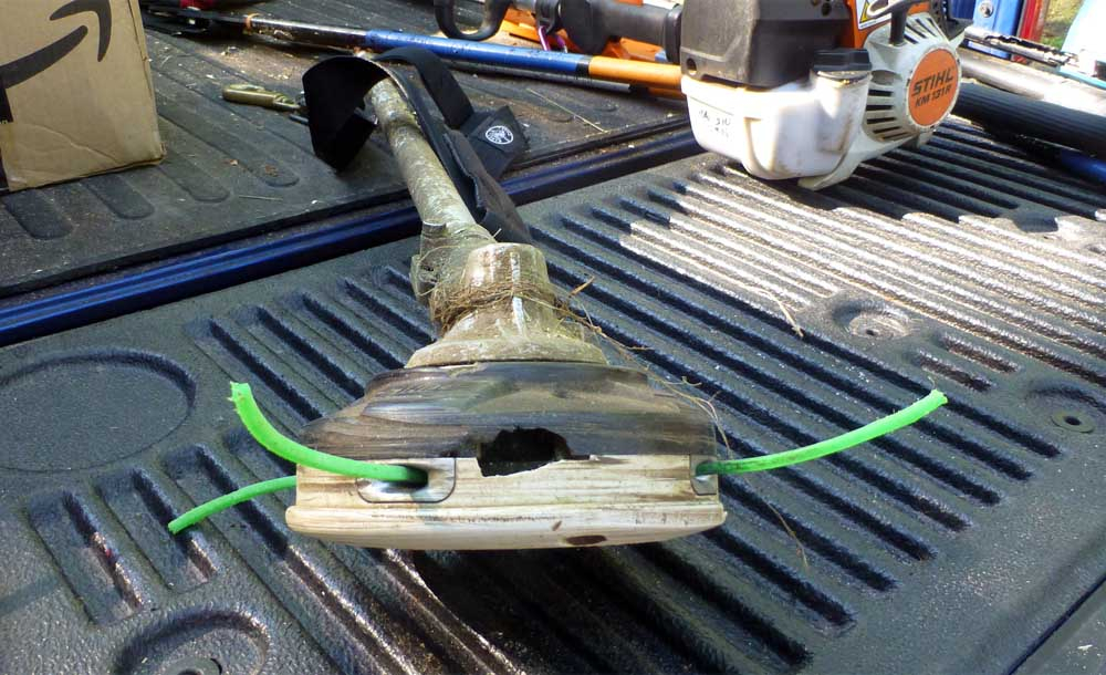

I don't have its number since we get them from our dealership. Having said that, they may be off the market until they change its plastic cover. We broke ours twice and my dealer seemed to know about this issue. If this helps, as far as I know, they only make one cam lock type head.

I don't have its number since we get them from our dealership. Having said that, they may be off the market until they change its plastic cover. We broke ours twice and my dealer seemed to know about this issue. View attachment 770400
My dealer can't seem to find them, they only have the 2 string version.

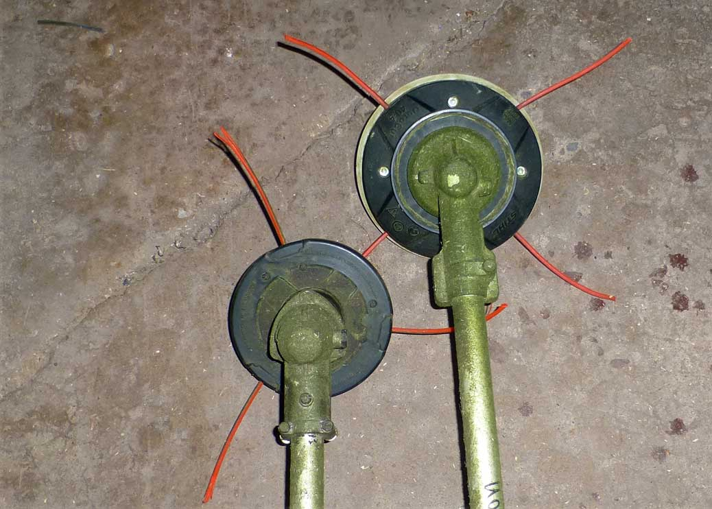

Can you post a picture of it? I didn't know of that version but maybe its for lower powered heads. It does take HP to spin these. Here is a picture of a echo and sthil.

Can you post a picture of it? I didn't know of that version but maybe its for lower powered heads. It does take HP to spin these. Here is a picture of a echo and sthil. View attachment 770402
I didn't think to take a picture but it looks exactly like your 4 string just with 2 instead.

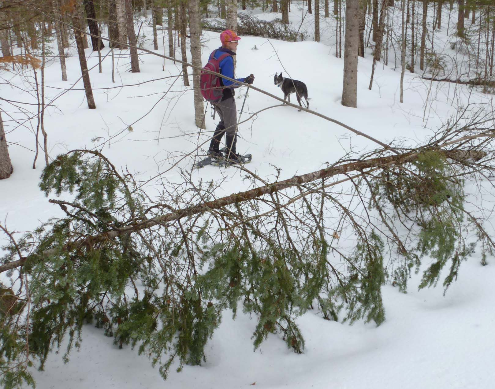

How often do you find branches/trees across the trail in the winter due to wind or snow load?
