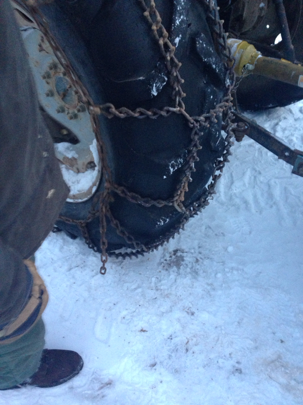

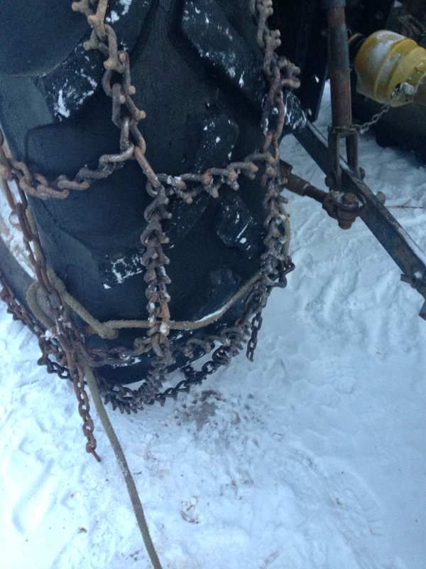

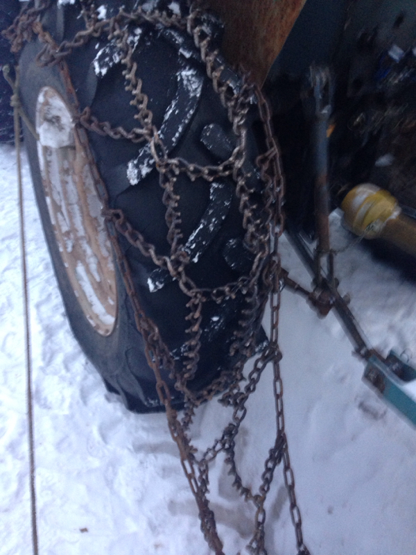

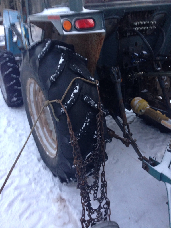

I have a set of chains I made up and used used on the front tires of my backhoes with industrial tires for years. Last year I bought a different stile if tires and found out when I had to put them on this winter it was a farce . I have the same stile I made for the back with ag. tires and they work just fine.
These are the 2 front tires and the chains didn't do a lot of good. I would have to have H pattern, diamond or rings in the center.
There was a thread I ran across where someone modified a set like you have to be more of an H pattern by adding in the middle links. That might help you out. It also appears you still have a lot of slack in the cross links that allow them to drop into the tread blocks. Can you increase the tension to keep the cross links in place. Just curious.

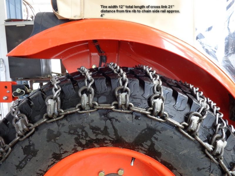

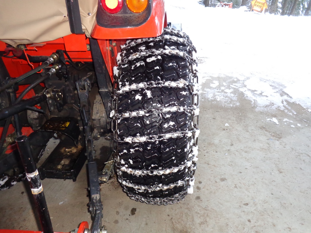

Success......... I trimmed the width by one link and shortened the lead in links and got a very good fit. Pictures tomorrow. Just want to mentioned the folks at Quality Chain stand behind their sales. Give them a call.
/ Tractor tire Snow Chain Install
#35
First I went and remeasured the tread with on the front tires, and realized I only needed to take one cross link of of the long side. I say long side as the H pattern had 2 cross links to one side chain and 3 to the other side chain, so I shortened the three side to center up the pattern. I started working on the floor, but decided to set up and old door on some saw horses to make things easier.
Took me about two hours to modify each set once I got used to the tools. On think I did have to watch for is how I attached the cross link hook to keep the cross chains from twisting. Once I learned the trick things went quicker. Quality Chain had supplied me with a supply of cross link hooks when made this job much easier. I save the old ones for use with the tensioners. One thing I did learn is the chain material is pretty tough. Took bit of effort to cut the cross links out.
#36
Once I had them trimmed down I took them out to the tractor in the barn and went to adjusting. The only shortening I did was the extra tail lengths. I connected the inside S hook first and them made sure the pattern was centered all around the tire. This time do to the pattern being narrower the inside side link set high enough on the sidewall to not interfere with the steering ball joint. I then went about tightening up the outside and adjusting the cam lock. Took about 30 minutes of tugging and turning to get things centered and the slack equalized. I ended up with the cam lock in the last link, but left 3 so I could get them on next time as I adjusted through the last 3 links in getting things to fit tight. Pictures are of the final fit and after running them for about 1/2 hour. I have some minor tweaking to do but I am very happy with the outcome. I can actually turn now while pushing snow. :thumbsup::D I may or may not fill the gap. We will see after clearing the snow were supposed to get today. Thanks for the help folks

Well we did not get the 4" to 8", system went a wee bit north, but plowing out the wet 3" we got was a dream. I can turn now and push a whole lot more. I am still going to get the rear chains to help in side hill slippage on the ice. These chains work perfect and have not moved. Tensioners are working great.
