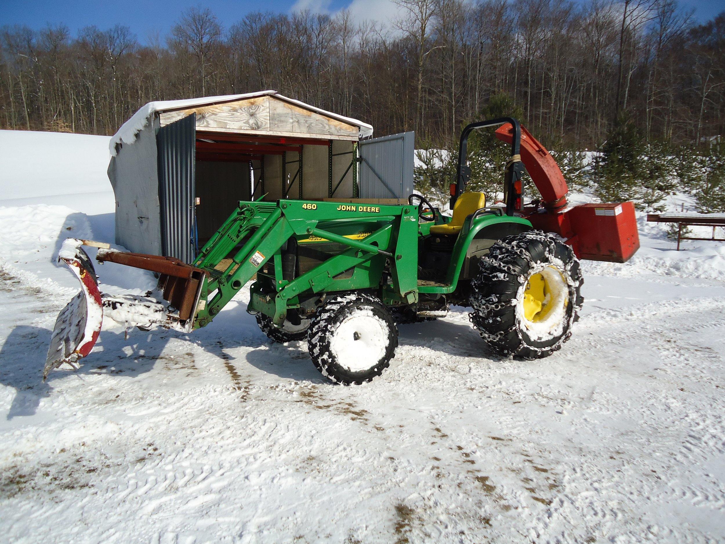

I run double rings only on the back of a JD4510 . I run a 8ft Fisher on a fabricated frame for the FEL, a 6ft 2 stage blower on the back and plow a 500ft sloped gravel driveway in western NY. When I get the front end stuck pushing the snow over a ditch the rear chains allow the grip once I tilt the plow down and lift the front out of the ditch and back. At $800 (2018) a set for the rears they do the job good enough so as not to have to call someone to pull me out and there is no reason not to use chains on front and back or to use vbar for being more aggressive. They don't tear up my grass when finish mowing the sidehill of my pond and I wore them out after 15 years of year round, as I cut firewood on my lot.
