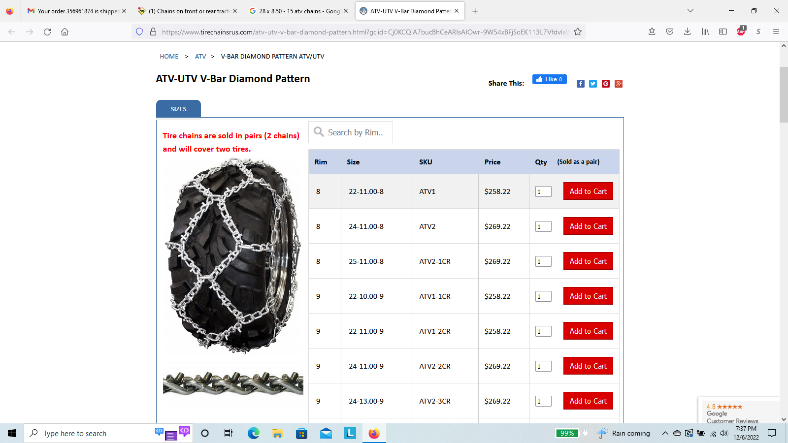

I, too, am looking into getting front chains only due to my budget. I have industrial tires on my 3520h Branson and need extra traction for asphalt while using the front bucket with bolt on wings and back blade. It’s hard to find chains that fits my 28 x 8.50 - 15 tires. Isn’t there any cross reference chart where I can use to find one size bigger? This way I could cut off excess to “size” it for my tires.
   / Chains on front or rear tractor tires for pushing snow #23
For your tire size you can look at ATV/UTV chains, 28 x 9 set will be very close;

Thanks folks, I went with tirechains.com! After carefully deciding on a 2-link ladder style (I plow mostly on pavement), I went & ordered TWO sets of 4-link chains. Before you get confused, they didn’t have the 2-link in the ladder style for my size so I decided to simply build a set using parts from the other sets. Since it’s wise to have extra cross links and a proper tool to remove & install (and eventually repair), I figured I can get it made for a very good price of $218 for a proper set! On order are 6-star bungee tensioner as well.
Should be a fun experience but overdue. We already have 8” on TOP of 16” that fell last weekend and MORE will be on the way starting Friday evening, about another 8”. I may just temporarily install the 4-chain just to get by this weekend. Tool doesn’t arrive until next week.

Yessir, I did! It came right after the snow storm. I did install the chains in the original configuration before the tool arrived as I needed traction pronto that morning. Turns out that I had to remove a cross link section and I was able to pry open the links with a long pry bar while it was mounted on the tires. No doubt the tool will be handy.
With the original 4-link configuration, I noticed a significant difference in traction and it surely helped and I’m very pleased! This week when time allows, I’ll reconfigure them to a 2-link. Hopefully I’ll figure out a new tightening configuration.
