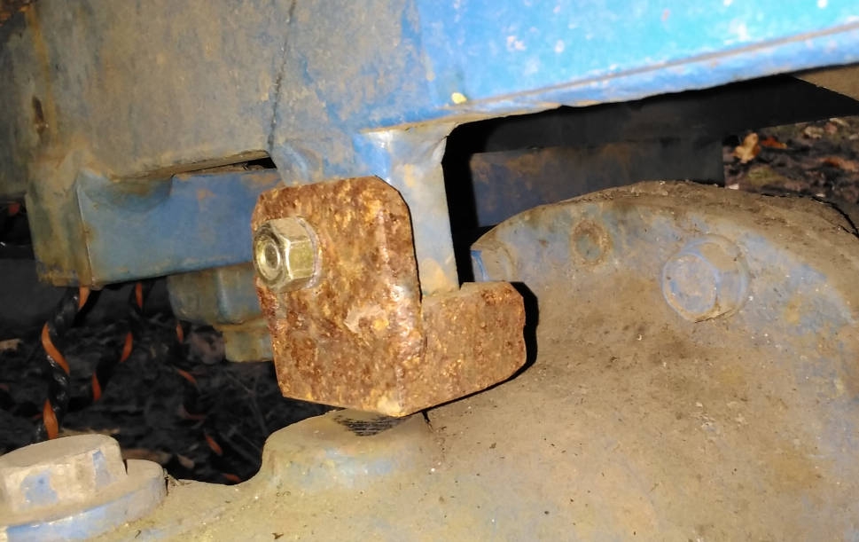

I’m not quite sure of the purpose of the blocks, and especially not sure why you want to be on two tires…
The blocks decrease the distance that the front axle can pivot, which allows him to more easily overload the front axle, loader, tires, wheels etc. with less risk of tipping. It significantly increases the chances of breaking something, since the "clue" of the rear getting light and the tractor pivoting on the front axle is less noticeable.
The goal isn't particularly to be up on 2 front wheels. However, the issue that is common is when the front end is overloaded, a single rear wheel pops up and the tractor tips until it reaches the stop on the front axle.
I have a sub-compact, emax 20s with a bucket and backhoe. A couple of times with a heavy load on the front (clamp on forks) I've felt a rear wheel lift off the ground.
Without the axle stops, the tractor will almost always roll to one side or another because of the center pivot on the axle.
Then depending on how the load is being carried, it will shift the load even further to the side. So, a chain suspended load will pull to the side where the tractor tilts. On my tractor, it seems to hit the axle stops before it has tilted beyond the point of no return. However, if one of the wheels falls into a hole, or you're on a slope, then that equation could be shifted towards being unstable. Also narrower wheels on the tractors could reduce the tilt stability. Ultimately it is very uncomfortable.
I don't know the front end strength of my old Ford. It seems to be built solid enough for what it can lift. There were a couple of Messick's clips I linked in another thread indicating that the front end strength of some of the newer compact tractors can be less than one would otherwise expect. And, his claim was that more ballast on the rear reduced the weight on the front (as long as one keeps it below the balance/tipping point).
Anyway, that load picking up the scissor lift might not have tipped, or it could have tipped over both the lift and the tractor had I not added the axle stops. That was a little unintended (as always), and shifted the weight on the bucket as I pulled the scissor lift off of the trailer.
It is easy enough to feel the floaty feeling with 90% of the weight on the front axle.

Ok, a while ago I made these little axle blocks for my little Ford.
The blocks helps the axle resist rolling, going between the factory stop and the axle. Pretty simple to make. Quick weld, and then drilling both the block and the axle stop on the tractor.

If I do it right, I can get both rear wheels off of the ground without the tractor tipping to the side.
I don't know how dangerous it is when the tractor rolls over to the factory blocks, but it is very uncomfortable. Plus, I can now get 2 wheels off the ground, rather than just one.
My biggest issue is driving in certain areas such as climbing up away from my driveway where I can actually get the tractor driving on 2 wheels (one front, one rear). I have a wheel locker and need to use it from time to time.
I can't say if every tractor would work well with these blocks, but it is good for mine.

You can’t be doing any good to that front axle. And why would you even…
I’m just gonna stop, proof not every idea on the internet is a good one.
