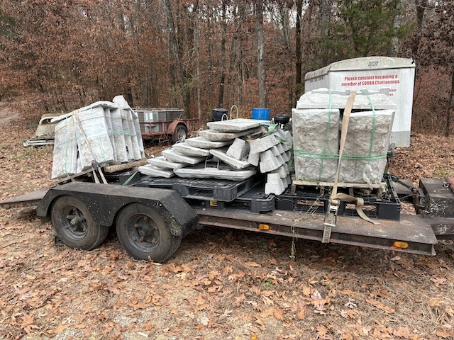

I bought some pallets of precast modular retaining wall from a guy down the road. The manufacturer says the pallets are 1850 lbs. Talk about pucker factor trying to load these pallets on my trailer to get them home. The sketchiest tractor work I have ever done. I had a 1200 lb. ballast on the back and QA pallet forks. Unloading them was even worse. Sometimes it is just not worth it. As much as I am dreading it I will be loading the remaining 3 pallets on the trailer by hand. Be careful out there folks!View attachment 840460
I would guess that the load you have pictured may be overloading that trailer…..
/ tractor tipping question #22
It is quite possible. I towed it with the tractor a little over a mile down the road, all uphill. The tractor was working for sure. Possibly not the best idea, it was one of those times where I was very happy to get off the tractor once I got to the property.
/ tractor tipping question #23
Mobile home axles are designed to take a lot of weight.
If the 3 pallets weigh less than 6,000 lbs, then it may be within what that trailer can carry. It really depends on how the trailer was made. Does it have springs? Were they bottomed out?

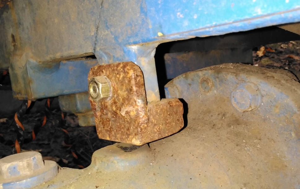

Ok, a while ago I made these little axle blocks for my little Ford.
The blocks helps the axle resist rolling, going between the factory stop and the axle. Pretty simple to make. Quick weld, and then drilling both the block and the axle stop on the tractor.

If I do it right, I can get both rear wheels off of the ground without the tractor tipping to the side.
I don't know how dangerous it is when the tractor rolls over to the factory blocks, but it is very uncomfortable. Plus, I can now get 2 wheels off the ground, rather than just one.
My biggest issue is driving in certain areas such as climbing up away from my driveway where I can actually get the tractor driving on 2 wheels (one front, one rear). I have a wheel locker and need to use it from time to time.
I can't say if every tractor would work well with these blocks, but it is good for mine.

I’m not quite sure of the purpose of the blocks, and especially not sure why you want to be on two tires…
The blocks decrease the distance that the front axle can pivot, which allows him to more easily overload the front axle, loader, tires, wheels etc. with less risk of tipping. It significantly increases the chances of breaking something, since the "clue" of the rear getting light and the tractor pivoting on the front axle is less noticeable.
Sorry, but I don't see how having limited articulation would make it easier to overload anything up front. To me, adding weight to the rear does.
Also, it's very easy to tell when the rear is getting light (well. for me it is) regardless of articulation abilities. I've lifted both rears evenly a few times when underestimating the weight on the pallet forks, and with unaltered pivot travel in the front.

It makes it easier to overload without pivoting as much. If you're on perfectly flat ground, with tires that are at exactly the same pressure, lifting a load that is perfectly centered and the rear of the tractor has the center of gravity exactly balanced between the wheels and the operator stays exactly in the center and doesn't lean one way or the other, at all, then the rear wheels will lift evenly and stay that way. Otherwise, they may lift at the same time, but as soon as there is the slightest shift in anything being exactly balanced in the middle, the tractor will pivot on the front axle. Adding weight to the rear will also allow more overloading, since it makes the machine more stable and less prone to the rear end lifting.
