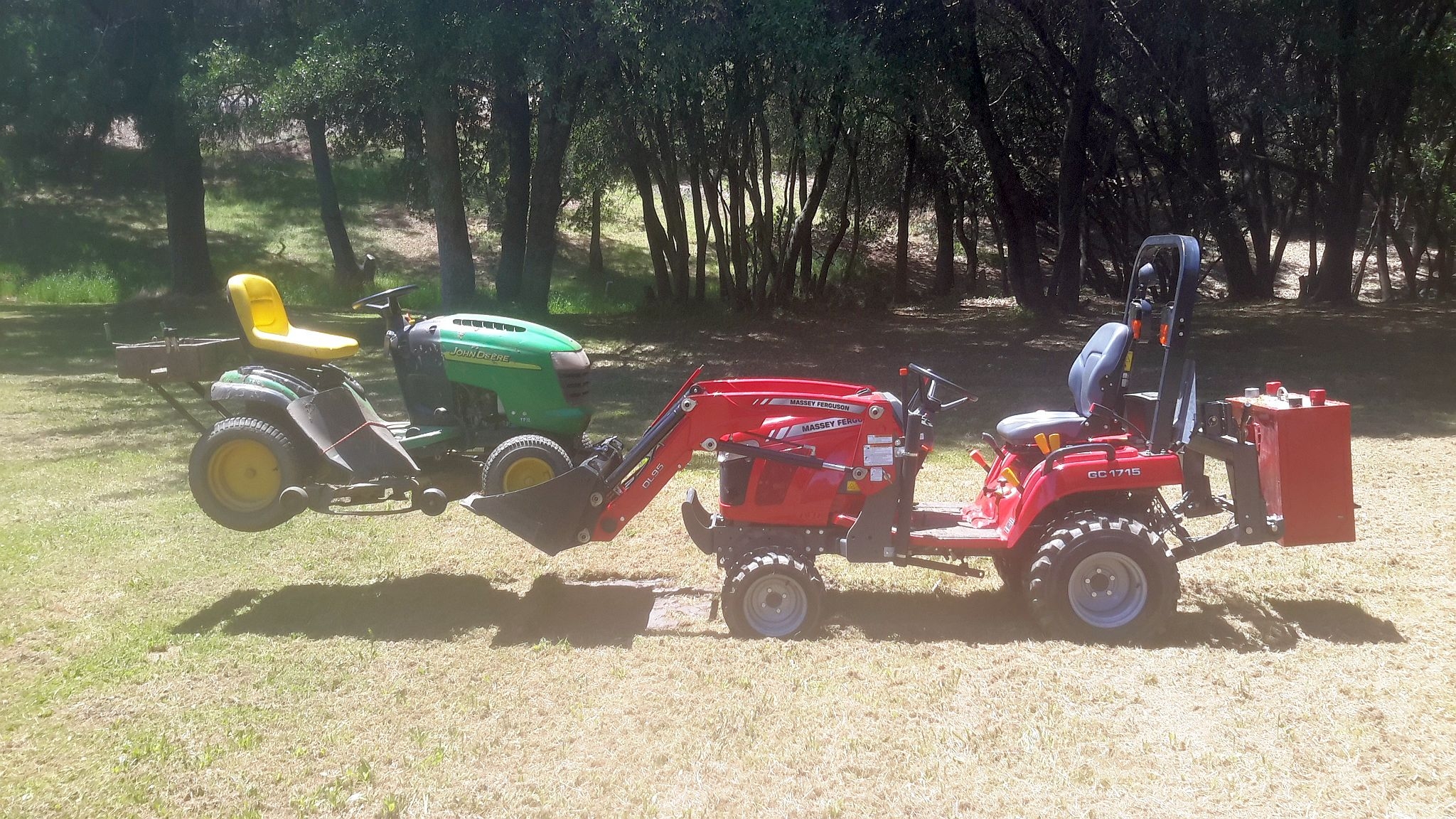

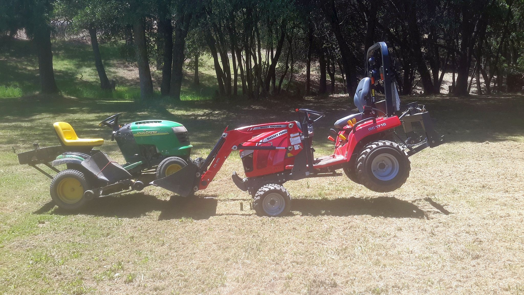

I have a sub-compact, emax 20s with a bucket and backhoe. A couple of times with a heavy load on the front (clamp on forks) I've felt a rear wheel lift off the ground. Lowered the bucket, inched forward, and lowered the backhoe outriggers to help keep from tipping. Is that a stupid think to do? Does it help?
Unfortunately since you are lifting a rear wheel off the ground, you will only lift your rear wheel and outrigger off the ground. You will slightly change the weight distribution as you put down your outriggers, but you WILL NOT change the lift capacity of your loader. Your machine is a smaller tractor with all the counter weight it can handle with a backhoe installed. You likely are trying to pickup more than the tractor is capable of lifting. Only suggestions are 1) reduce the load you are trying to lift, 2) swing the backhoe to be straight behind you and extend its reach putting as much weight as far behind you as possible.
