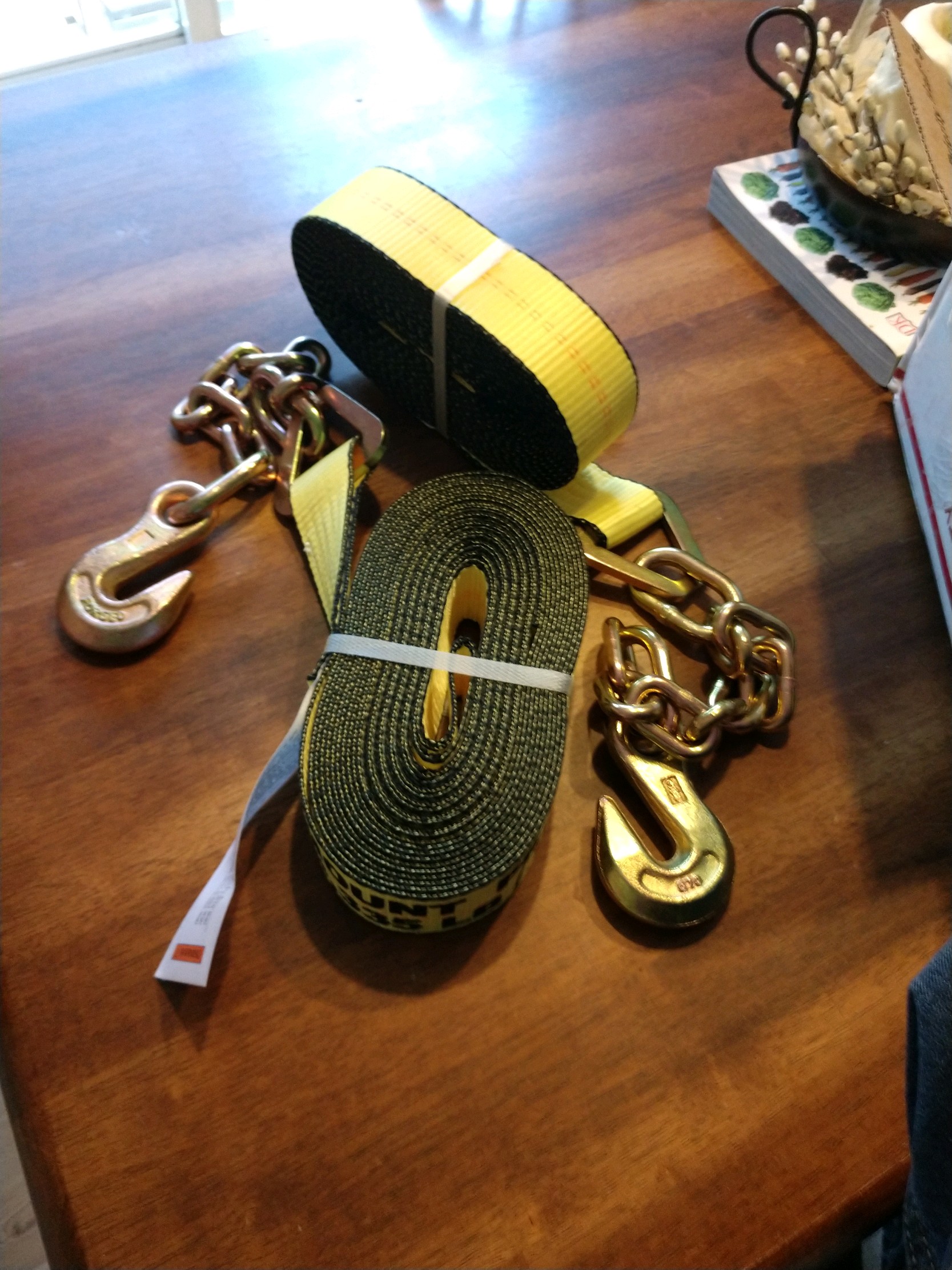

I run this end through the stake pocket to eliminate strap wear when securing my subcompact. i also have slip on strap protectors to keep the straps from wearing if they are rubbing an edge elsewhere.
/ Tractor Tie Downs #32
I’ve never had issue with the straps wearing at the trailer stake pockets. I usually use 1 strap per corner to avoid touching anything else with the strap. If touching is inevitable I use some cardboard to protect the strap.
/ Tractor Tie Downs #33
I use both, and differs with the application. I have used 6' chain with steel J hooks on every wheel, just recently I purchased two 31" straps for the front axle to keep from scratching and then 2 J hooks on the backhoe mounting plating. New York is a every wheel chain tiedown plus strapping your loader and backhoe bucket down to the trailer also. I chain and strap like I did hauling steel, you can never use too many hold down devices.
