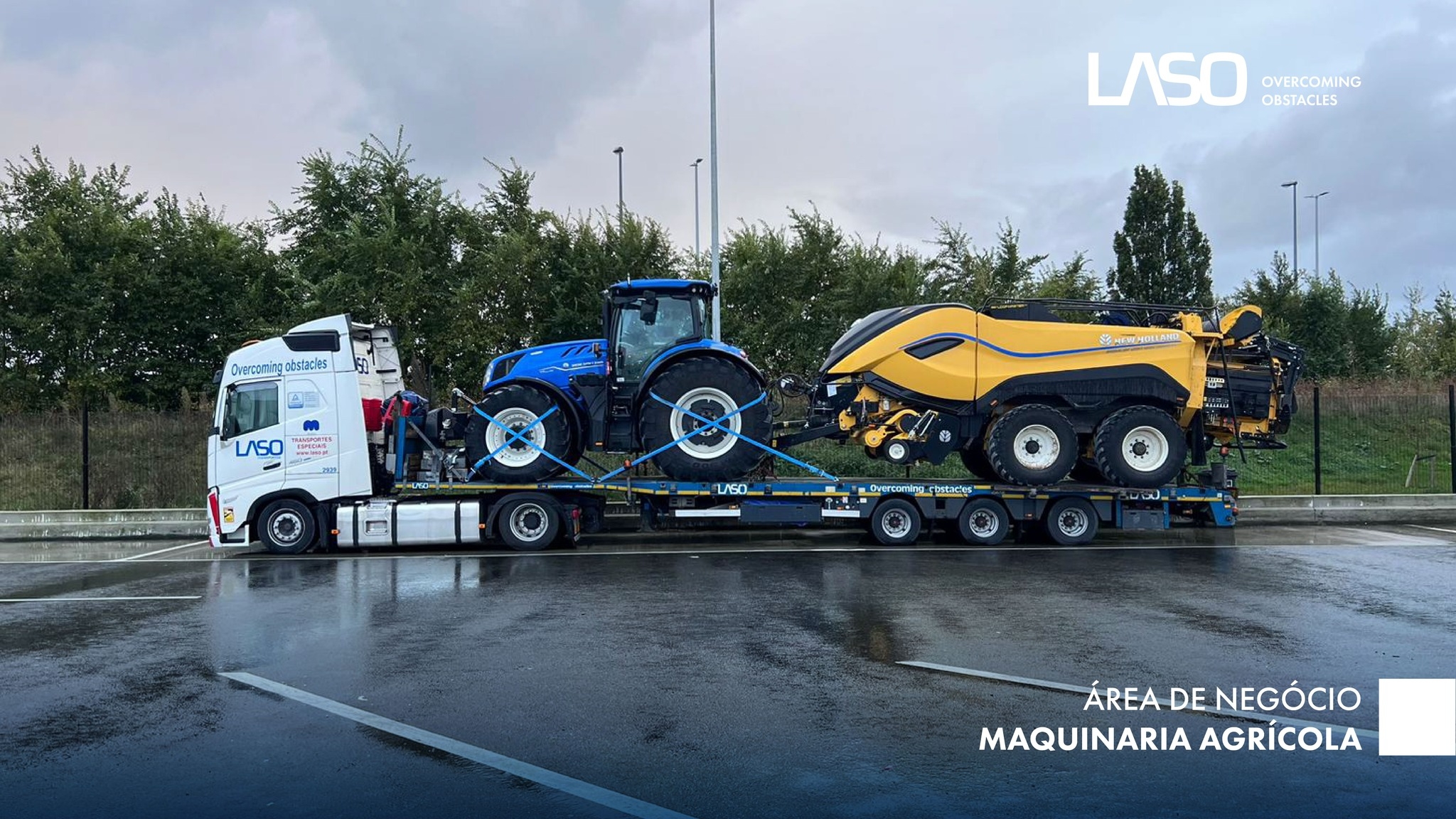

This is how they do it in my neck of the woods. Just 4 simple straps and it ain't going anywhere. (Baler is tied down too) No heavy chains to drag around or need for fancy shackles.
I often see threads where people claim that tractors don't have good tie down points or something. I don't really understand where they get that from.
Quite a few want to confuse FMCSA rules with farm equipment (under 10,000 lbs). Straps or chains doesn’t really matter if they’re not used right.
