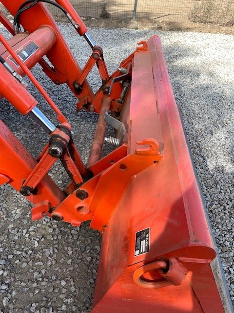

The previous owner hauled my tractor, more than he used it. 150 hrs in 4 yrs :D. Anyway he had the dealer weld D rings on the bucket sides for hauling.

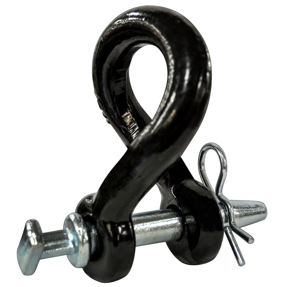

So the chain goes through the twisted clevis hook? Where did you get that?
A twisted shackle is a safer option than the twisted clevis. Rated at a much higher load because the pin isn't free to move around. Make sure the pin diameter is close to the size of hole in your draw bar also

makes sense, Does the twisted shackle attach at the lower link of the 3 point and if so mine is a category 2 so 1 1/8 diameter cant seem to find a twisted shackle beyond 1/2" I am pretty sure I dont know what i am talking about Help :)
