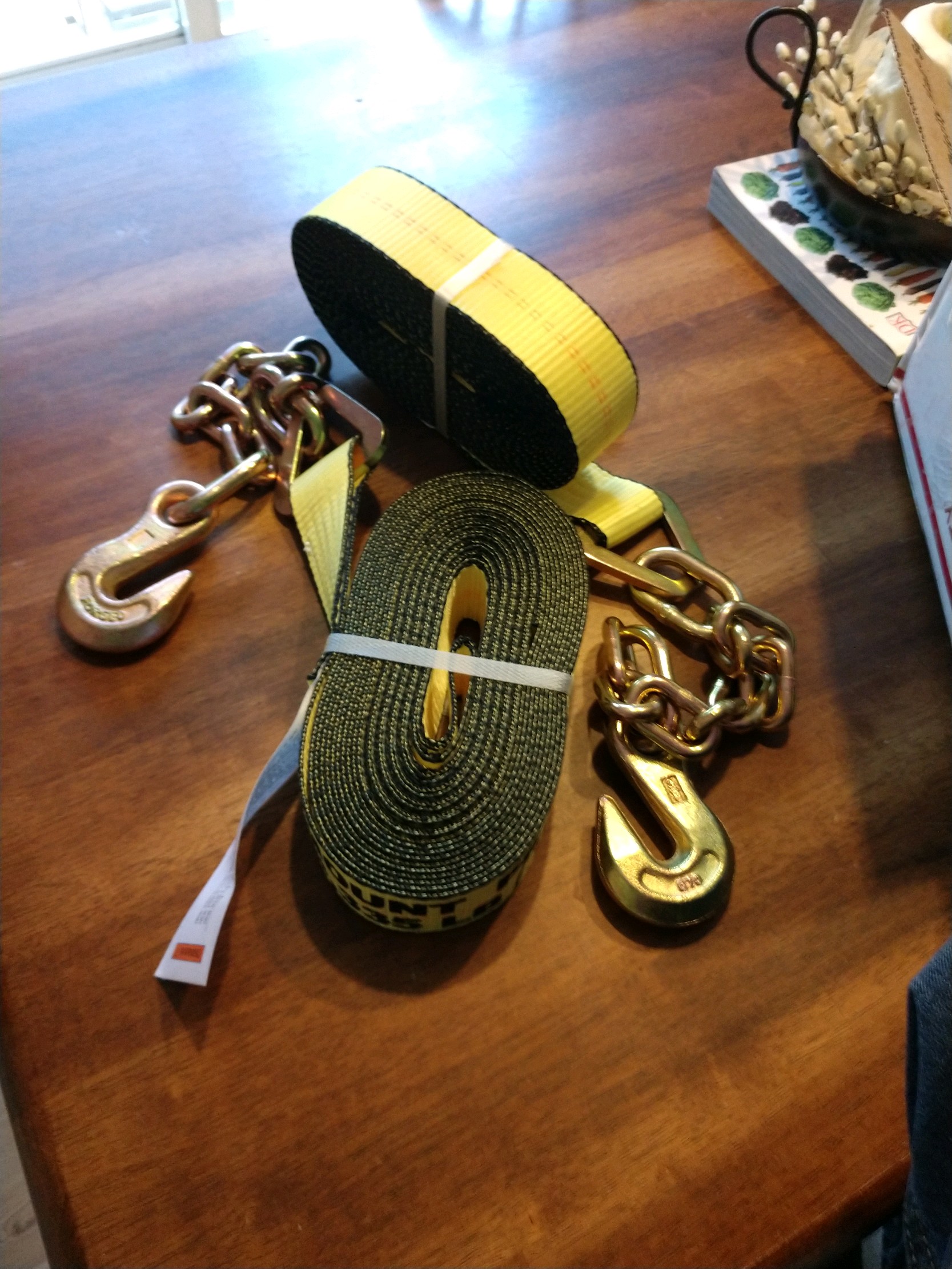

so the straps with chain hook ends vs chain. a set of 4 straps at $70 each is the same price as a 4 pack of 5/16 chain and binders. I would argue i can do a lot more with the chain and binders that you wouldn't do with the straps especially around the farm. The longevity and durability of the chain means Ill be useing it for the heavy tiedown. For the light stuff straps still have the advantage.

I run this end through the stake pocket to eliminate strap wear when securing my subcompact. i also have slip on strap protectors to keep the straps from wearing if they are rubbing an edge elsewhere.
