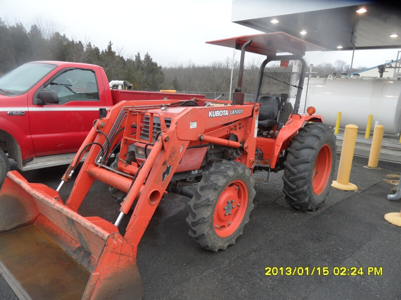

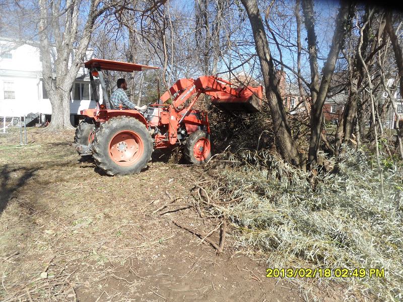

I was in a similar situation - Just bought a house, w/ sheds and 73 acres in Mississippi in 2012. Needed a bigger tractor, SWMBO and I decided on a $15K target price. I felt I needed a tractor that would lift a ton on the back and 1,000 lbs on the front. I've moderate wrenching skills. After about 6 months of looking I found
View attachment 597382 View attachment 597383
a 1995 Kubota M4700, 50HP, MFWD, 1400 hours for $11.5K. I quickly spent the other 3.5 K on attachments.
So if you have moderate wrenching skills you should be able to get a suitable tractor and maintain it for your 15K. But it's probably going to take some looking.
