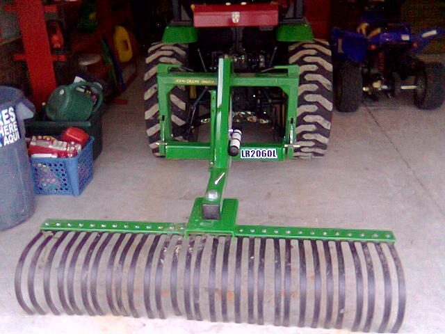

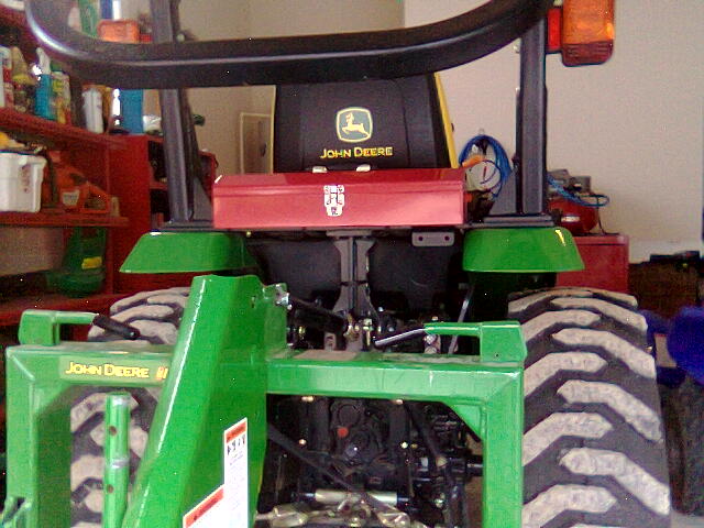

VT-
I GOTTHE 2320 WITH R4'S AND 2060 RAKE, JUST GOT THE RAKE YESTERDAY AND USED IT FOR ABOUT AN HOUR OR SO. WORKS GREAT, THIS IS W/O A DOUBT A IMPLEMENT I RECOMEND YOU GET.
JUST AS JD MENTIONED VERY EASY TO USE BUT CAN NOT TAKE THE PLACE OF A GOOD BOX BLADE FOR THAT I CHOSE THE BB2048 EVEN THOUGH YOU COULD PROBUALLY GO BIGGER (MAYBE A 5' BB ON EITHER 23XX OR 25XX), AND BE OK!!!
