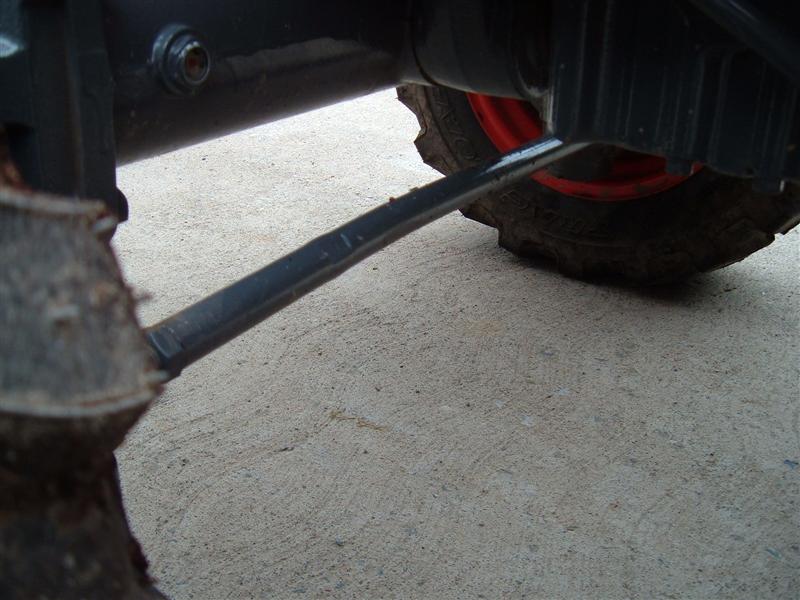

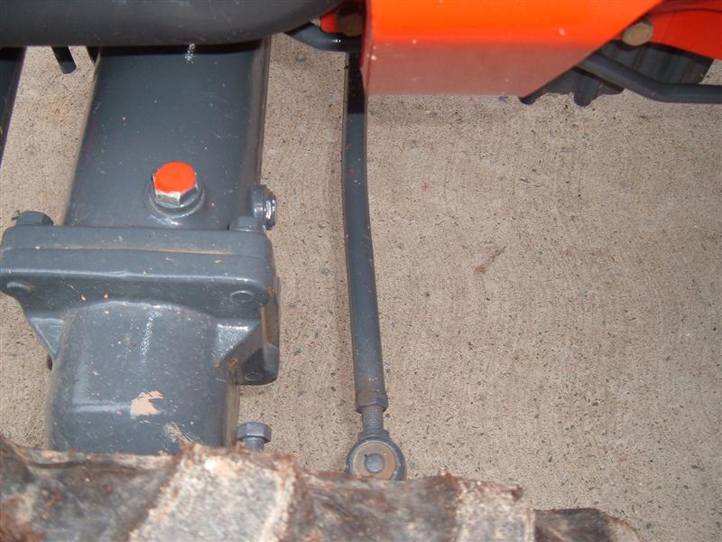

Bend the tie rod on my new CK30. Was there a new modified version on the latest CK25/30's for the tie rod placement or tie rod itself?. The one I have was a leftover 2006, couldn't pass up on trading in the old CK20 and moving up.
Steve

You've got the little te-rod. The newer ones are a larger diameter than the nuts. It looks interchangable with the only difference being the bigger rod diameter but I would rather bend the rod than break the hub ear.
Welcome to the club. Did you even feel it happen?

I concur. I'd rather the rod be the weak link. It can happen on any tractor. One of my co-workers has a TC35 w/Ags, much higher ground clearance but he still bent his. If you had higher clearance you'd just try to drive over higher obstacles. Put it in a vise, bend 'er back, re-install and adjust alignment as needed.

You'll need some heat to bend it back unless you are super man. It is solid and very stiff. A new one is not too expensive. Heck, I've even got a new one on the shelf for a back up so they must not have been too much money.
Be careful not to rip the tie rod end boot when you pickle fork the end off.

There's no need to straighten it; you'll just bend it again.
The tractor doesn't know it is bent, just adjust the toe in (about 1/2" as I remember, check) and that's it.
No kidding, mine even looks better bent, it looks like it was made that way to give the most clearance.

I bent my tierod last year. I heated it up in and straightened it in a vise. This did weaken the tierod and it bent again even worse about a month ago. I knew the day would come, so I had bought a new one from the dealer.
For me.. straighten it out to get yourself back up and running.. then buy a new one for a backup.

you can heat it but it will be weaker after that. I used a press to straighten mine................three times. The boots on the ball joints will tear with a ball joint fork. At you local auto parts store go to the "Help me" section. They have boots that will work fine for a couple of bucks each

An old Jeepers trick... Straighten the tie rod best you can. Then, set your toe-in. Now, weld a pies of 1"-1.5" angle iron on there. It will strengthen it, and if placed correctly, act as a skid too.
