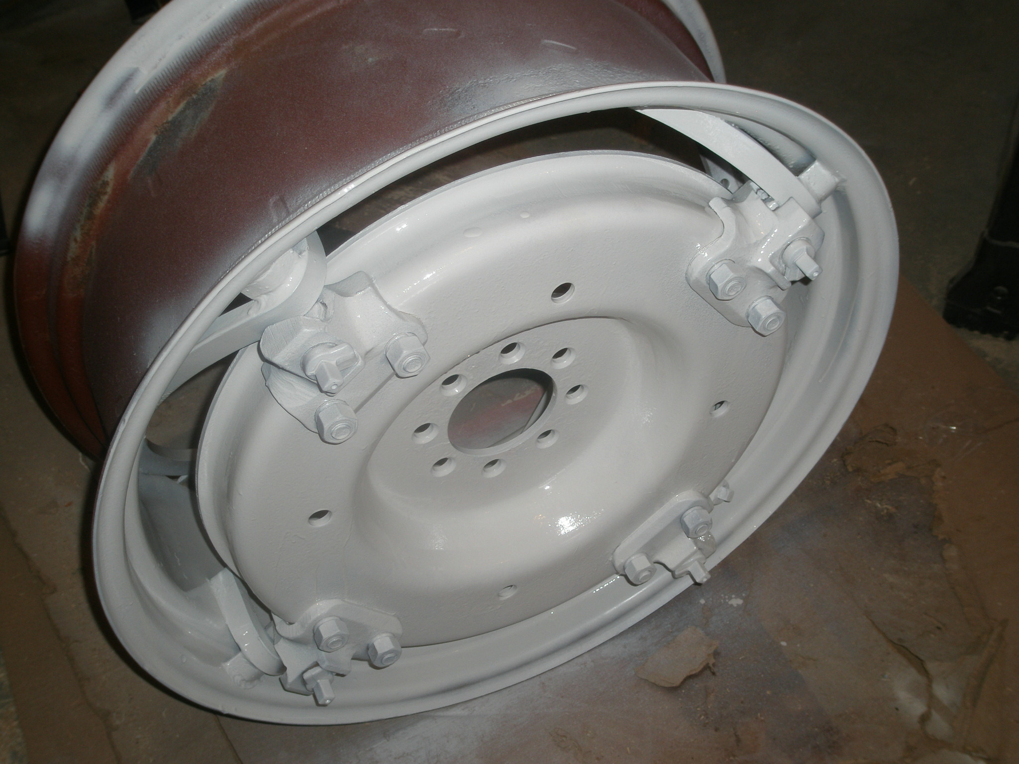

Now I am wondering if I messed up. I had a rear rim rust through and when I put the new tube and tire back on the new rim I didn't use anything then had tube filled with beet juice. Will never ever use Calcium Chloride again I replaced both back rims in 2 years and of course they split when I needed the tractor the most. I bought the tractor used and the tires were already loaded so I don't know how long the Calcium Chloride was in there before they rusted out.

I was lucky with the rim. I didn't find very much rust on the rim and the CaCl had been in the tires tube for a long time. I had the CaCl put in my BX2200 rear tires with tubes, it ruined one rim but I was able to salvage the other. So final word on CaCl ... If done right with out spills the CaCl will not harm your rims. Problem is it will take several years to find out if all was done right. So like you I am done with CaCl. I have beet juice in the L3800. My only fear is that should I get a puncture I see no way to salvage the ballast during repairs. And usually I do not notice punctures until the next day when I see the tractor not sitting right. Looks like I'm going to use Anti-freeze, windshield washer fluid or some winter rated variant of that. :2cents:

remember... rubber and paint don't rust.
don't matter what the tubes are loaded with. if none of it gets to metal.. you get no rust.
rusty rims and caclk comes from lack of maintenance.
if you get a tube leak.. or leaky valve stem. you break the stuff down, wash the rim and casing, and repair or repalce the tube ( I repalce. no need to do that work twice ).
standard practice i see is to cram in a new core or crank on a cap with a rubber under it to staunch the leak, and then not clean up the spill.
or.. if a slow leak.. just let it leak.
that's where you hit most problems....

My problem with cacl (I use it) is some of my neighbor mowing is in a field that sprouts hawthorns. The spikes on them will go through the soft rubber between the ag ribs. If you don't see them to remove them (they break off at the surface) they'll sit in the rubber and the points eat their way through the tube. Eventually you get enough salt out of the tube to eat the rim if there's any flaw in the rim paint.
Good stuff for weight and price, but intolerant of flaws. Flaws I got.

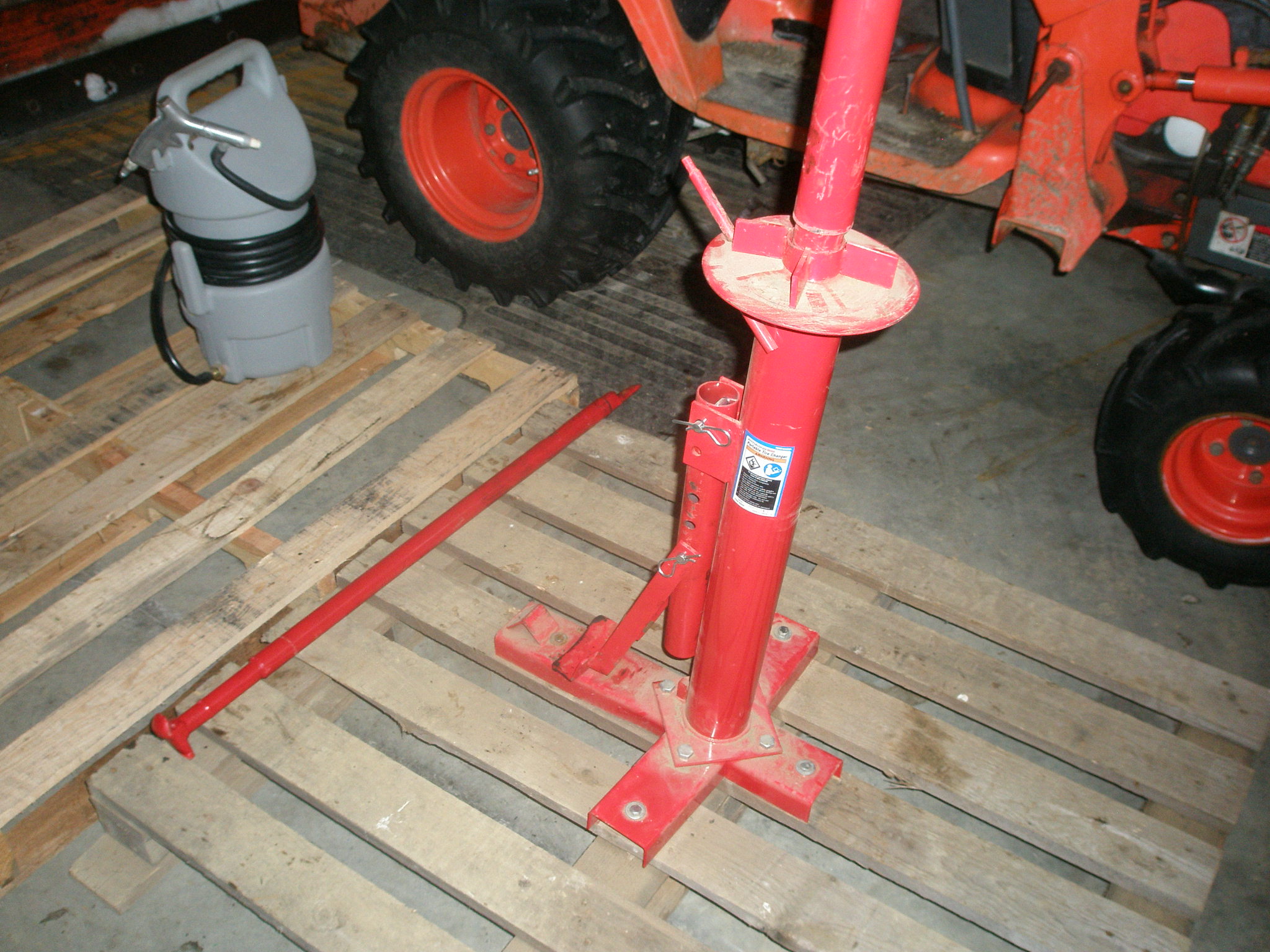

I also bought a remote tire inflator for setting the bead of the 13.6-28 tractor tire. Have tried it on the car tire and it is working great. Should be a nice tool for many years.
Today the L3800 right front tire decided to deflate and came half off the rim before I noticed. Tomorrow I get to clean that up and use the Ruglyde and remote tire chuck. :cool2:

Yes, That remote is similar. I found mine at Gemplers. It is 3' with a side mount or 90 degree clip to attach to the nozzle. If it was a straight in air chuck that would be too bulky for some tires.
