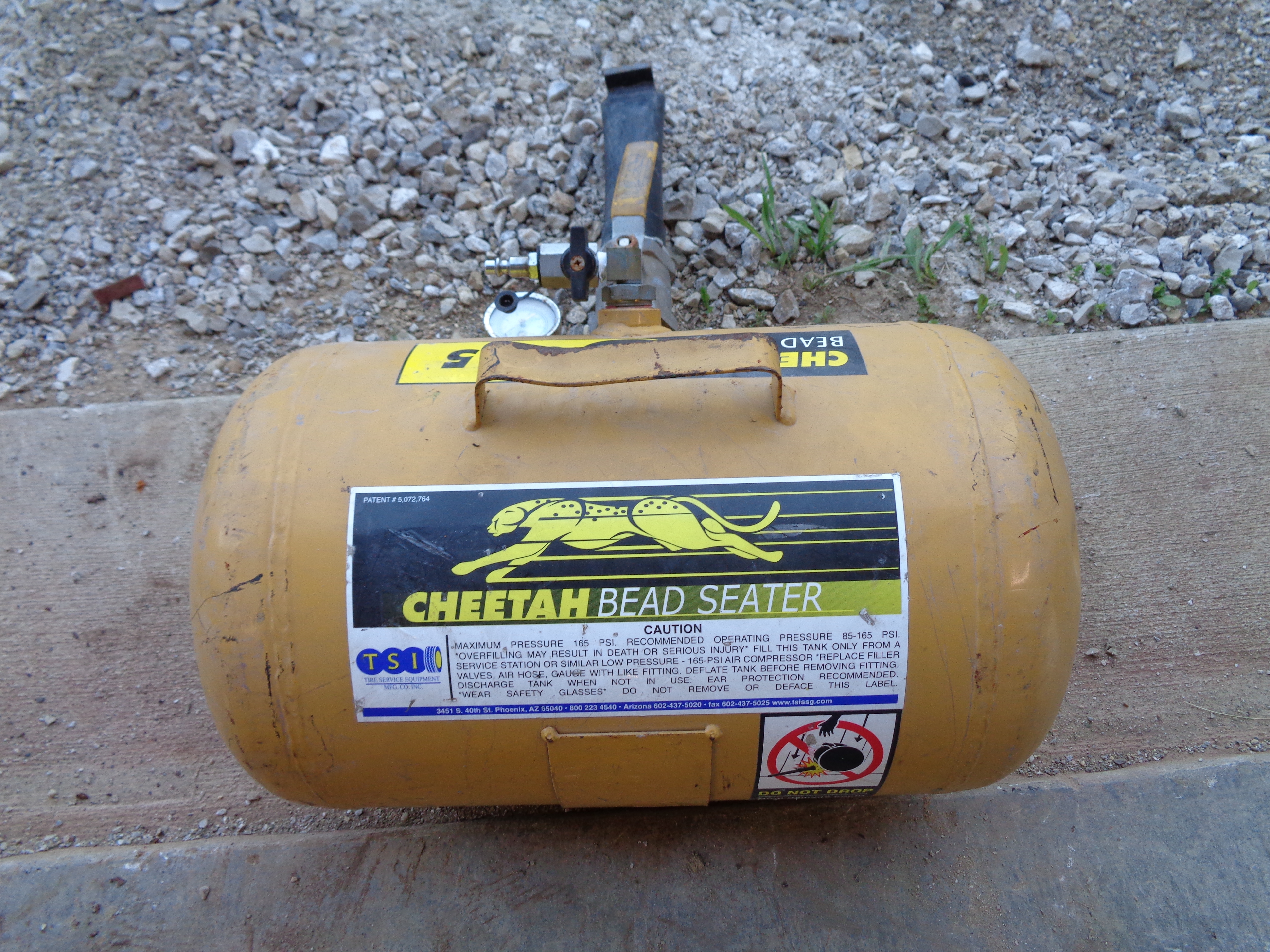

OK ! So I had an opportunity to mount 2 brand new R-1 type 24x12-12 tires today.
Yeah, ATV and wide golf cart tires are difficult. I never tried a bead blaster, but I hear good things about them. These kind of tires are often strapped together and shipped where the carcass is distorted and Very Difficult to seat. Letting them get warm in the sun helps a bit.
I successfully used the starter fluid method on the 24x12x12 6-ply tires I got for my Toro Workman project. I tried that method a few times over the years, but I guess I was not doing it right. I tried all other methods before resorting to fire. I don't do it enough to justify a bead blaster.
I have discovered that it is way easier with starter fluid vs. any other fuel, and you have to use just enough. Too little or too much, no good. Also, the valve stem has to be out. If you leave it in, the inflated tire cools so fast that the tire collapses if it can not draw in air thru the stem.
It is not as violent or loud as the the final bead seating with air pressure. For that I keep the valve out and firmly affix my compressor hose to the stem. Then turn on the air at the compressor, well away from the tire. I often need at least 75psi.
Final seating is louder than a shotgun blast for difficult-to-seat tires.
BTW, I find larger tires, including tractor tires to be much easier to break and seat beads, plus remove and install.
