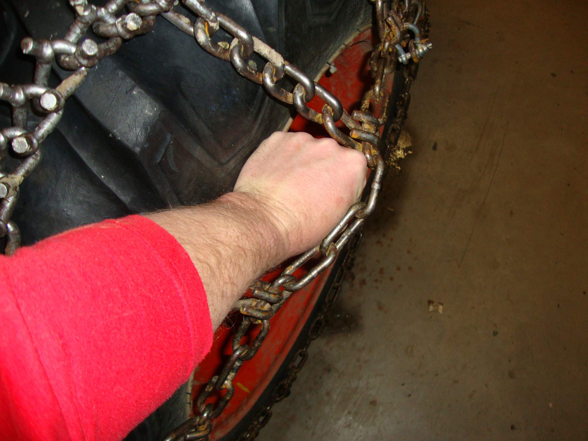

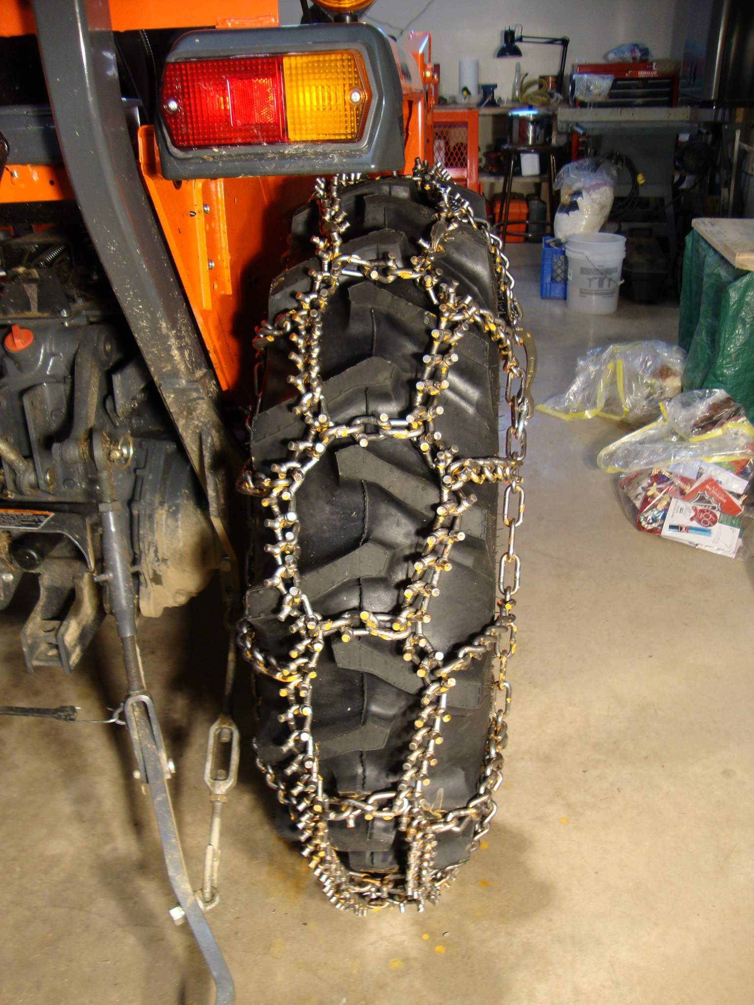

I don't use tensioners at all on my Kubota L3400 with R1's. If the chains are the right size they won't slap, and mine are run LOOSE, as suggested by the manufacturer. I started with about 2-3 inches of clearance, and other than an occasional slap the first year until I got the adjustment right, they've been fine.
Tellefsdal recommends that you should be able to get a clenched fist between the side chain and the tire, and that the whole chain should rotate around the tire about a foot for every km you drive.
Sean

If you mean mine, they're quite smooth. That's one of the benefits of having them loose, they can move around a bit and not create a high spot tight against the tire. I run on pavement a bit from one house to another at full speed, and they're not much worse than bare tires.

I only have them on the rear, other than a tendency to sideslip a bit when plowing with the rear blade angled, the tractor really doesn't need front chains. Being able to steer with brakes if I have to helps.
I got them from Nova International, my local Kubota dealer. They're made by Tellefsdal (Norwegian), and Aquiline makes or sells a chain called the Talon that's very similar.
