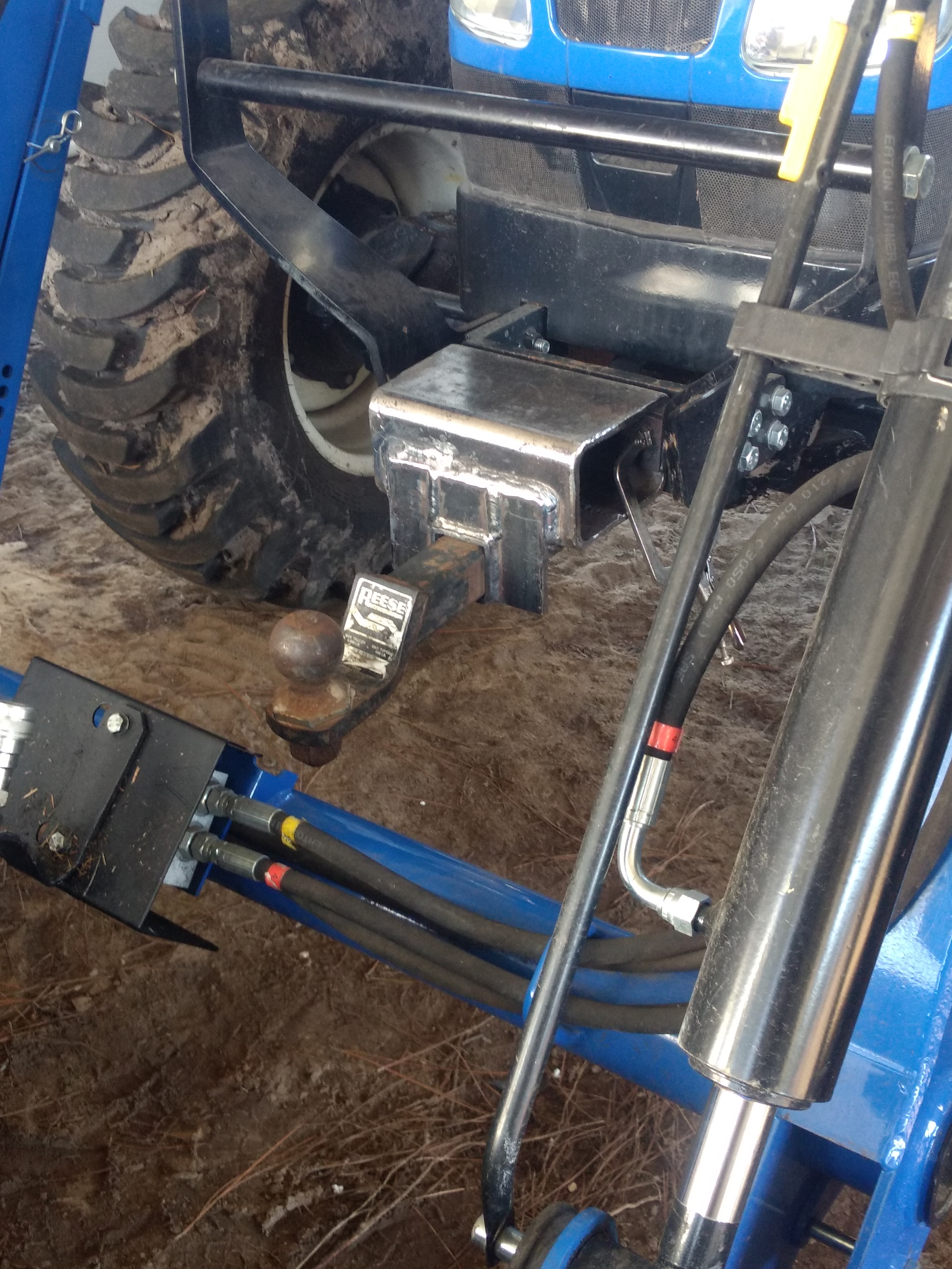

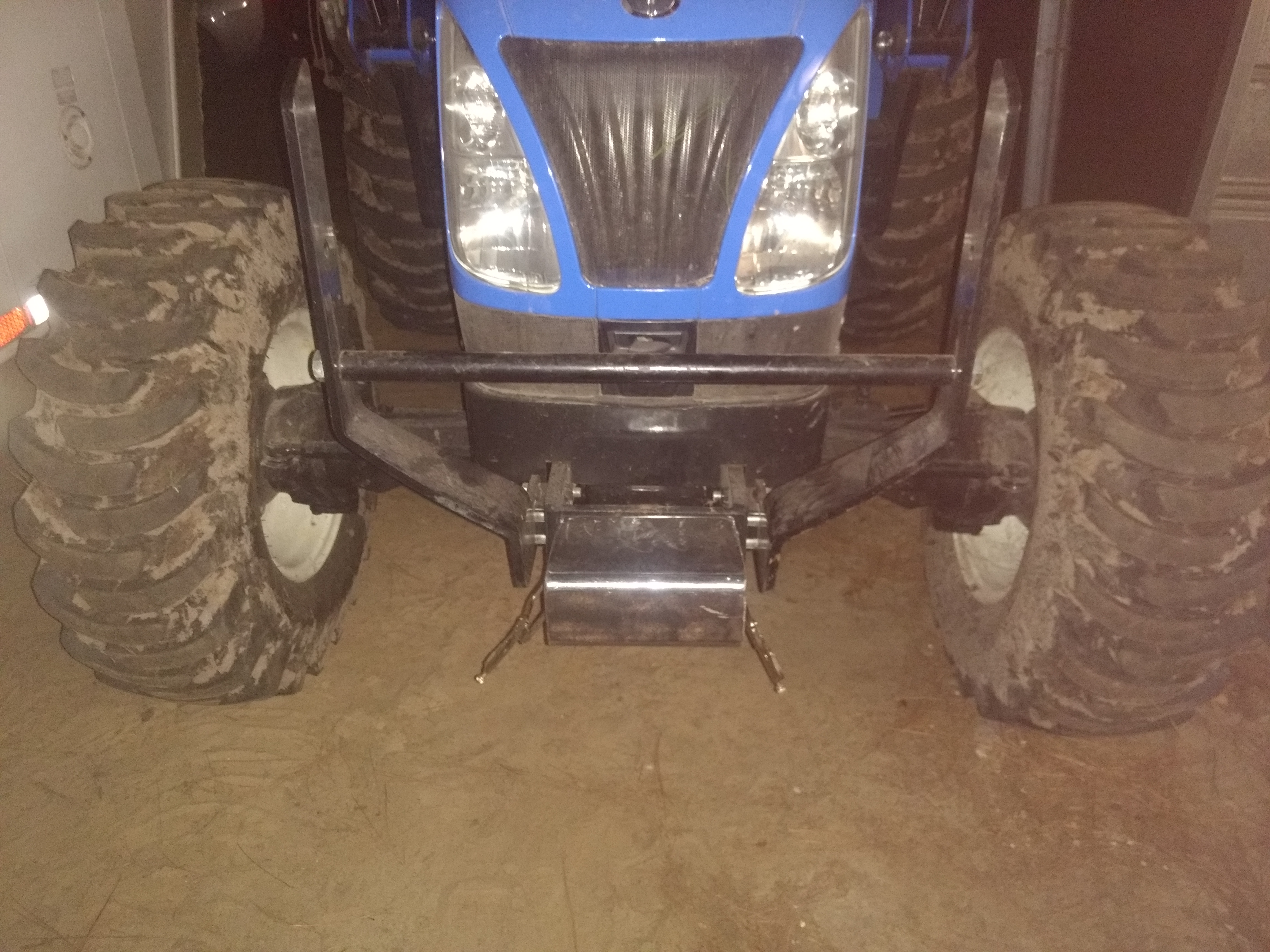

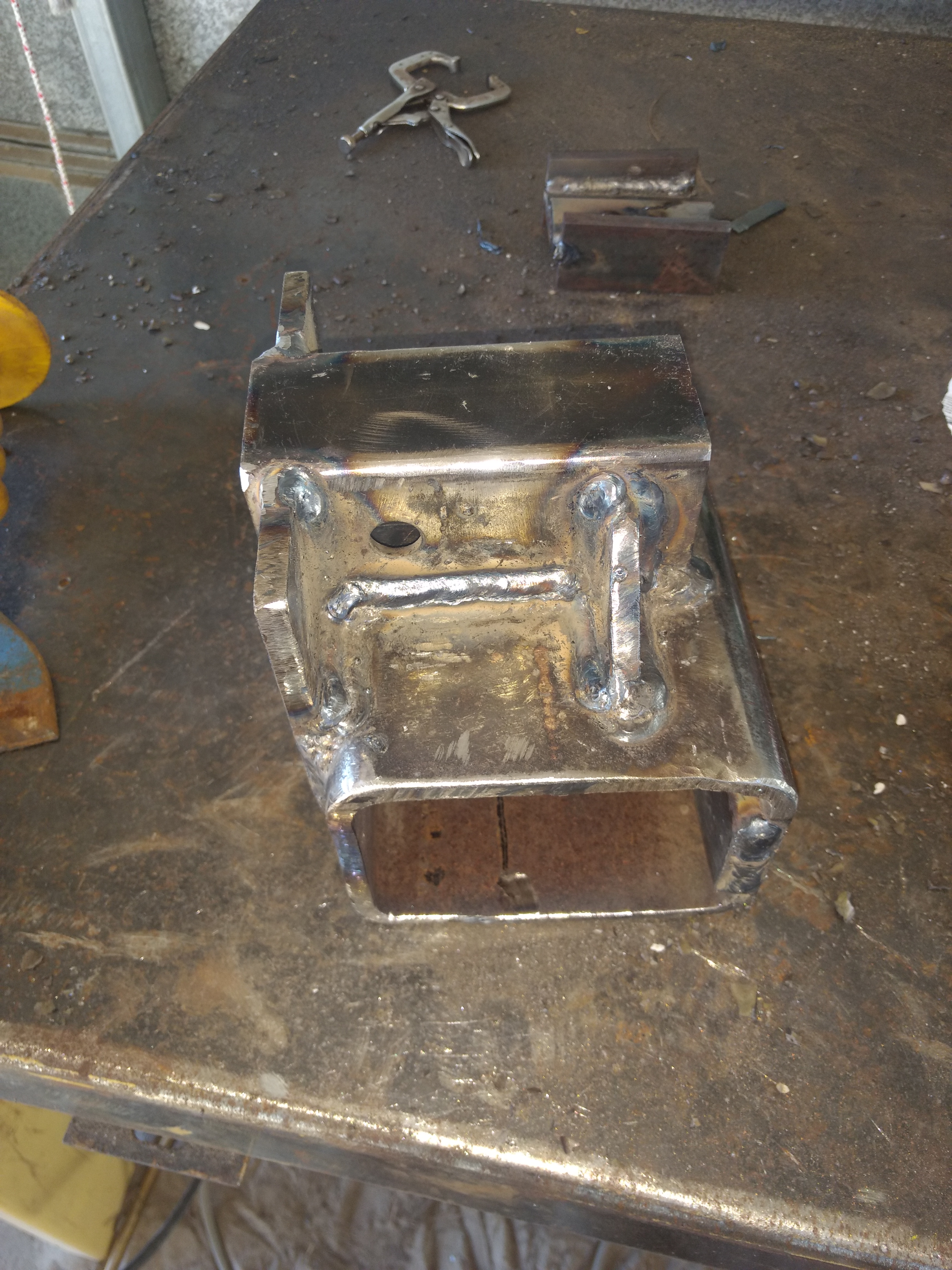

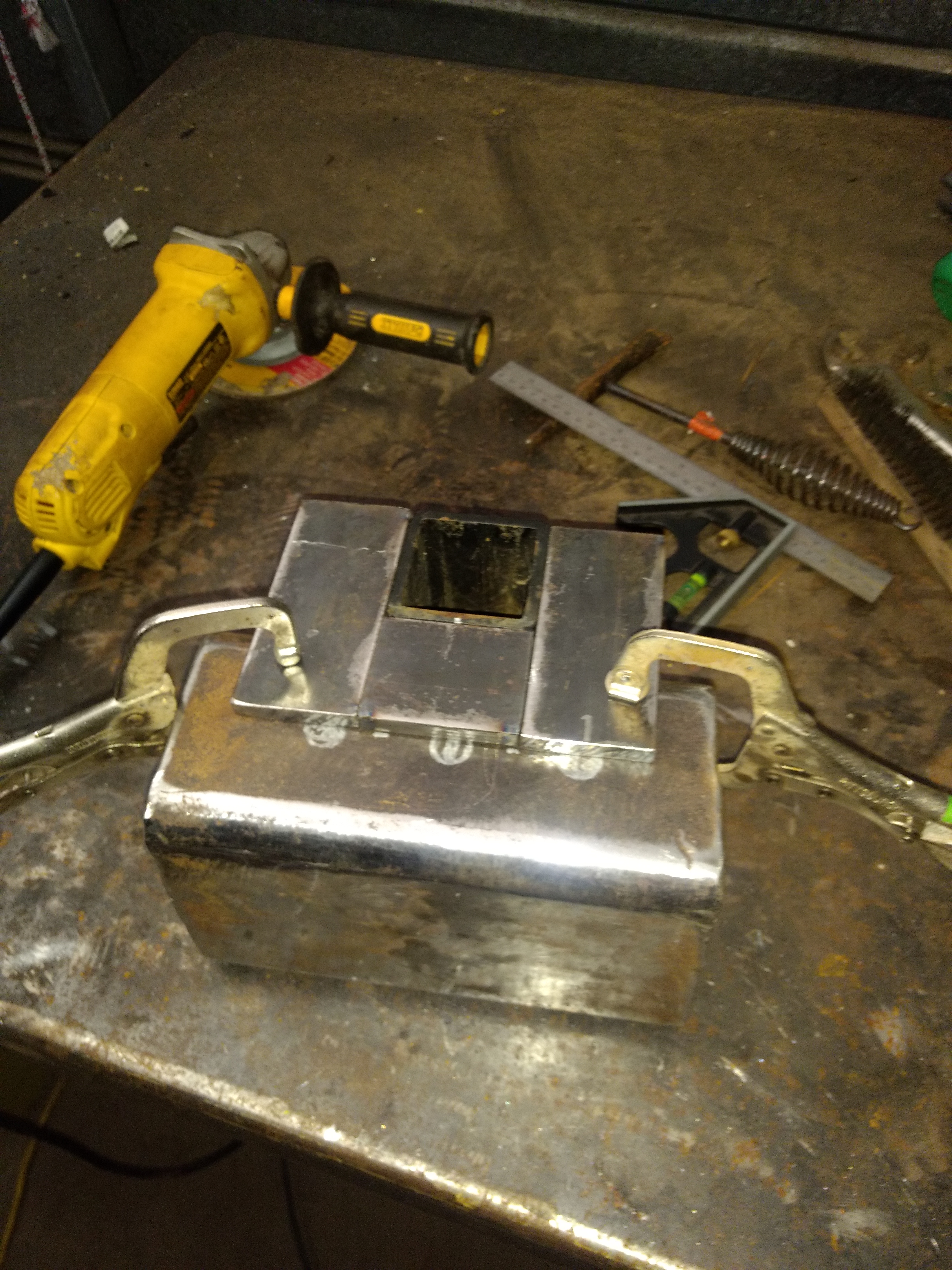

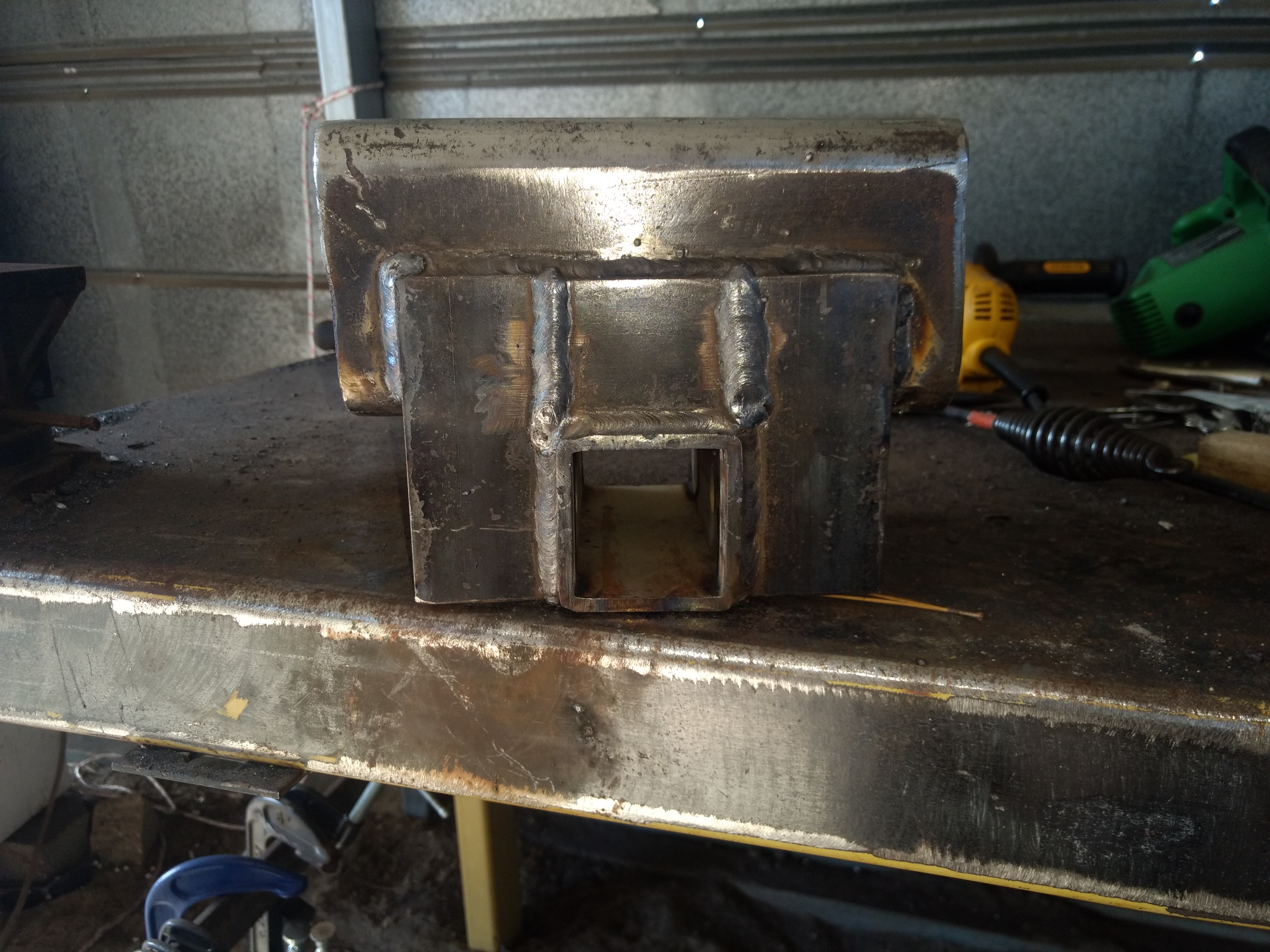

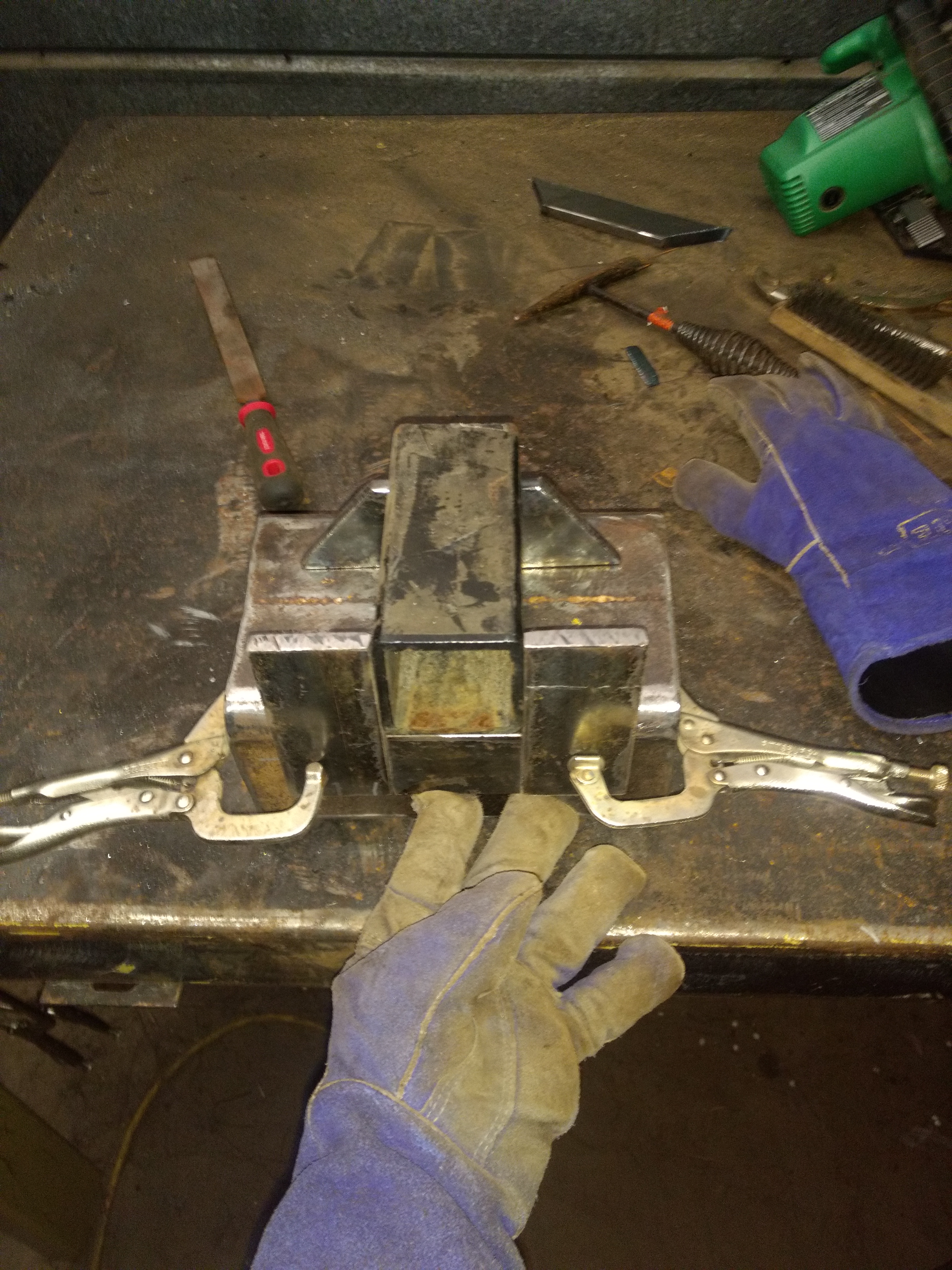

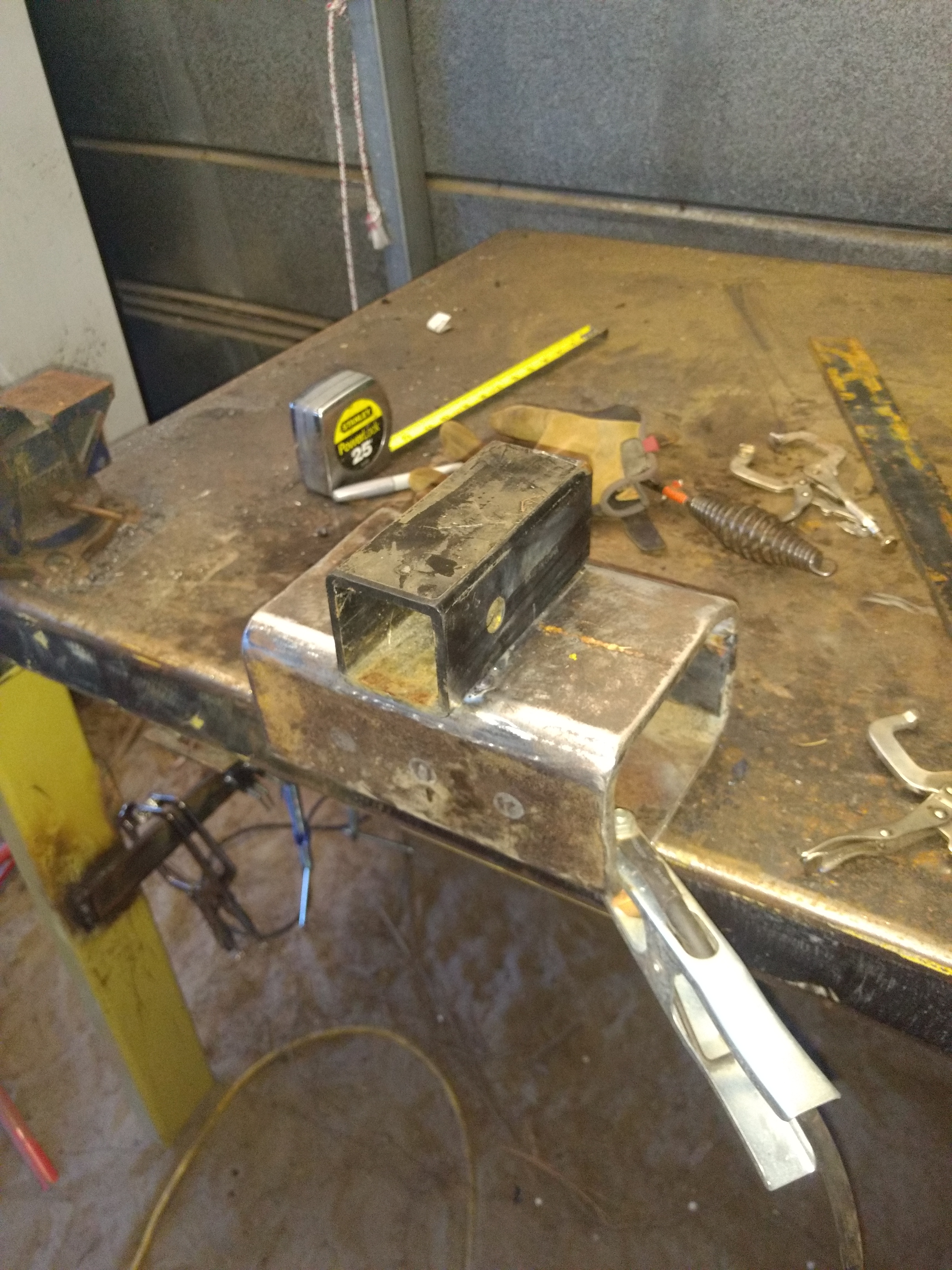

Nice work. Plenty strong for a hitch on a tractor that size.
When using for retrieval abnormal forces can be exerted. Your reinforced back wall will greatly strengthen where the hitch bolts to the tractor. At a glance it appears the weakest spot now would be vertical stress. A square tube laying horizontal has very little resistance to such a force. Triangles are needed for that. The hitch will never tear loose from the square tube. Hopefully that bracing will add some strength to stopping the "square" tube from becoming a "diamond".
Definitely build a shackle receiver and keep a threaded clevis installed for retrieval useage. Try to avoid using a ball hitch for retrieval.
Great job!!!

Some great & sound advice in here guys thanks. I may just drill the holes and add slots eventually. I've thought about many scenarios, I think I'll leave the top alone for now.
I ordered my hitch since I couldn't find one I liked locally. Solid receiver, 4 pin holes in the receiver to flip it, and claims 40k lbs + break strength. I should never see close to that.
Great job!!!
Yeah I'm hoping I never have to see the abuse it will withstand, but I got stuck not long ago with 5 tons of lime behind me so it saw some stress that day and I knew what I wanted to try and build it to withstand. I tried bracing the front of the hitch up enough it would take some side force without pulling off.
I did think about coming behind the front plates I braced it up with and adding in a triangle from the backside of the plate to the bumper to add more strength against straight forward pulling force, but after finishing welding everything up it looks to be more than plenty.?
I did notice I made one mistake (to me) in the strength department. When I welded in my hitch I have the hitch pin hole forward instead of it being flipped and the pin hole farther in the back. This is going to make the receiver only go about half way into the hitch instead of full length. No huge deal, but going for max strength in this I feel like I missed this one. When I ordered my shackle hitch I did make sure to order one with the most hitch after the pin hole to hopefully help fix my mistake.

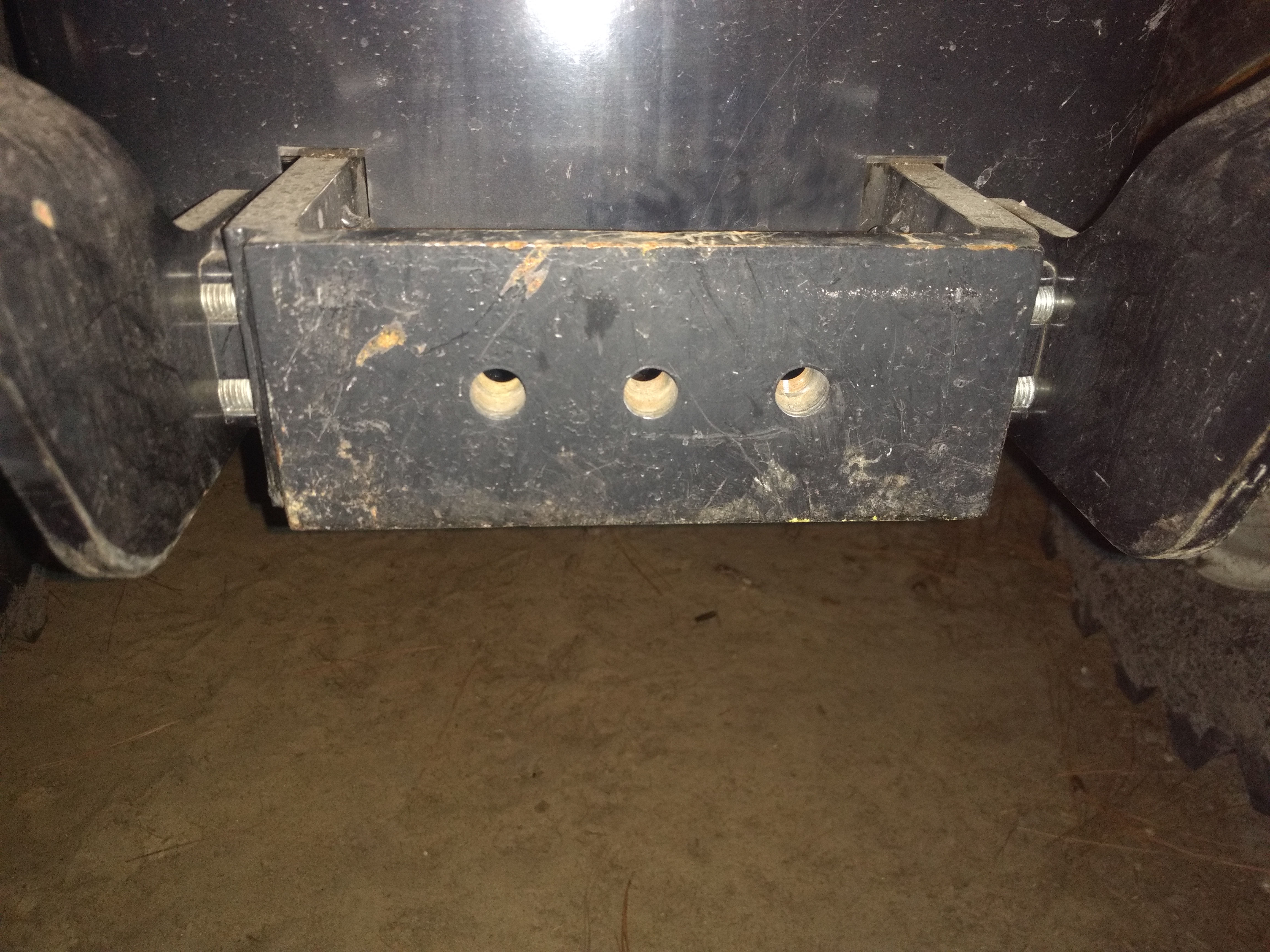

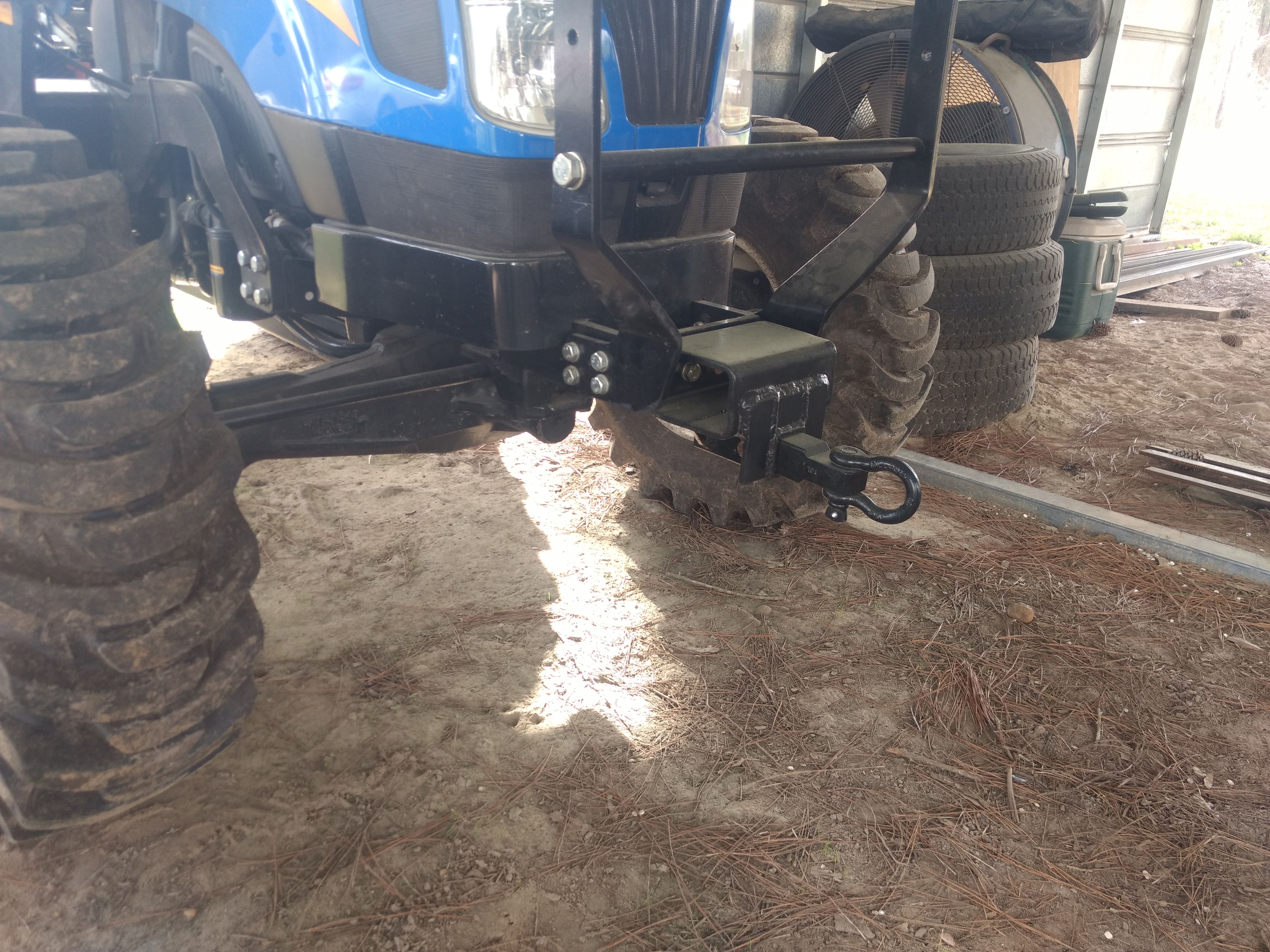

I've been absent awhile and finishing the job. We had our first kid, wasn't the easiest journey getting him here or since he's been here, but it has been a blessing. Anyhow, I haven't finished the grill guard but I did get the bolts ordered and recovery bumper bolted up finally. It's pretty stout so it should handle it's purpose I hope!

That'll do Bman! It's nice to have that 2" receiver up front.

Just so you don't beat your self up over missing a stress point, where you could have made it stronger, remember that if you design it where it won't break, then all you are doing is transferring the weak spot into a more expensive part (on the tractor). If you subject the stuck tractor to a load to pull it out, and it won't move, and you keep increasing the pull, hoping it will come out, eventually it will either come out or something will break. What breaks, and what it costs is your concern. I saw a very large wrecker pulling on a stuck tractor once, and the wrecker driver just kept pulling...and eventually something came out, but it was only the front half of the tractor. It broke the tractor at the bell housing. I had suggested that they disconnect the loaded wagon from behind the tractor, but the wrecker driver "had 30 years experience" so I was ignored. The tractor owner later told me that he wished he had stopped the wrecker driver. Hindsight is 20/20.
