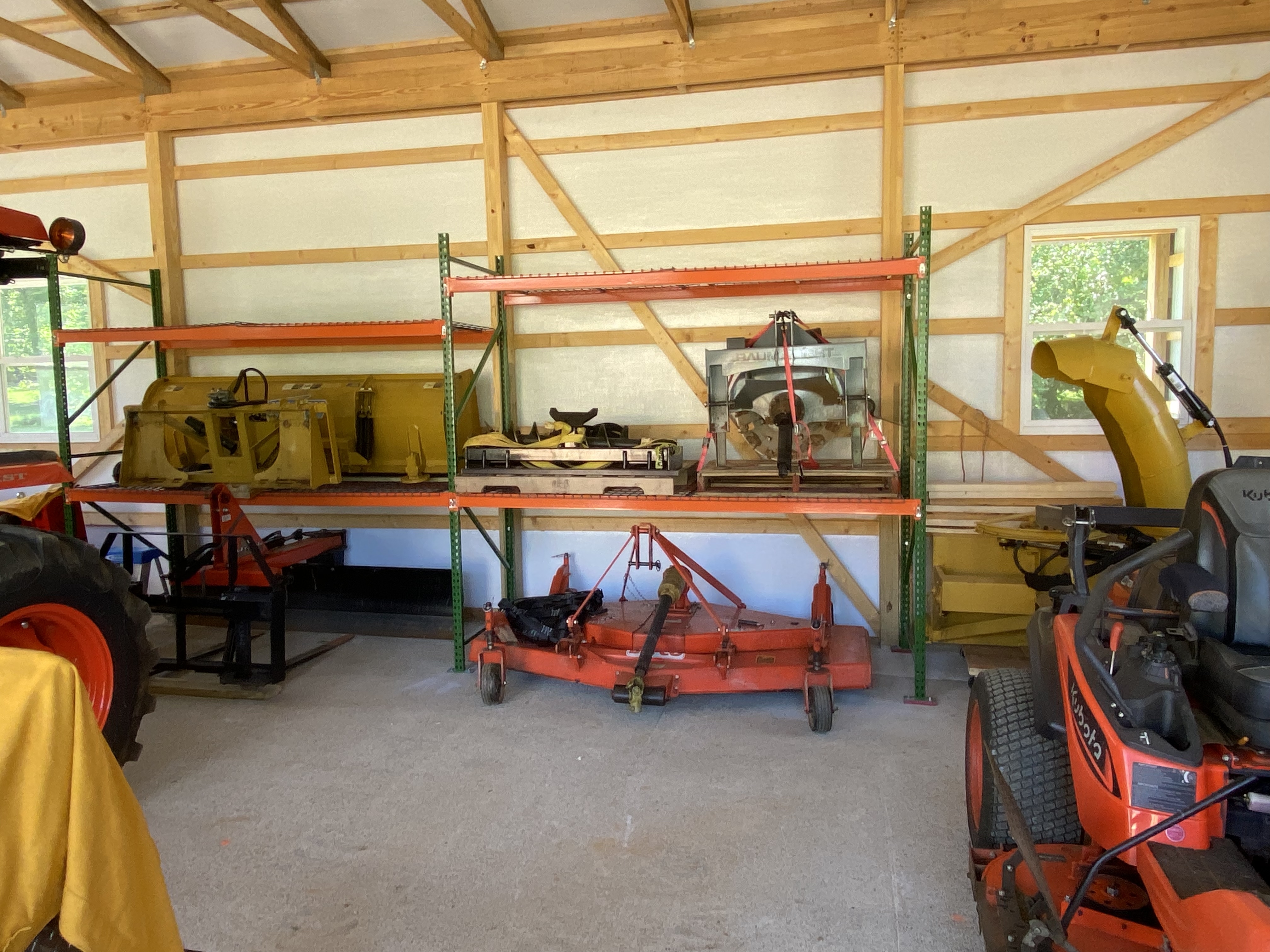

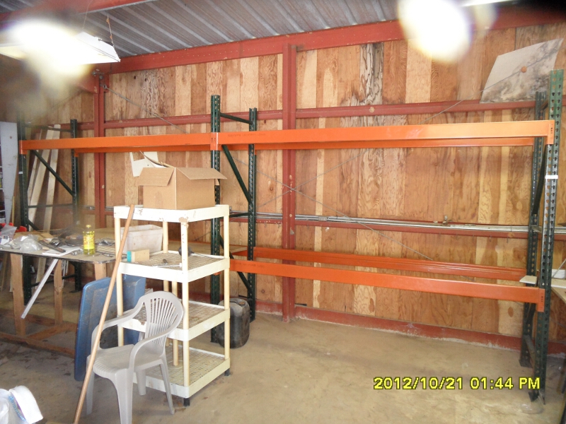

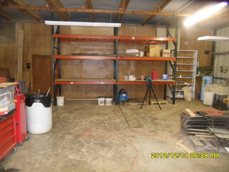

OP -
Have you looked into pallet racking?
It's basically "Tinker toys for big boys".
Good clean used pallet racking can often be found for a fraction of the cost of new. You can store HEAVY stuff easily.
You can build a frame for your 12' ceiling, put 4 beams at top, hoist your equipment to the desired level. Then put beams underneath.
And if you change your mind it's easily reconfigured.

X2 on pallet racks. I recently put two 8' x 8' sections in my new barn with 2 shelves each, plus 2 extra shelves. They take 1600 lbs per shelf section, which is way more than I need.
To me one of the advantages of pallet racks is that with the basic setup of 2 uprights and 4 beams I can swap in thicker beams and hold up to 3 ton+ capacity per beam level, which is small car capacity.
