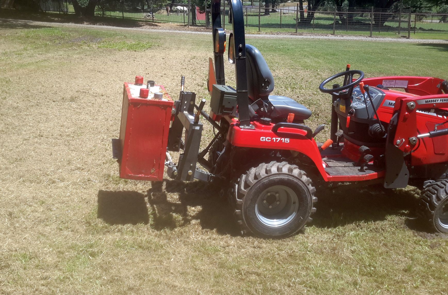

Check owners manual, mine has a some what dubious wording on how to calculate needed weight.... I simply made a steel box out of angle iron and flat plate and set it up to match my CAT 1 QH... Box is 2x2x1 feet (4 cubic feet) and weigh in maybe 600 pounds (in some cases it may be too big for tractor size) .... By all information gathered on i-net concrete weighs in at about 150 pounds per cubic foot....
But the are other options, may be cast iron bar bell weights.... Actual tractor "suit case" weights, maybe old engine block, box of rocks...

Caped off tubes (spray can tops) are ABS pipe inserted all way to bottom as tool holders...

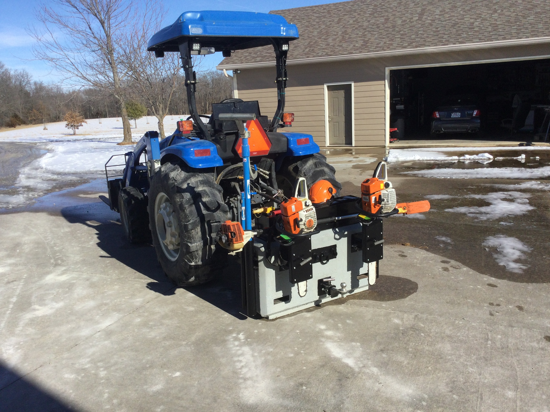

I ended up using approximately half of my tractors 3 point lift capacity on my ballast build. My New Holland TC45D has a 3pt rating of 3275lbs at the pins and 2330lbs at 24” behind the pins. I chose a target weight of 1500 -1600 lbs with a center of gravity at 12” behind the pins. A key factor was I wanted to be able to move the ballast around with loader/pallet forks. The capacity of tractor’s loader (NH 16LA) is 2317 lbs at the pins and 1759lbs at 24”. I can safely move it around
with my 550 lbs box blade on the the 3 point and 600 lbs of cast iron weights on the wheels.

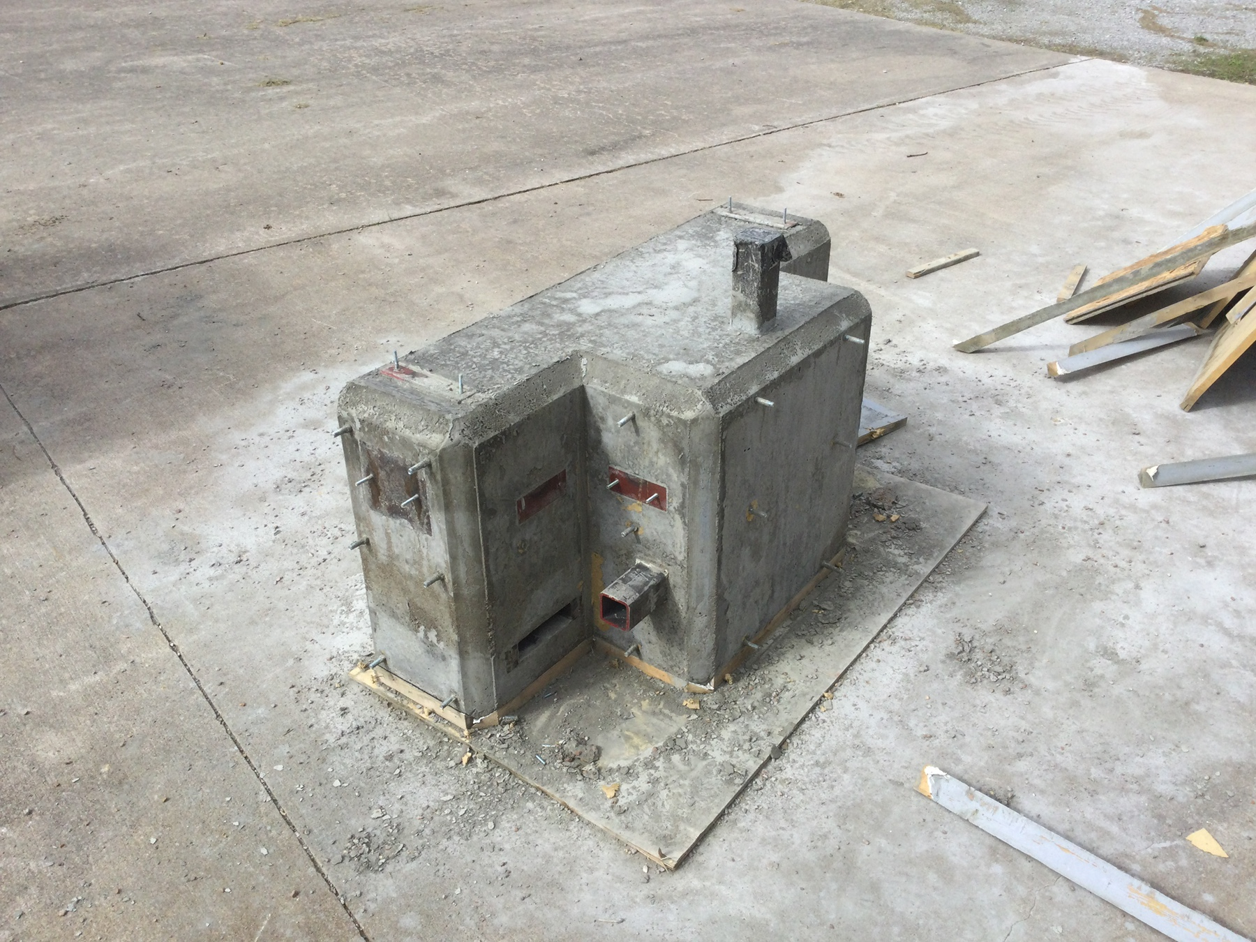

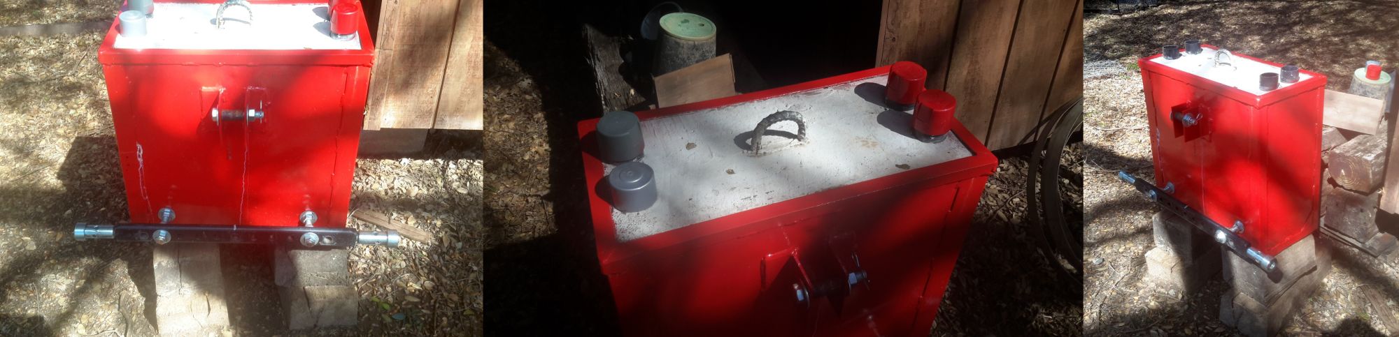

Finally got the weight poured yesterday. Will wait another day or so to try it out, then paint the metal parts (should a done that first). Weighs in right at 600 lbs. Center of gravity is about 2 inches behind the pins. I've got a 2" receiver embedded in the concrete also. Fabricated an extended pin in order to be able to lock the hitch in place. 20220726_160815.jpg20220726_160835.jpg

Sorry, these didn't get uploaded the first try. All the metal parts are welded together except for the top chain hooks. Planning to build a plywood box on top yet to hold chains, gas can, oil can etc.

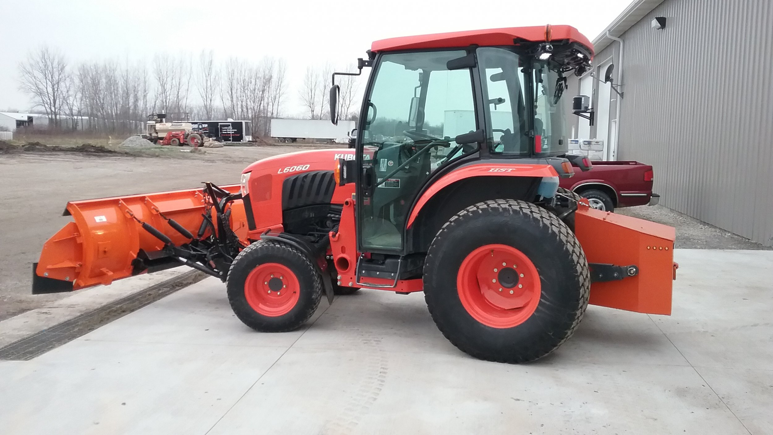

When I was deciding on an upgraded tractor - I considered a weight box on the 3-point. But a weight box DOES nothing. Instead I went with Rimguard filled rear tires ( 1550# ) and a 1000#+ rear blade.
These two upgrades successfully handle the total lift capacity of my FEL and grapple. I can lift and move 3000#+ with the FEL and grapple.
I have 80 acres and a mile long gravel driveway. I'm not limited by confined spaces.
