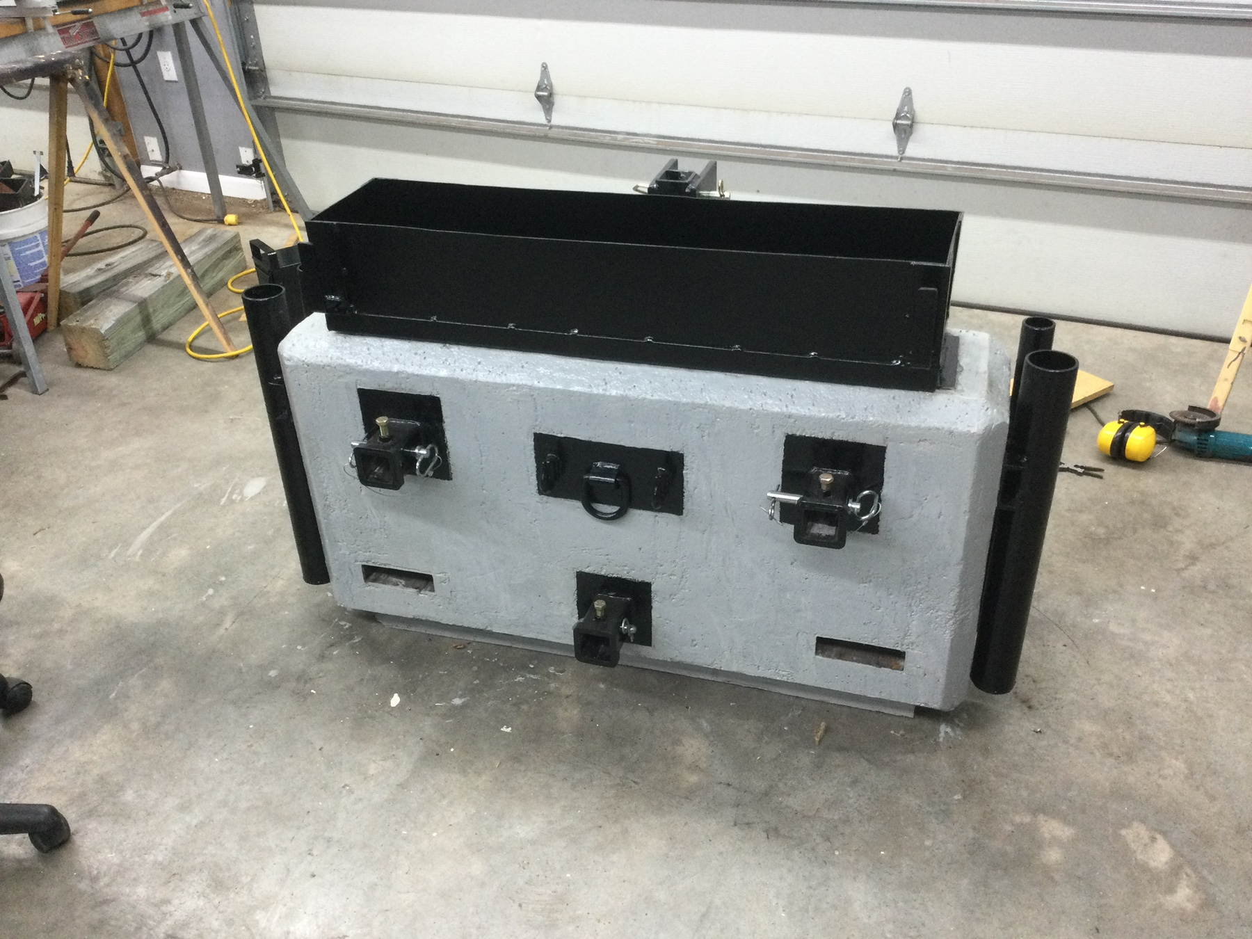

3pt concrete ballast build for logging/firewood

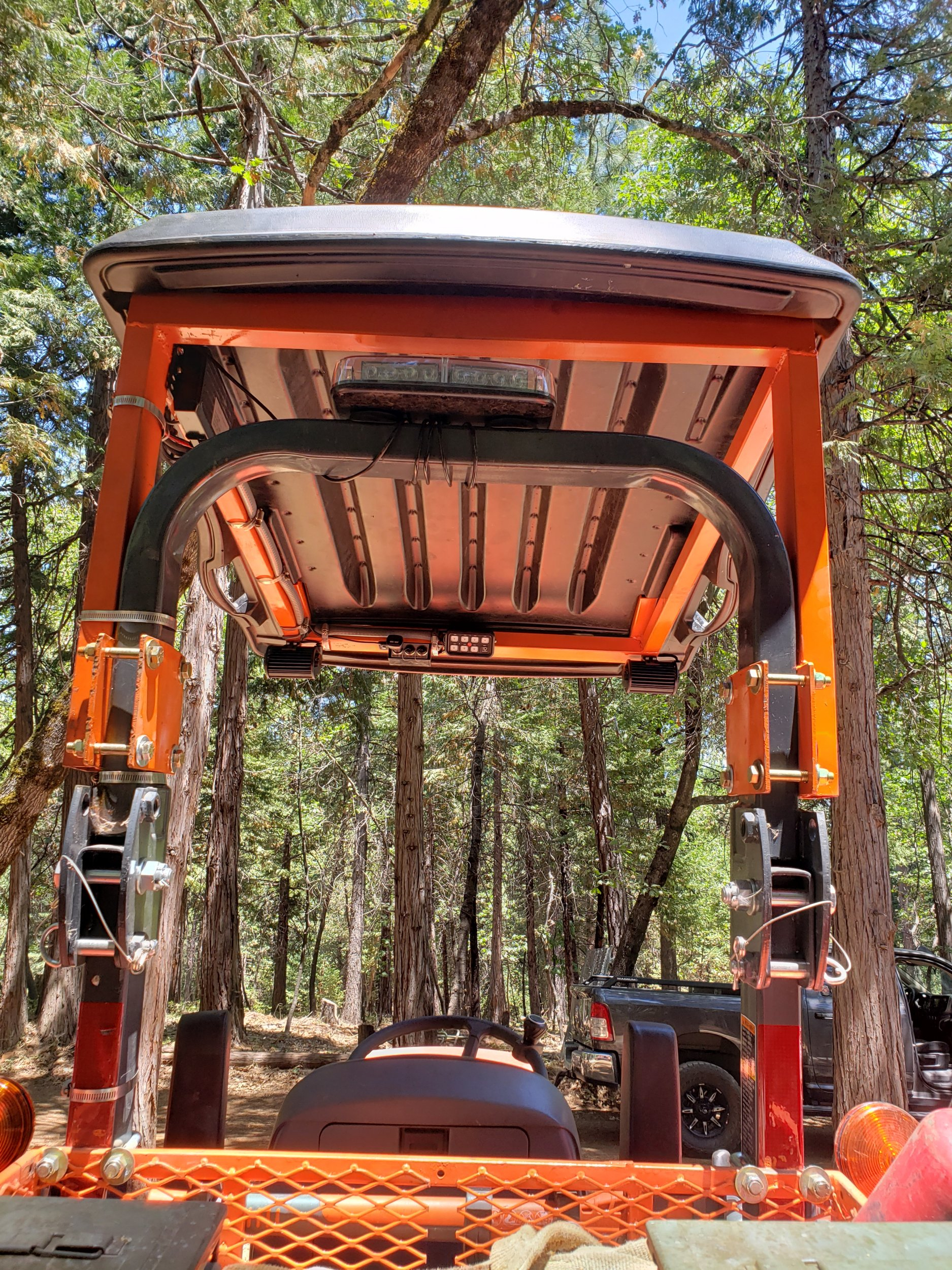

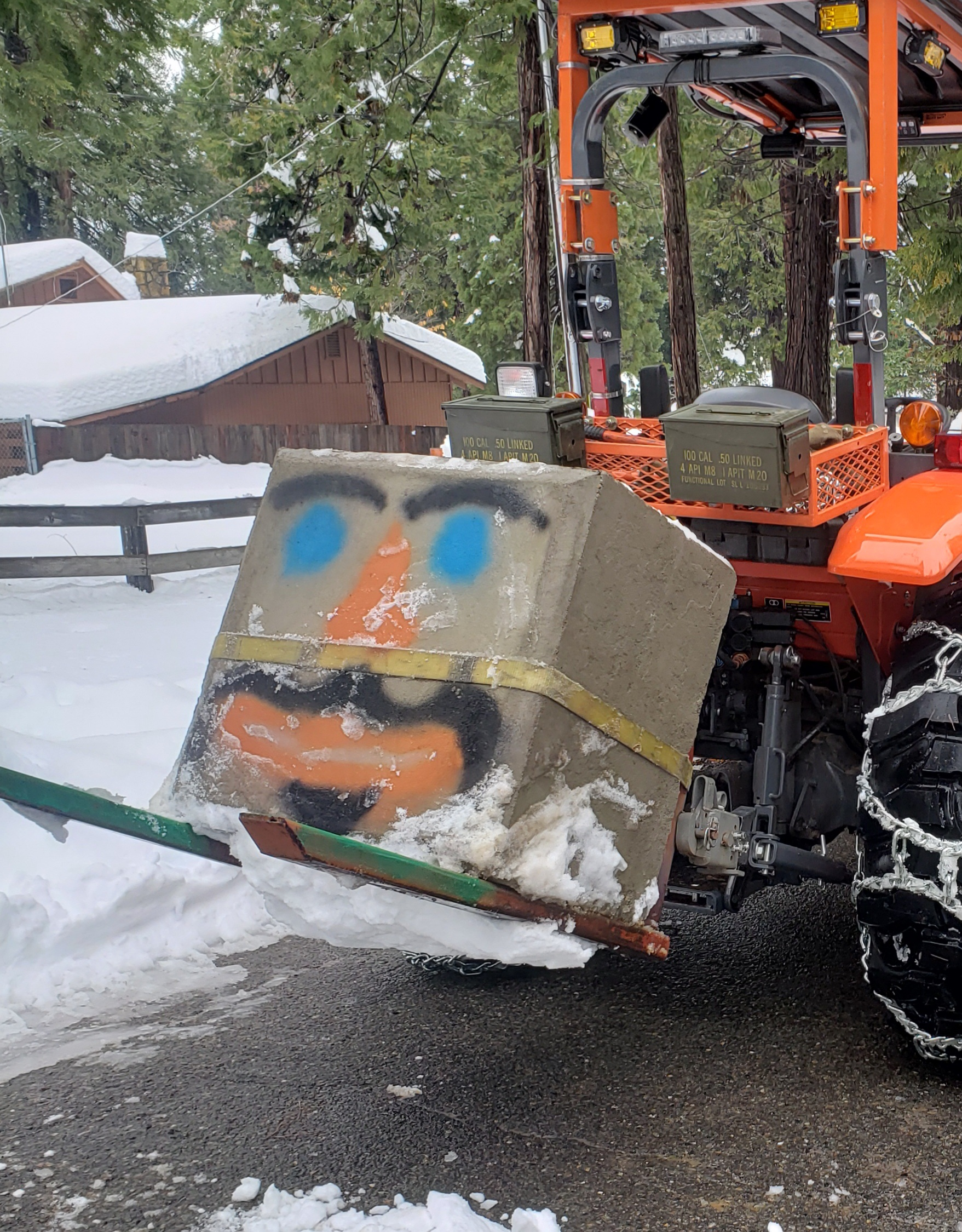

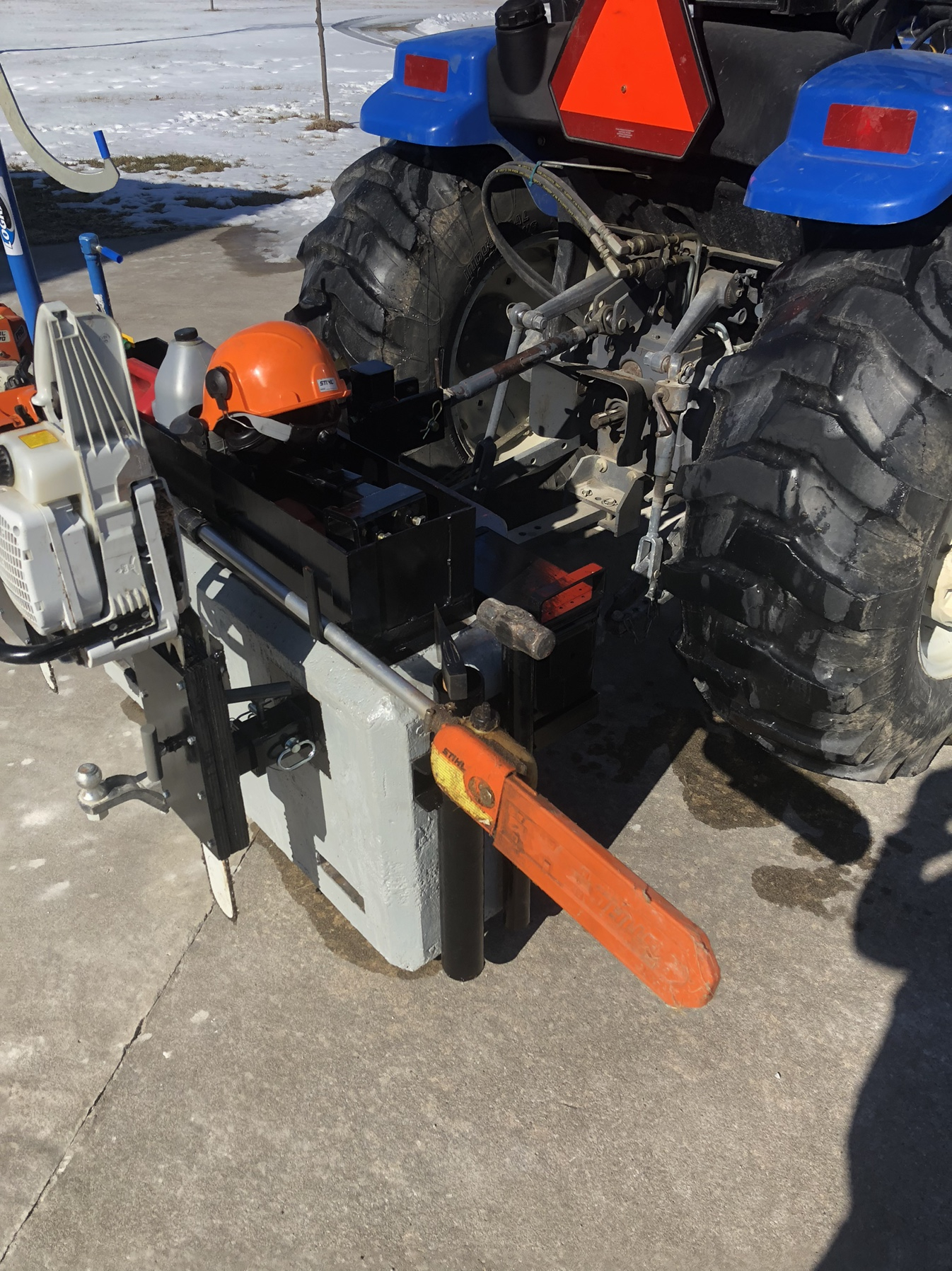

Loaded up and installed on the tractor
/ 3pt concrete ballast build for logging/firewood #22
Wow. That is quite a piece. I figured you would mount the pole saw vertical; if that were mine, I would snap it on a trail-side tree right quick.

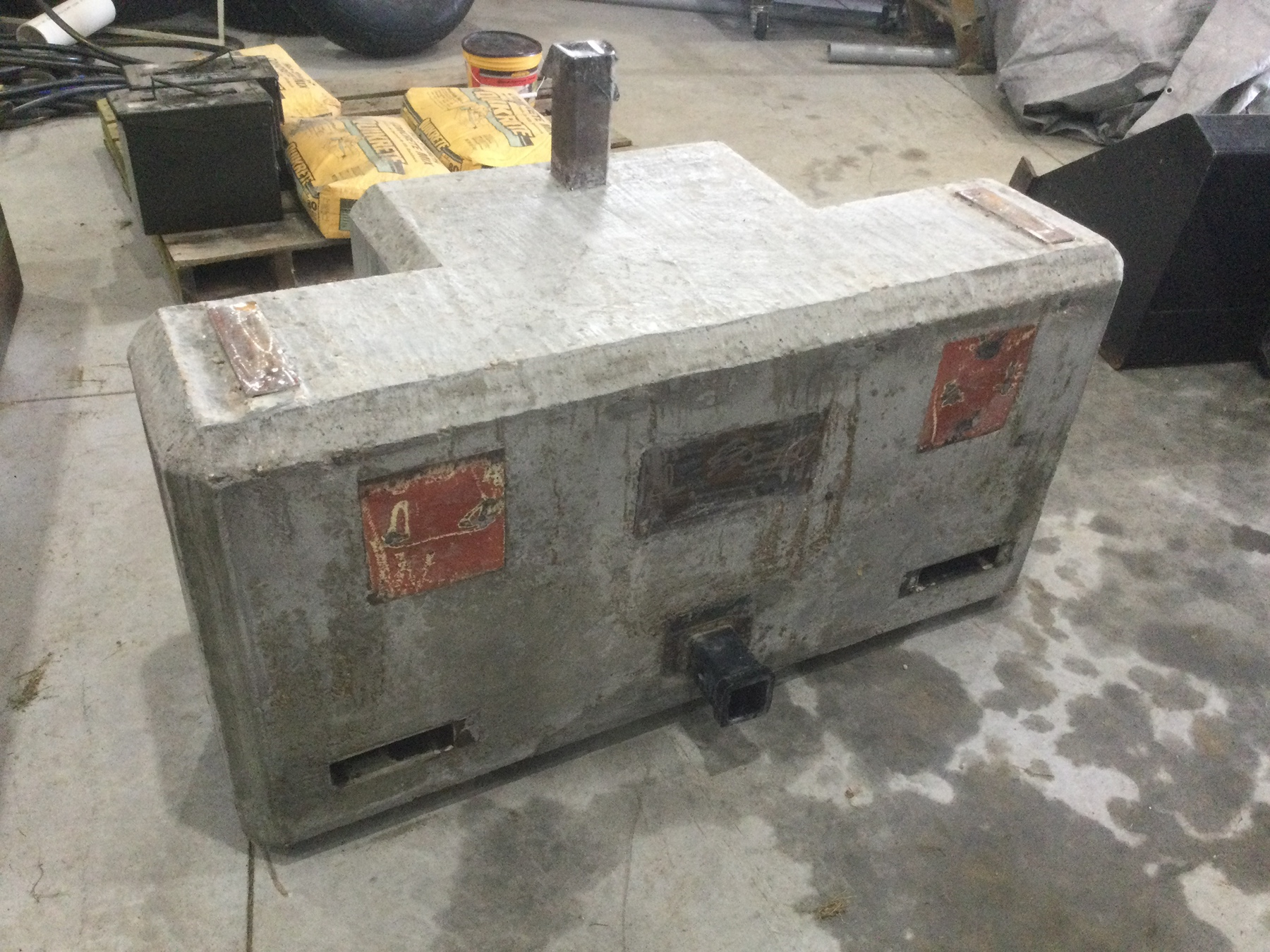

/ 3pt concrete ballast build for logging/firewood #25

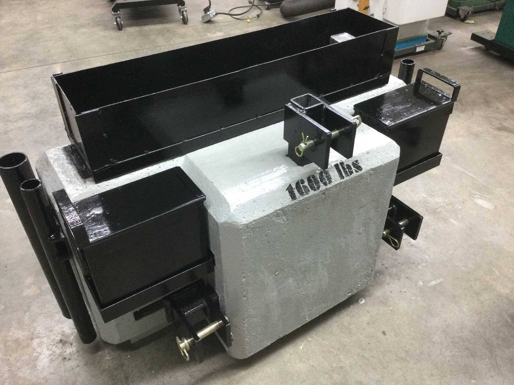

I got mine from the local batch plant. $35. After this pic was taken, I cut off the excess forks and welded in a piece of channel with a receiver welded to it. I got the 3 point forklift off C/L for $50.View attachment 733085

Looking slick, inpo.

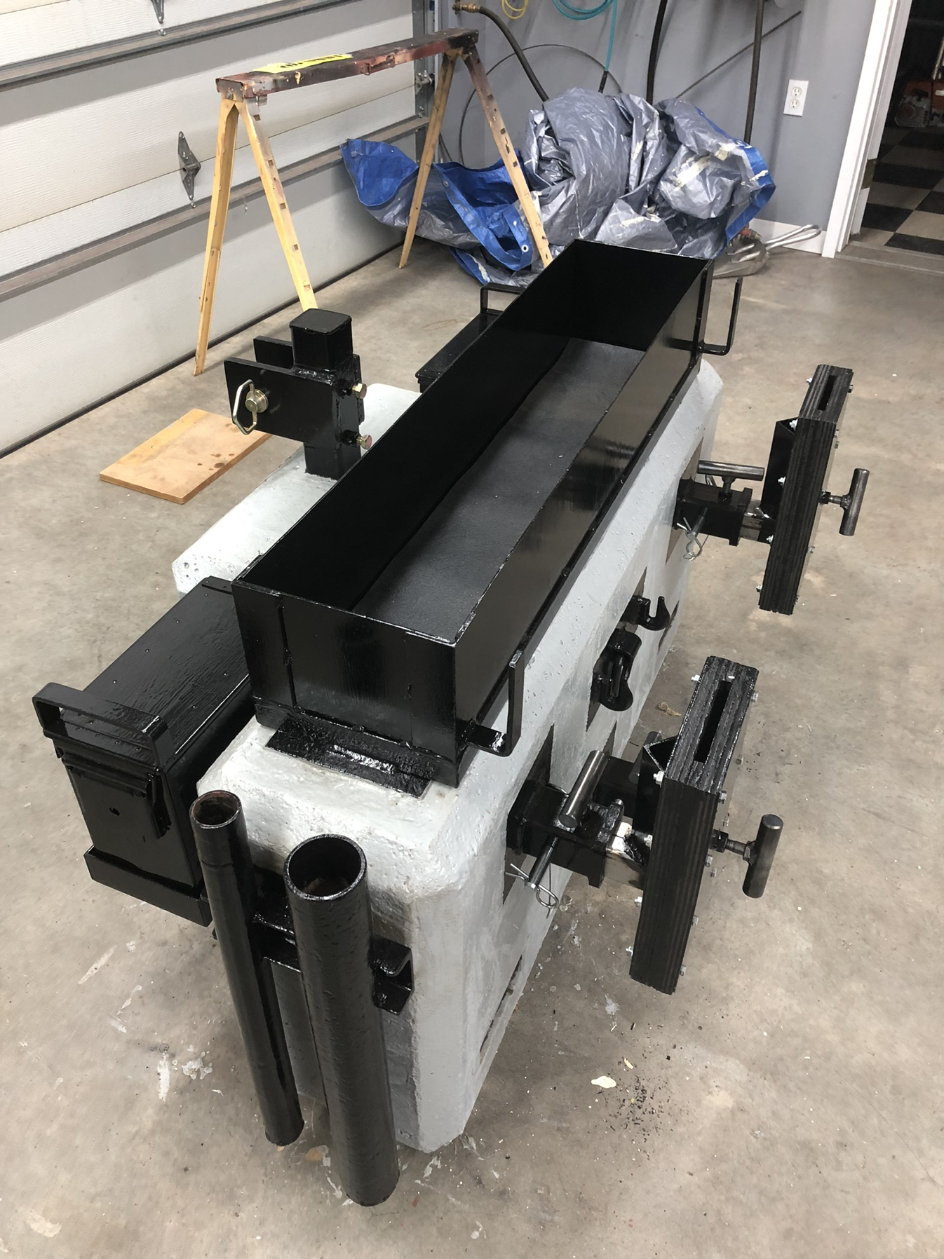

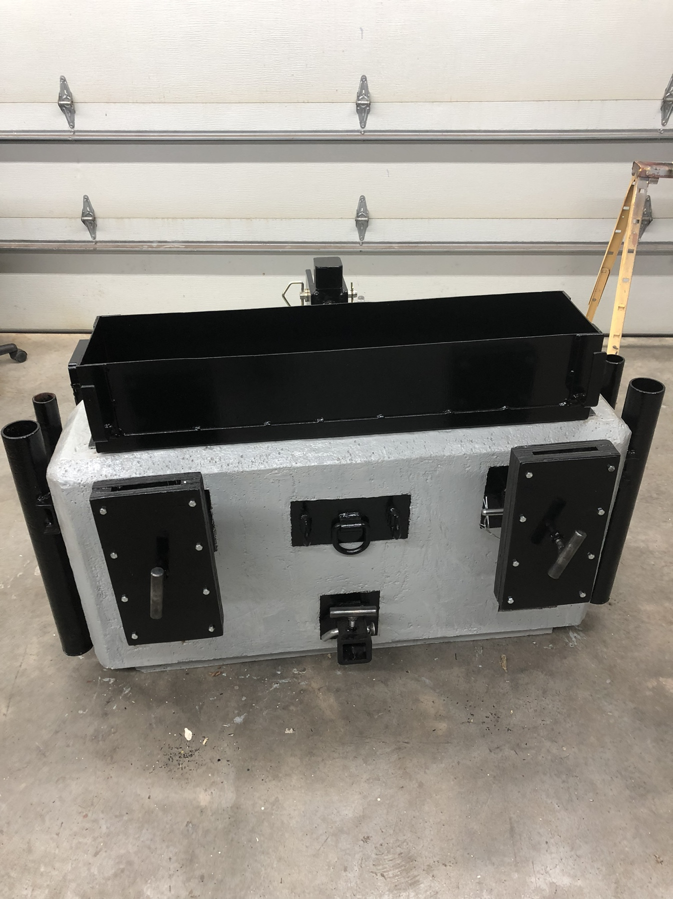

I'm very curious to see how you will mount the vise and tire changer, and tool carrying setup.
The vise mounts on the vertical tube of the 3pt using a receiver fixture that replaces the cap. The HF tire changer has a section of 2” tubing welded to it and gets plugged in the receiver hitch on the backside of the ballast. It’s held tight by the pinch bolt on the receiver.

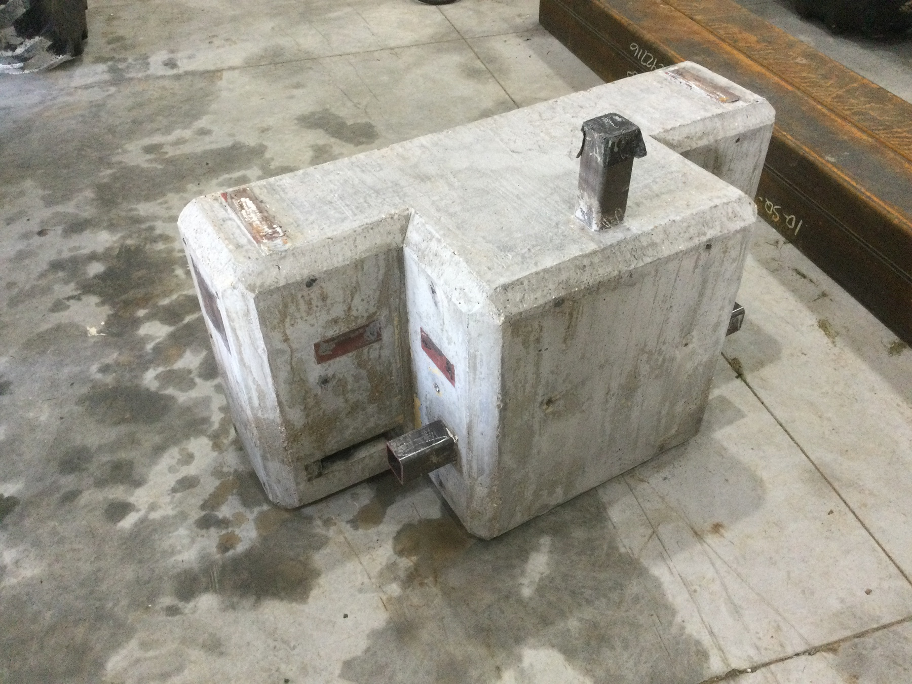

/ 3pt concrete ballast build for logging/firewood #38
Imron paint?

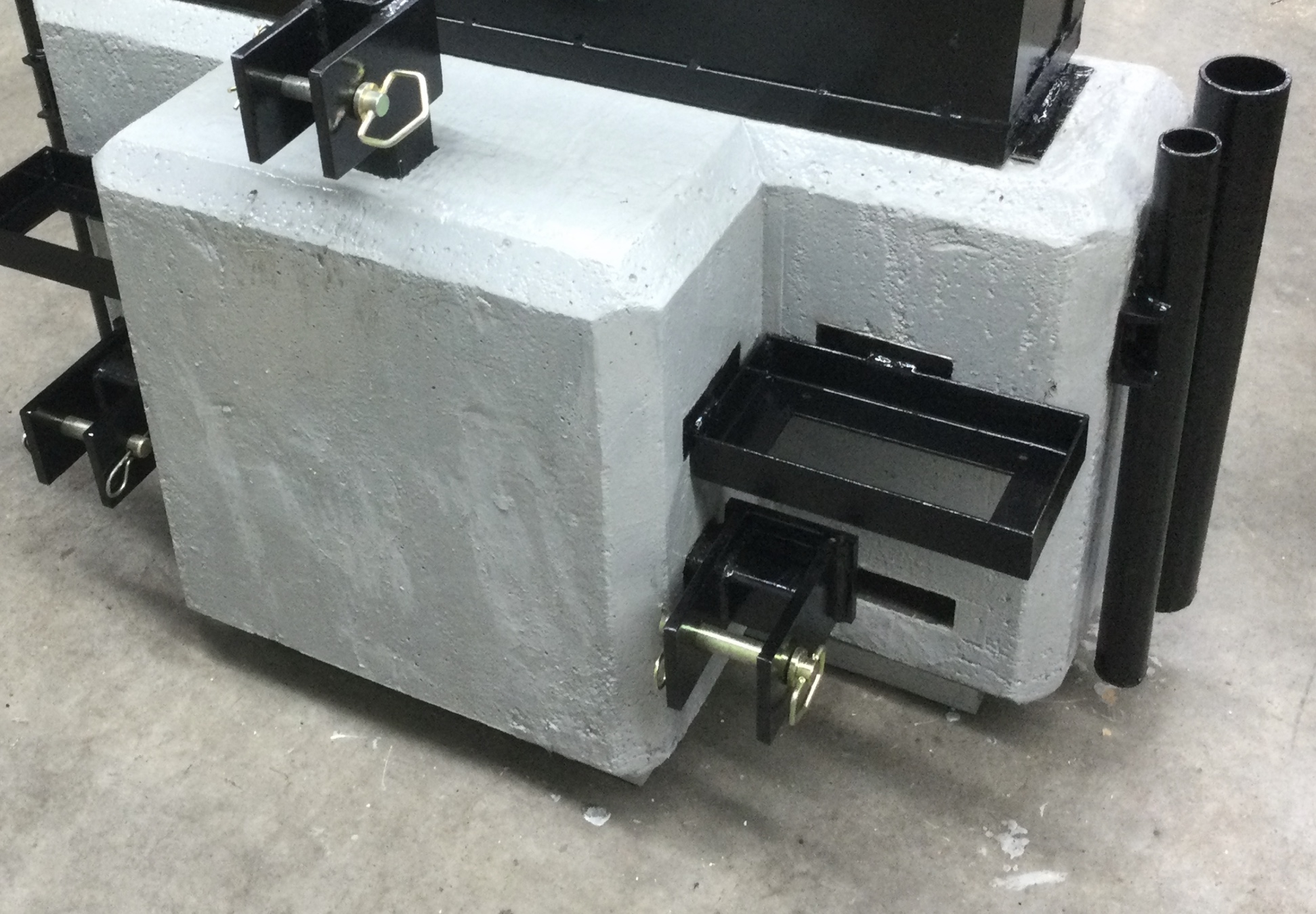

I was a bit confused. I thought you added to the original cement cube. You used the forks but started over with the cement. I was wondering how you anchored the accessories to the origin block. Nice setup
#40
that is quite impressive. how much time do you have invested?
I could not even estimate as it was just a fun project that got worked on when I felt like it with no particular schedule on getting it done. I did let the concrete sit for two months to allow it to cure. The metal work was completed over the course of a couple weeks.
