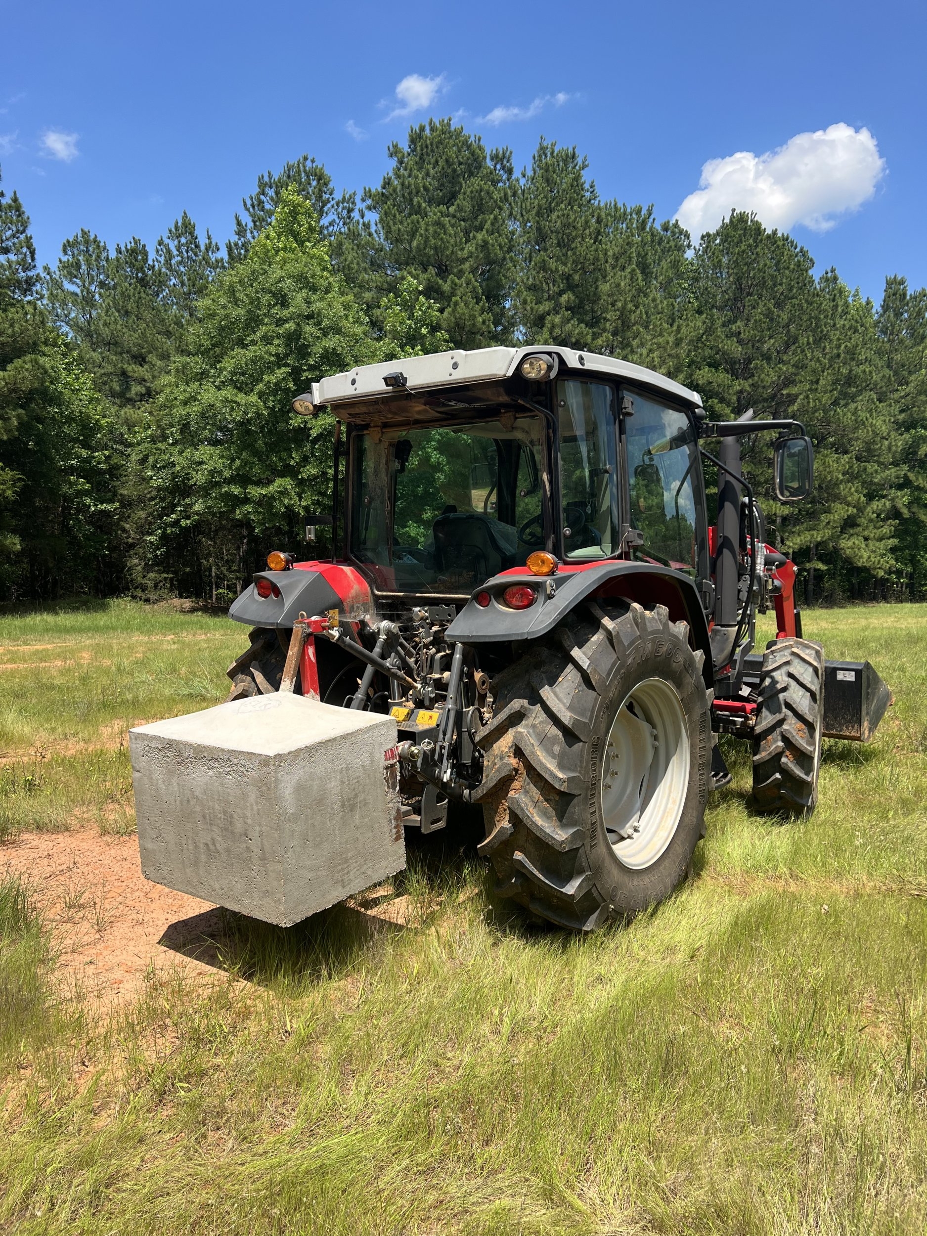

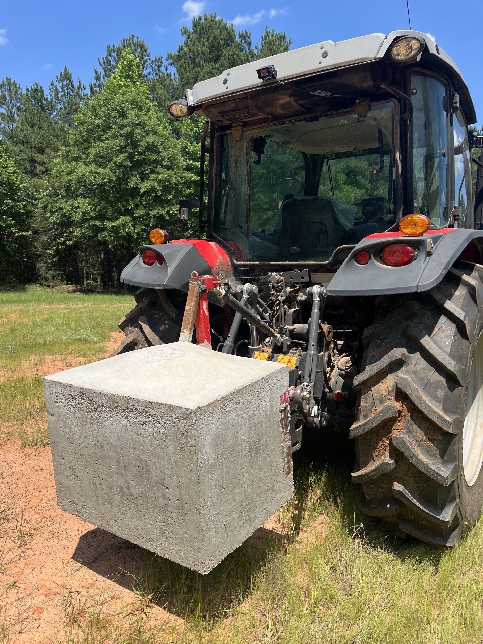

So I'm at home this week with Covid for the 4th time. This time it's not even like having a cold, it's just exhausting and slightly uncomfortable, but otherwise, no big deal. My wife and I have it with similar symptoms. Our biggest concern is doing anything physical that might make us feel worse and extend how long it lasts.
Since I have nothing else to do, I went to Calculate Bags of Concrete Mix - Round Square Footings Holes Slabs - Inch and punched in a variety of measurements to see where I could get to 2,000 pounds using 60 pound bags of concrete.
It looks like 2 feet wide, 2 1/2 feet deep, and 3 feet tall will give me a total weight of 2,040 pounds with 34 bags. When I buy a pallet of 56, I get a bulk discount and my Military discount, so that's what I'll buy. The rest will get used for fence posts, or under fencing to block baby goats from getting into the chicken area and eating all their food. Nothing is better at getting through fencing then baby goats, and they never give up trying to get to the chicken food!!!!!
Amazon sent a message that the 3 point hitch was delivered today. It's at my front gate, 800 feet away. I'm too tired to go get it right now, I'm gonna wait until the mail is delivered and do it all in one trip.
I have some scrap plywood laying around, but I'm not sure if it's enough to build a form this big. Before I build anything, I'm going to hook up the 3 point hitch to my tractor and confirm my measurements. I could make it a bit bigger, but I think this is what I'm going to shoot for.
In case you don't already know, Brace around it with 2x6 boards overlapping and bolted together at the corners with the 2" edge against the plywood or the concrete will push it out of shape and possibly bust out. I used 2 rows of 2x4's since mine was only going to be about 1000lbs and it still bowed just a little across the back but doesn't matter or affect anything.

Thank you. I looked at it yesterday and I'm a bit nervous about all the weight of it being held up in the air, while off roading around my land, by the two tabs of metal welded to the frame that will support the concrete. I'm going to weld on some more metal to it so it will be stronger before building the wood frame. Is there such a thing as too strong? I have some scrap, so it's not going to cost anything, and with the ground getting so muddy from the rains, it's a good project to work on once I feel better.
I agree with wrapping the plywood frame with lumber. It's easy to unscrew too much lumber, but hard to add it when something goes wrong!!!!!
