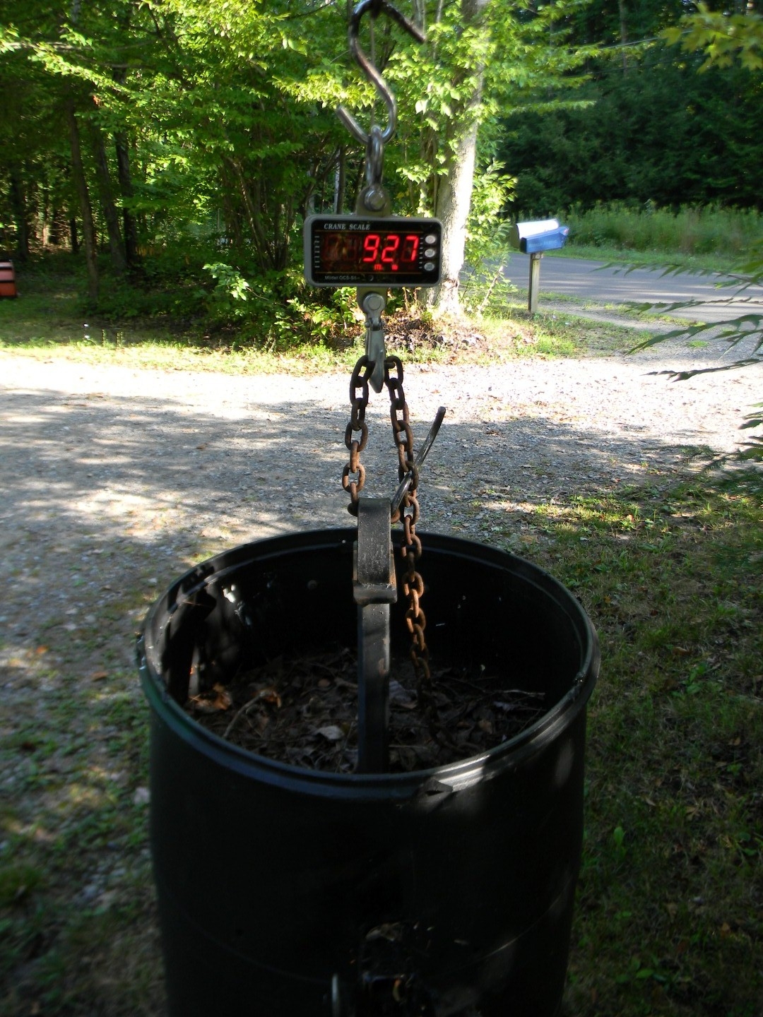

Have you thought about a plastic 55 gallon barrel? I built mine fairly easy and filled 3/4 of the way it weighs 927#. I'm sure if I had filled it with concrete it would about 1K or more. I also obtained an old records safe for free when a Dr. office moved and didn't want to pay to move it. It is concrete lined and weighs over 1K. I just had to weld on some lifting points.
/ Rear Ballast Weight DIY Build

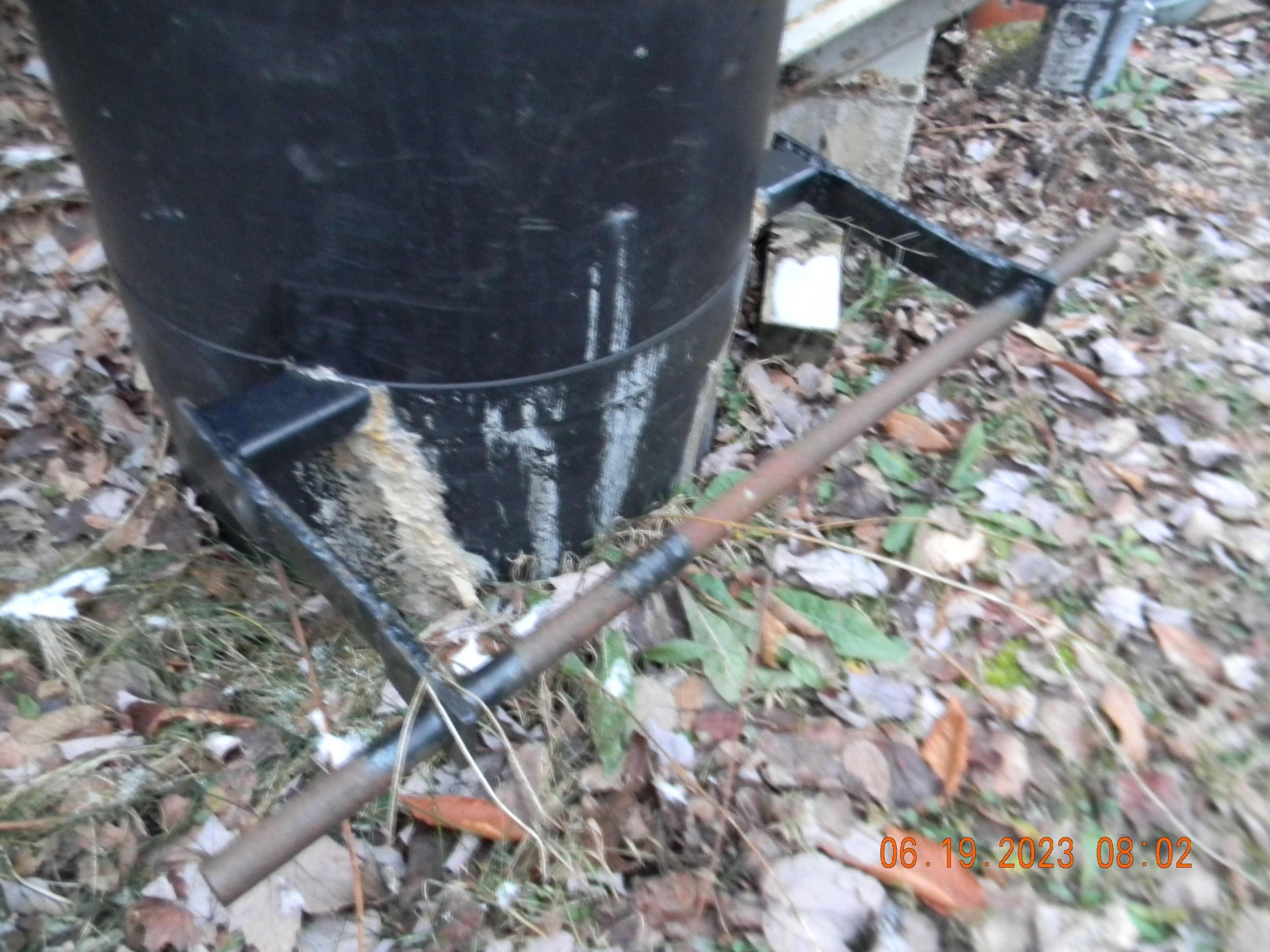

How do you attach the barrel to the tractor?

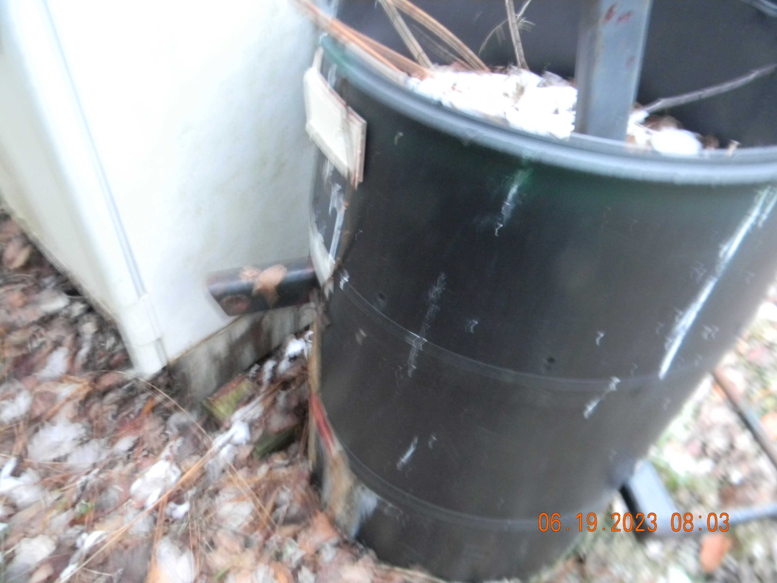

I built a steel frame inside the barrel using scrap rectangle tubing, a piece of 1" bar stock and came out the front for the top link. I also added more steel out the back and added a hook for a chain. Sorry for the blurry pics. Its cold out here and I must have been shaking a little. Don't pay attention to the dates. I didn't reset the camera.
