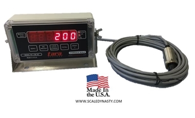

That’s good to know. This scale is electronic and “t” s into hydraulic line.
Look familiar?

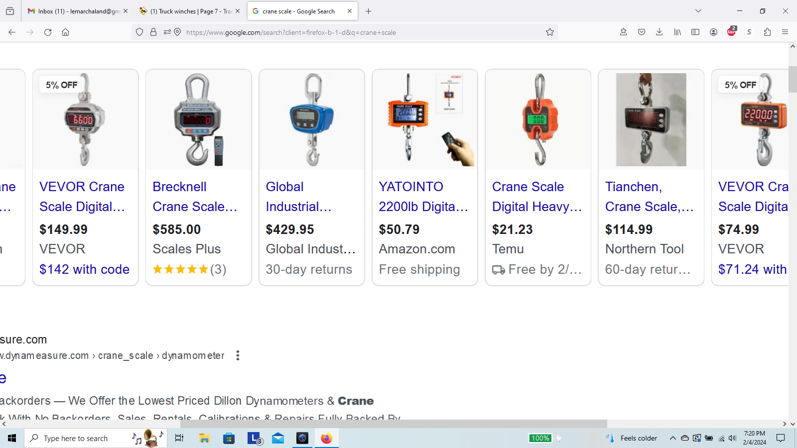

The hydraulic weigh indicators that tee into the hydraulic system are just measuring hydraulic pressure and are being scaled to indicate in pounds instead of psi. Once configured and calibrated correctly they will provide a consistent weight indication. However that indication will only be accurate at the height and angle of the bucket or pallet forks that the calibration was performed at and on. Depending upon the position used for calibration the accuracy is quite an S curve with only one close to correct spot. And a bucket will not read the same as pallet forks and changing buckets will also effect the results as will how the bucket is filled and leveled. They work good for dispensing material out of super sacks held in a consistent height.
If trying to weight bagged or palleted materials the crane scale type indicators are more accurate;

Once calibrated with the spear, using the spear in the same position as calibrated you should be good. One way to calibrate would be to weigh three bales on a good scale individually and mark the bales weight, bring them home and calibrate using them as transfer standards. Then vary the order you spear them in and see how much the weigh seems to change.
added; also you will be able to see how much the indicated weight varies depending on the angle of the spear and the height of the loader arms.

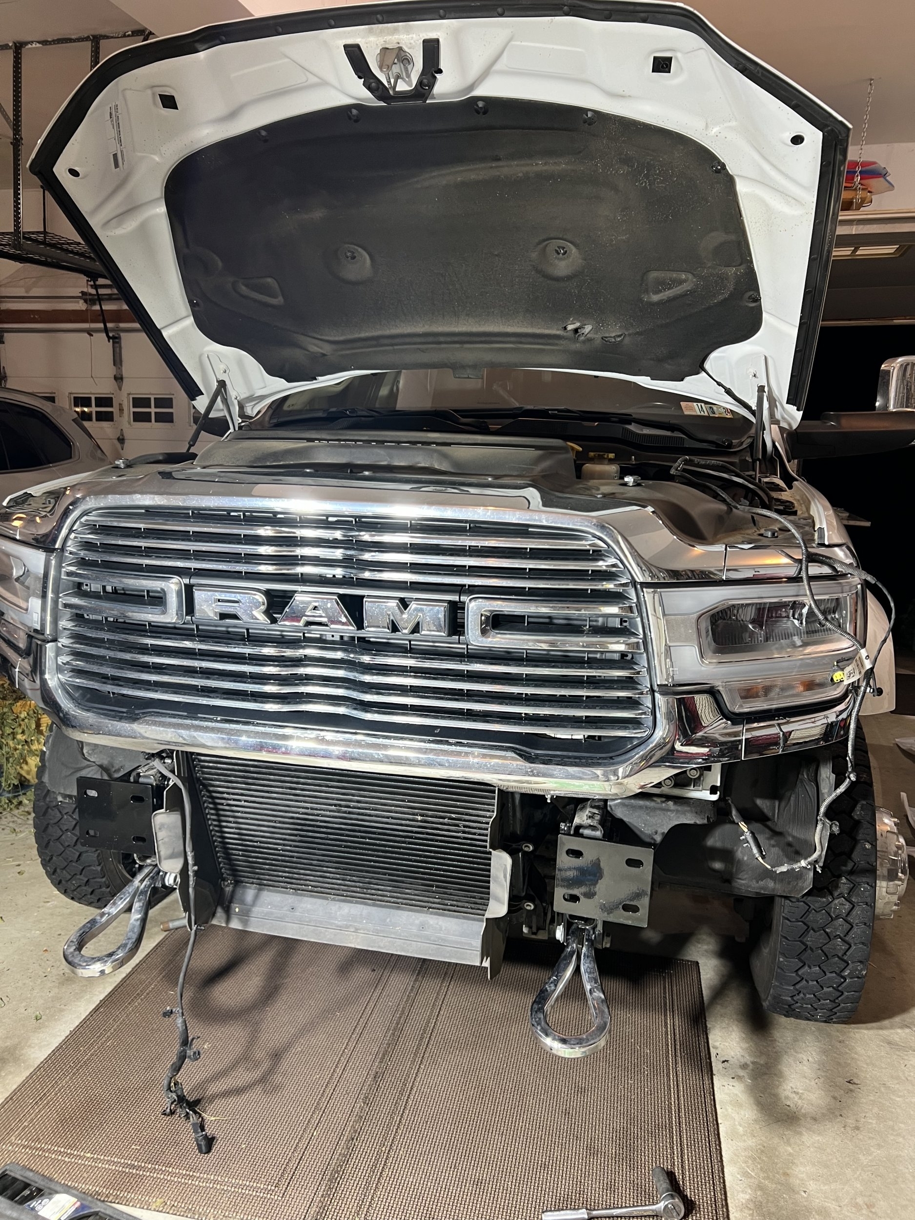

The Ramsey is a basic 12V electric I found on FBM. I want to keep it simple on the Ram, even though I have a PTO on the side of the Aisin doing exactly nothing.
Would like to utilize it, but I have my $ limitations.
I would think a hydraulic pump, tank, lines and winch would be over 5 grand.
Although much nicer, it’s not worth that much over a Ramsey or Sherpa 12V.

I’m more stuck between buying the Ramsey 15K @ $1,000 versus a new Sherpa 25K @ $2,000.
My truck weighs 11K unloaded. I’d prefer a bigger winch, but 15K leaves me 4K for some rolling resistance from being stuck in mud.
Also probably enough for the average 20” diameter fallen log I want to winch out of the woods?
