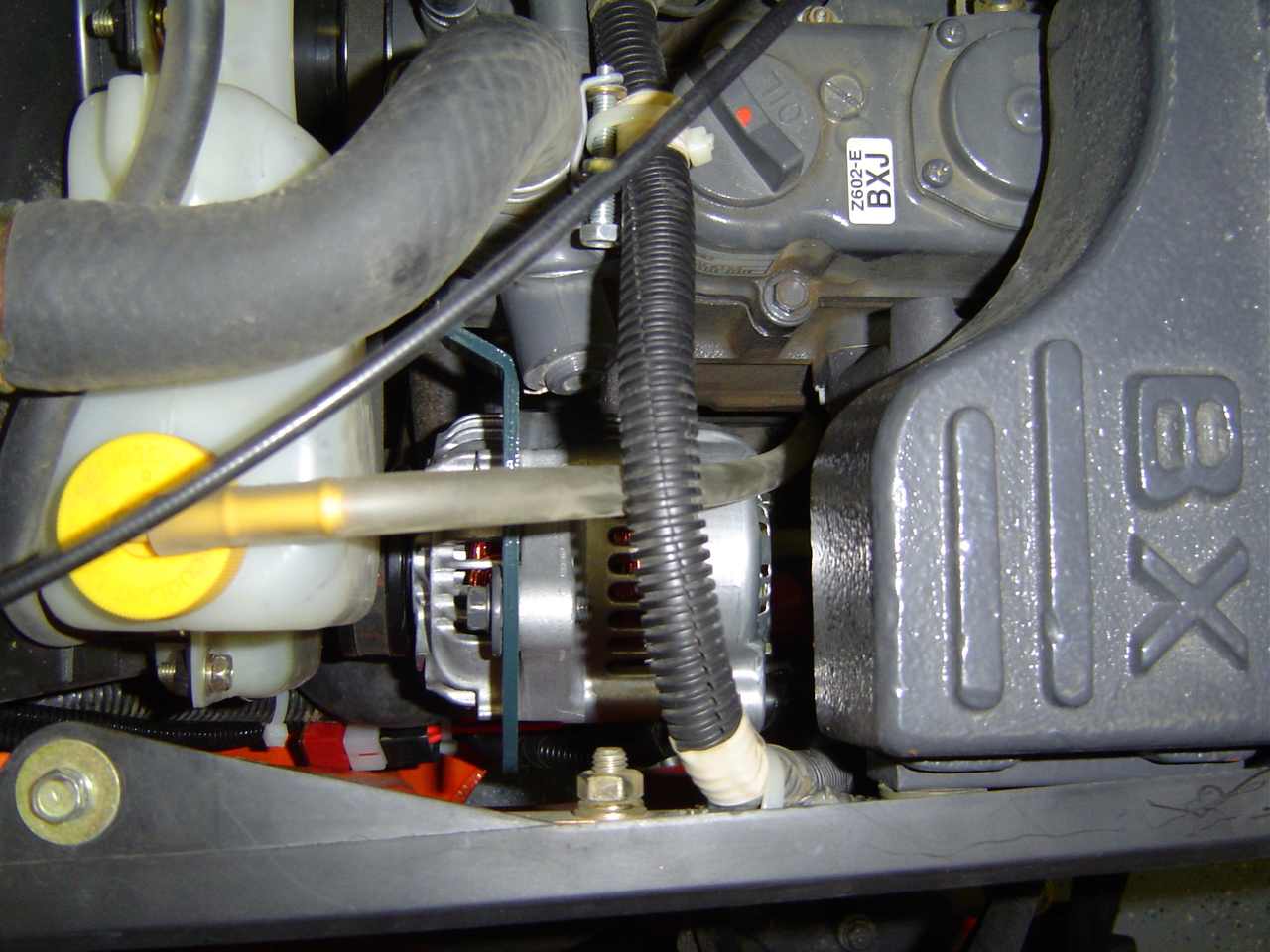

Started out the by upgrading the electrical charging system by replacing the dynamo with the Kubota alternator. Kudos to Charliebrn for posting the detailed instructions at http://www.tractorbynet.com/forums/...7-bx-alternator-kit-installation-project.html.

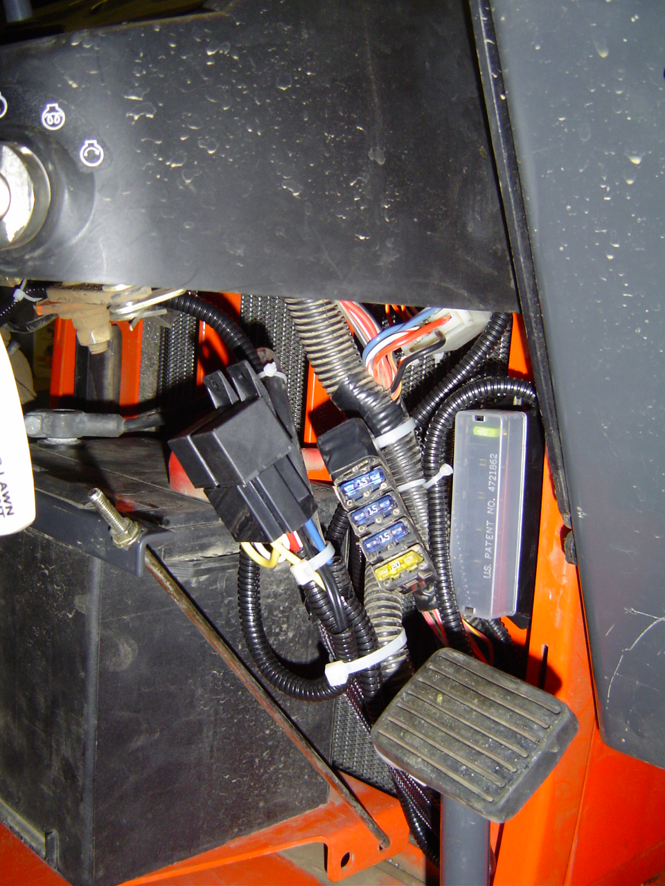

Next, with the help of Mike_C at http://www.tractorbynet.com/forums/...22-mega-lighting.html?highlight=light+project, I started by ordering parts from parts express:
3 060-085 SPST Standard Toggle Switch
3 060-378 Rubber Boot For Heavy Duty Toggle Switch
1 071-340 Littelfuse 3A ATO Fuse 5 Pcs.
1 071-360 Littelfuse 10A ATO Fuse 5 Pcs.
30' 080-523 1/4" Split Loom Tubing
1 100-074 16 AWG Red Primary Wire 100 ft.
2 330-073 12 VDC Automotive Relay SPDT 30/40A
1 330-078 12 VDC Dual Relay Socket
With the abundance of power now available from my new alternator, added a fuse block from Wiring Products at http://www.wiringproducts.com/:
1 6 Circuit Raised Ganged ATO/ATC Fuse Block
Then ordered four halogens from Amazon at Amazon.com: Hella Oval 100 H3 Long Range Double Beam: Automotive
4 Hella Oval 100 H3 Long Range Double Beam

First pic is of the alternator installed.

Next Pic is of the dual relay socket and fuse block installed.

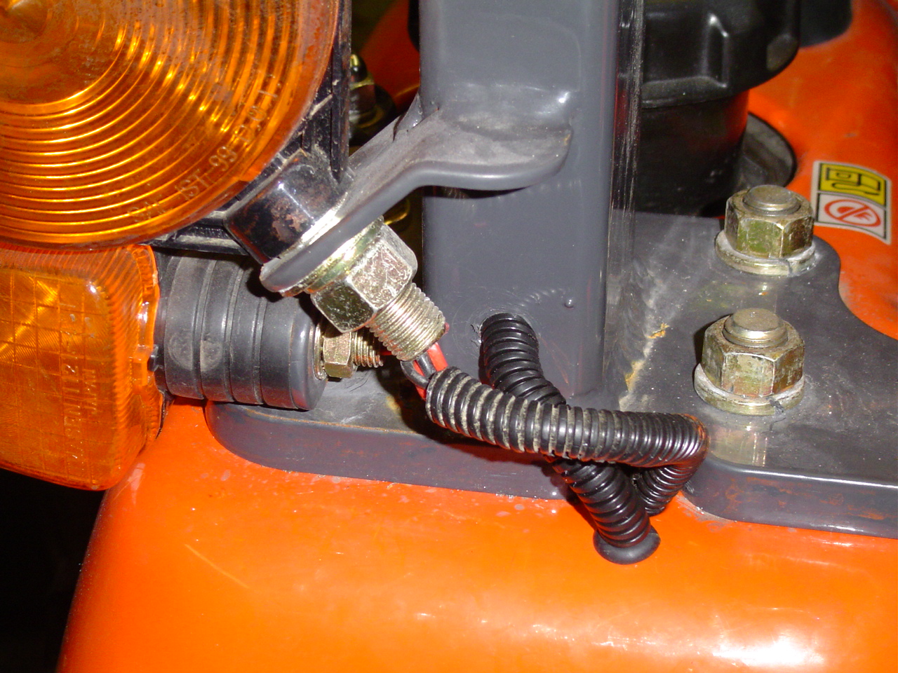

Close up of where wires exit ROPS.

Very professional looking! These babies should burn a very nice hole through the darkness.
