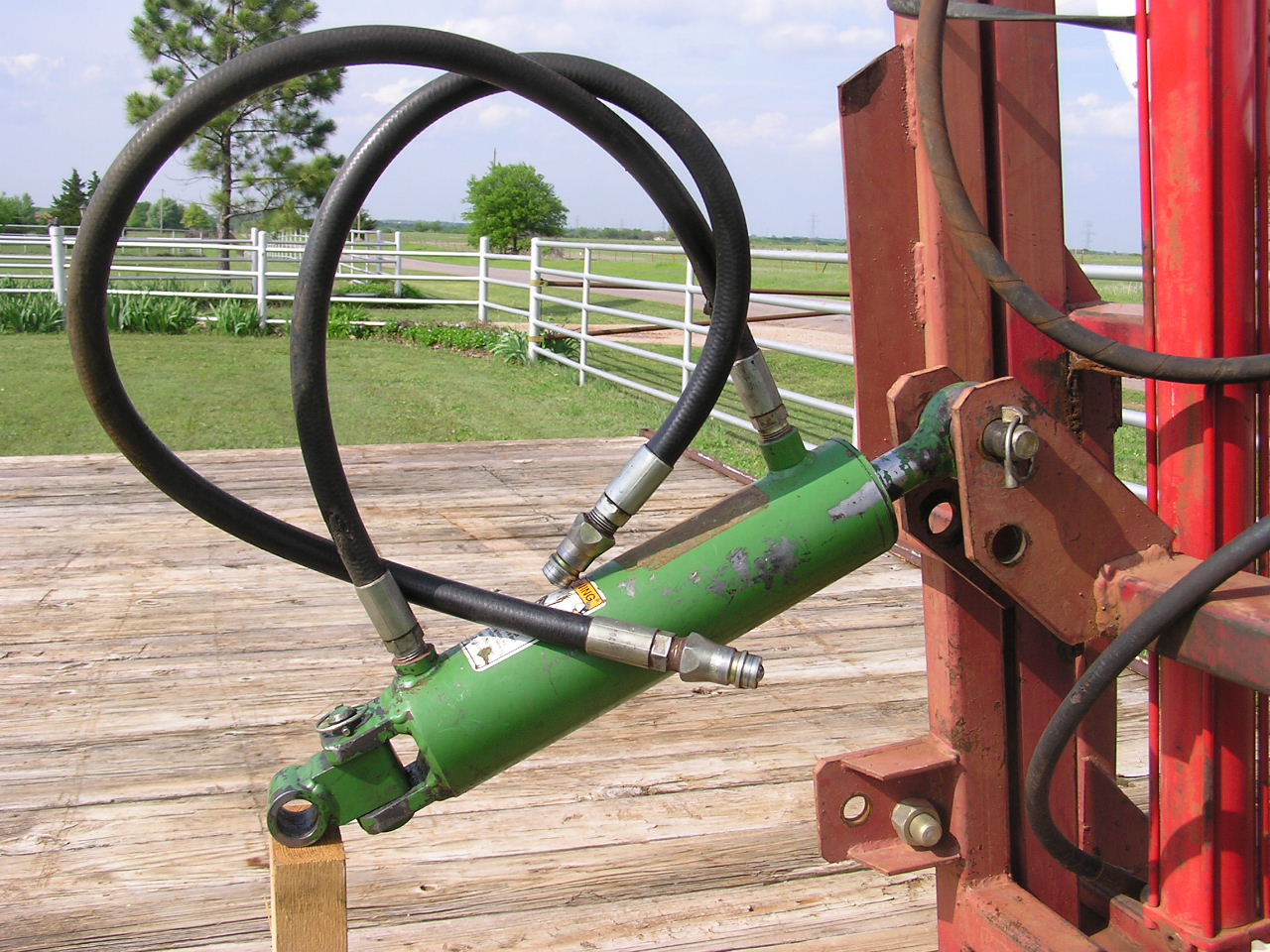

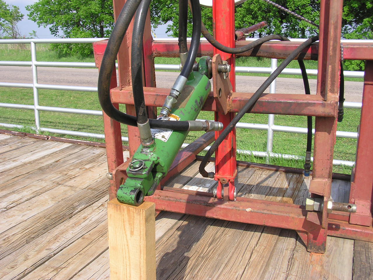

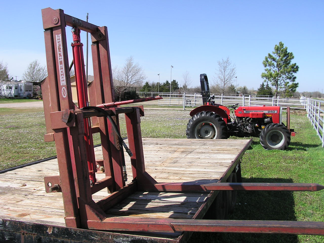

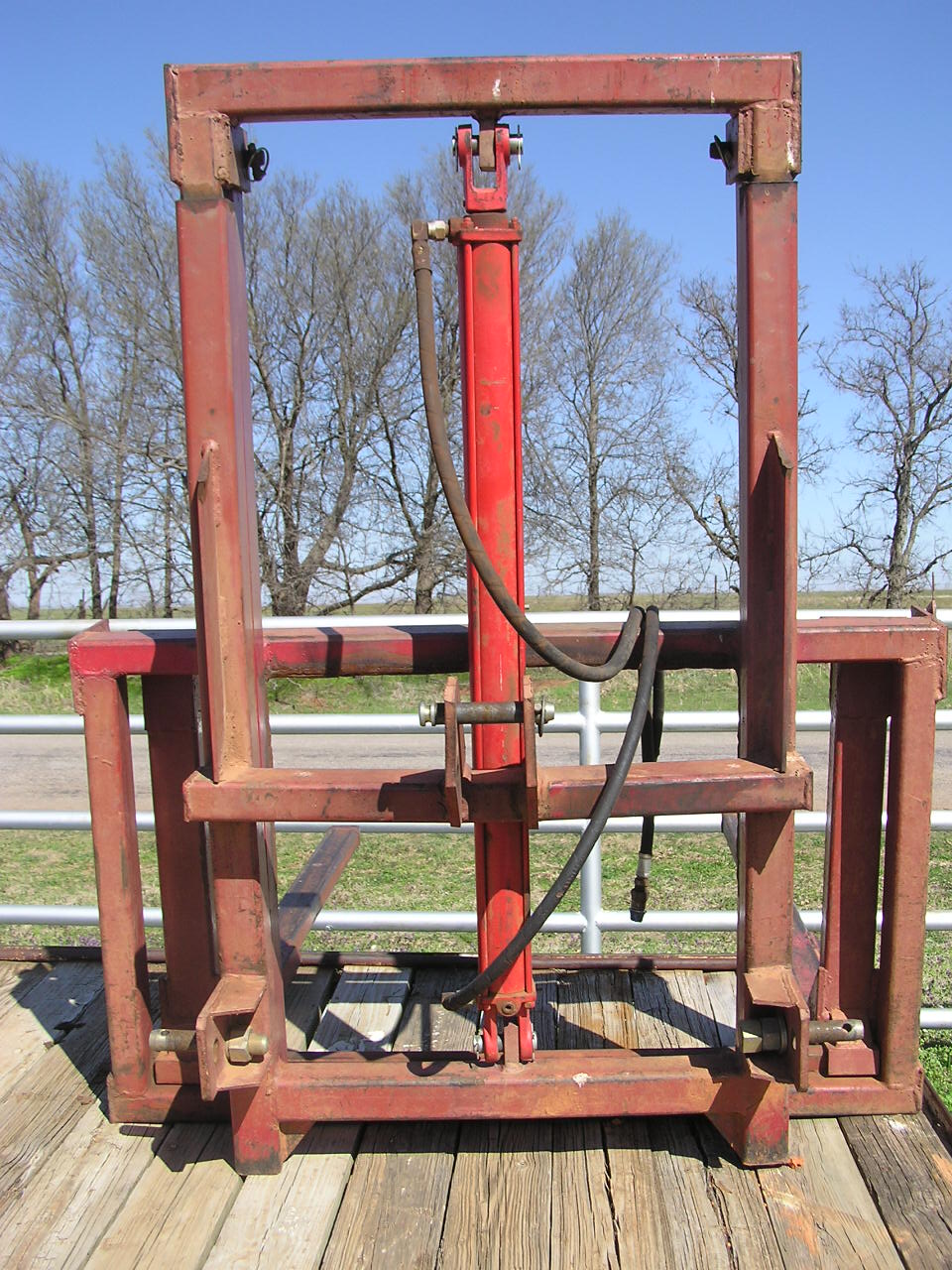

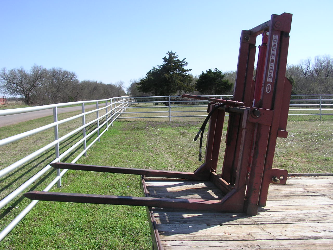

Didn't build it, bought it at an auction 10 or 11 years ago. Sold it 4 years ago when I sold the tractor.
Got to have a hydraulic top link.
