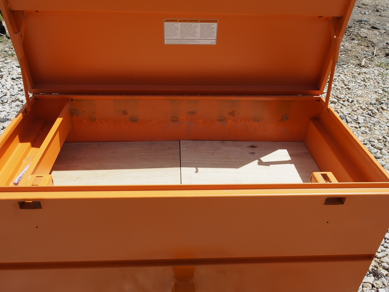

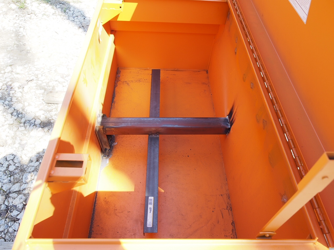

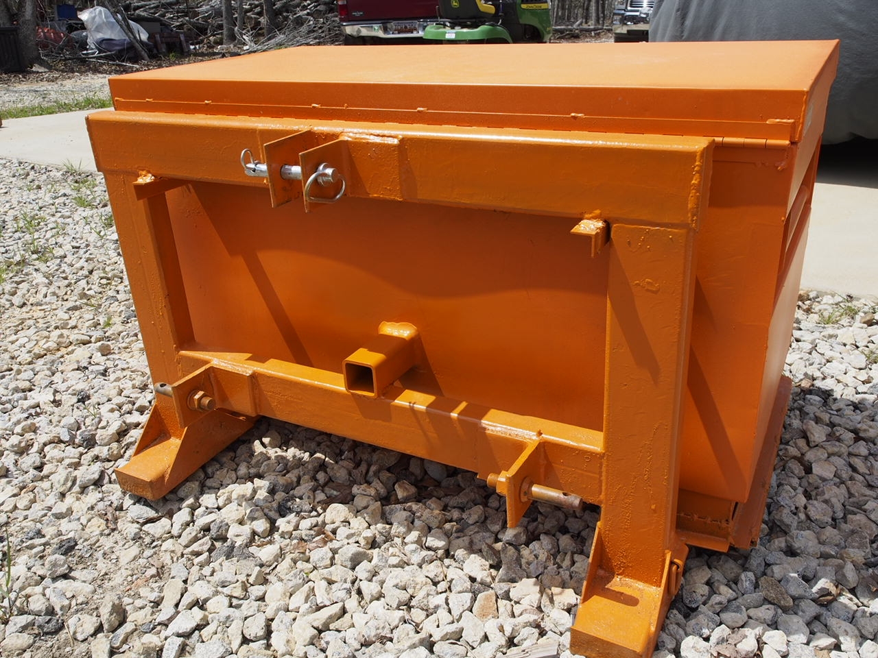

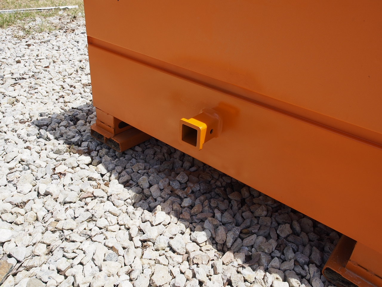

An old 3pt carryall with a Home Depot job box welded to it with concrete added. 1235# as it sits with room for additional weight or tool storage inside the box.

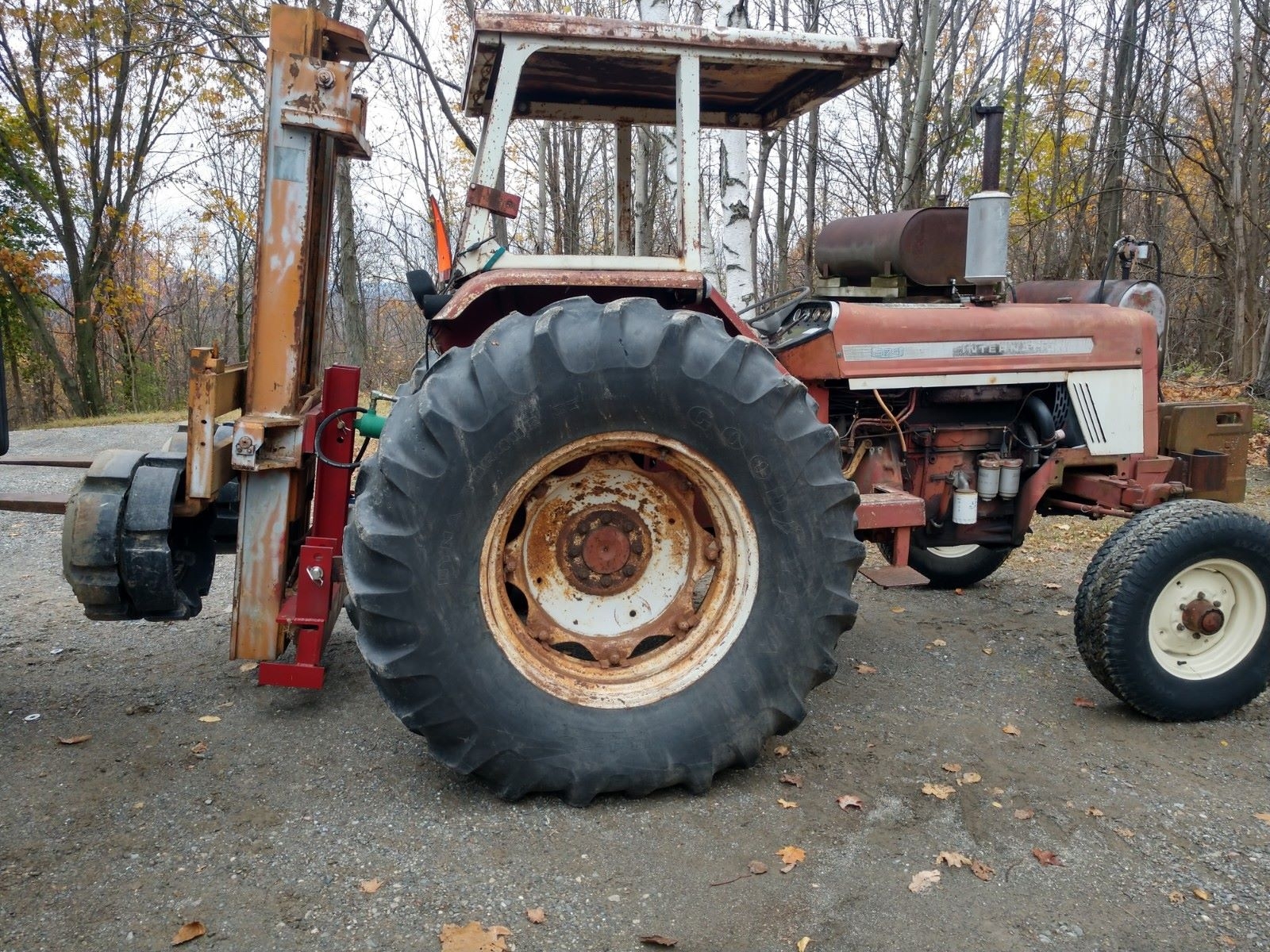

I used a forklift mast to 3 point before i got my loader pallet forks. I still use them at times,

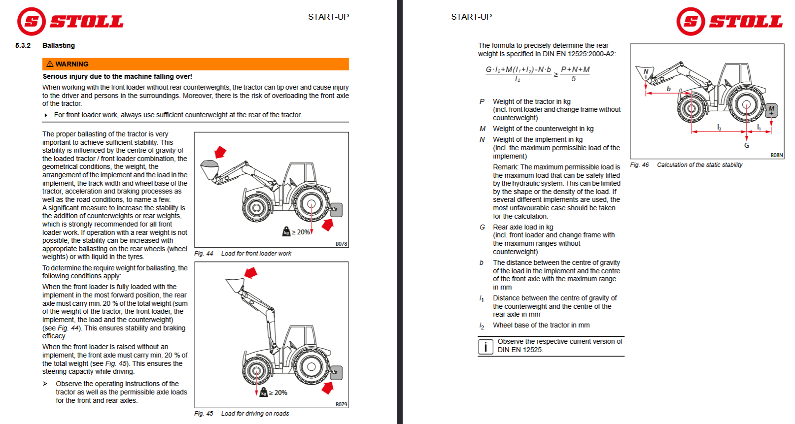

I can not stress this enough. Always use counter weight when doing loader work. Not only it makes it a lot safer, it also prolong the lift of the front axle bearings and seals by a lot.
You really want to keep at very least 20 to 25% of the weight in the rear axle when doing heavy lifting and doing the math, that often requires to have as much weight in counter weight as whatever being lifted weights.
Straight from a very well known loader manufacturer:

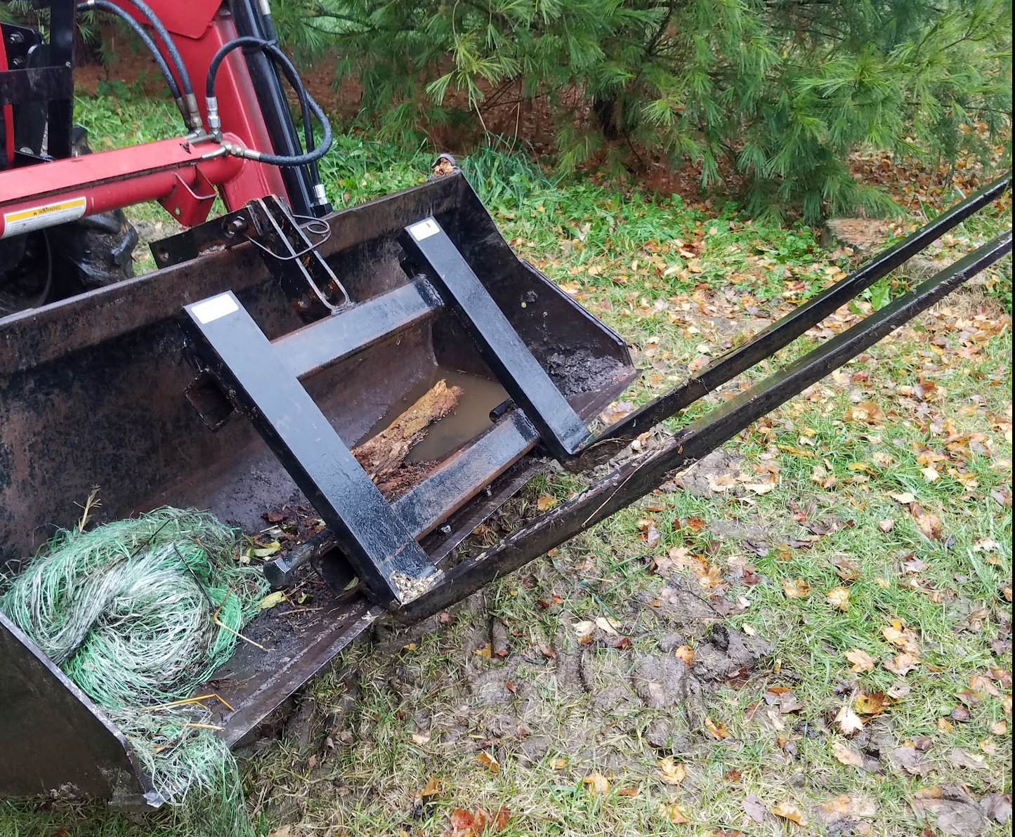

I wouldn't plan on using forks for ballast. When I use the FEL, I tend to forget about what's hanging off the back. It needs to be very secure. Once in a while I use the brushhog, but too often I hit things with it. I filled my tires with beet juice. I highly recommend it. The weight is low and off the axle.
That said, I really like my forks. I made them to fit in the bucket or on the 3 point:
