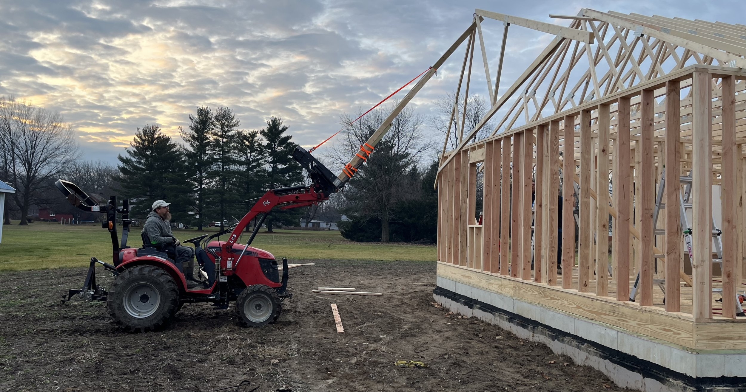

Pretty neat process you all have come up with.
For these smaller operations, without a bunch of people walking the roof, how do you unhook the truss from the boom you have up in the air with the tractor in use? Like in the picture directly above?
Tall ladder. Might not work for everyone.
I did my 32 footers by myself. I'd lift one up and lean it against the existing rafters, jiggle the slip hook to release and then do a second one. The second rafter I would just leave hanging loosely on the loader. Quickly up one side and toenail the rafters onto the sill, and then to the center to do the nailing there. I had to be quick with the center as the loader would slowly sink and I couldn't push two rafters into place at once. I would then get the next strapping into place in the center and toenail the opposite side and repeat all over again until I was done. Ya those were my younger days....

I used a tall step ladder to unhook my boom pole from the frames for our garage. I had a 10 foot step ladder that I could reach the connection point with ( I would never stand on the top step) I used a piece of rope to keep the connection close Because I didn’t have a longer piece of square tube on hand. Cam

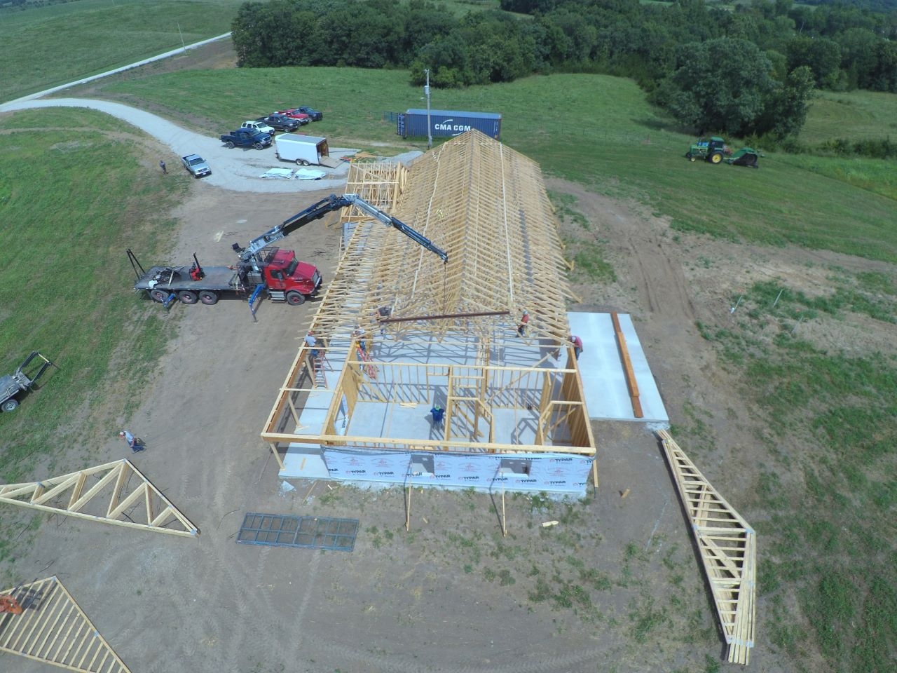

This is how I put my 60' x 120' shed up.
