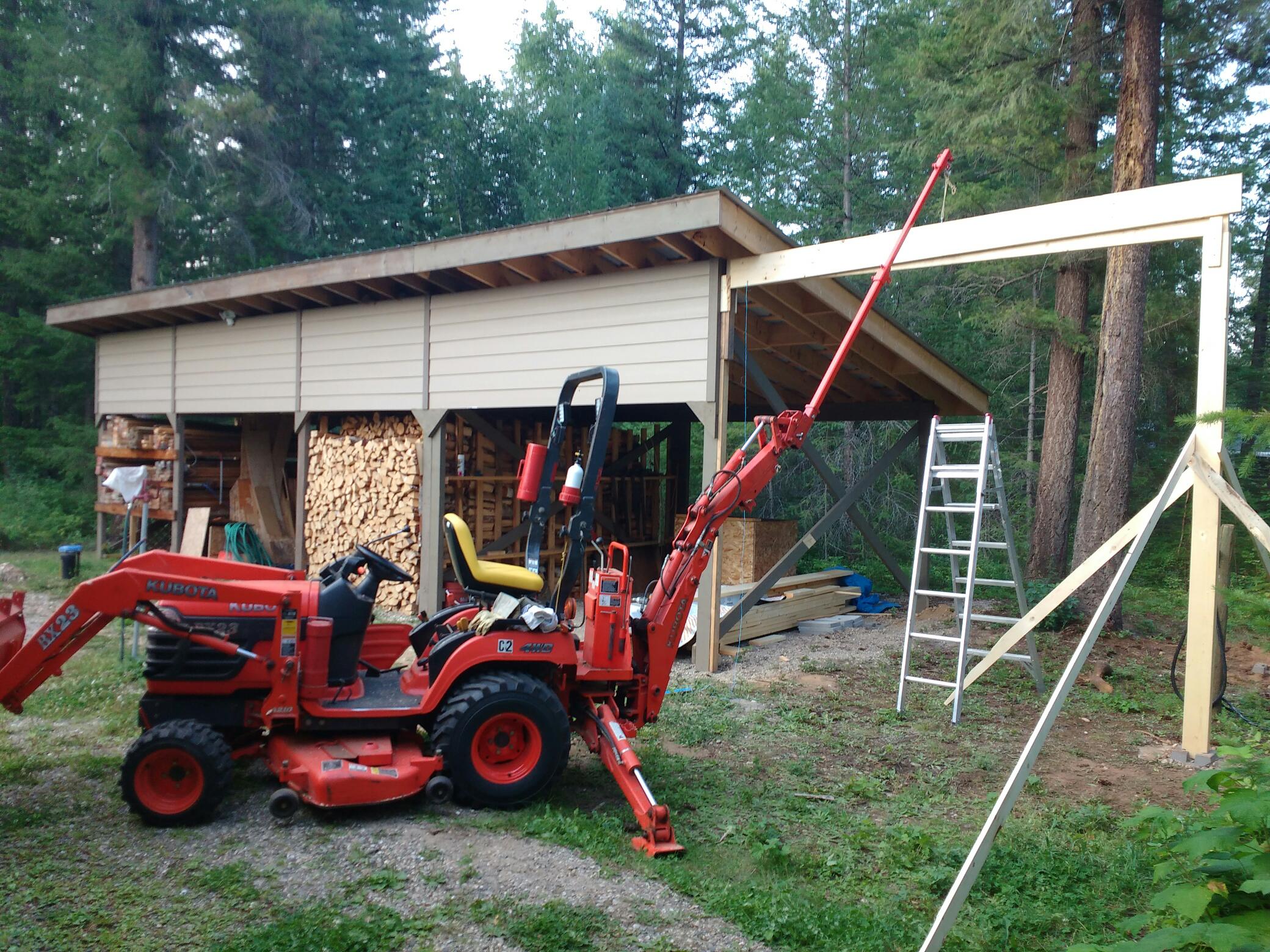

So, I'm thinking about what to add onto my 4600 tractor to serve as a small crane. It has a 460 front loader and the backhoe on the other end. I have pallet forks, so I'm thinking of slipping some square tubing over the fork tines to get a little more reach. Maybe join the tubes at the end and also add some hooks out there.
If you plan to fab something for lifting higher, have you considered fabbing something for the backhoe rather than the loader? Your BH's loader and arm will be more rigid than whatever you extend the loader with. And you'll have east/west truss tweaking.
The backhoe boom is almost certainly a better crane but the problem you’re likely to encounter is you can’t transport much weight with the stabilizers up without tipping backwards.

My Case would be stable enough with 200 lbs overhanging by 5 or 8 feet. He could spot the trusses off to the side but within reach of the planted BH, swing over and pick them up.

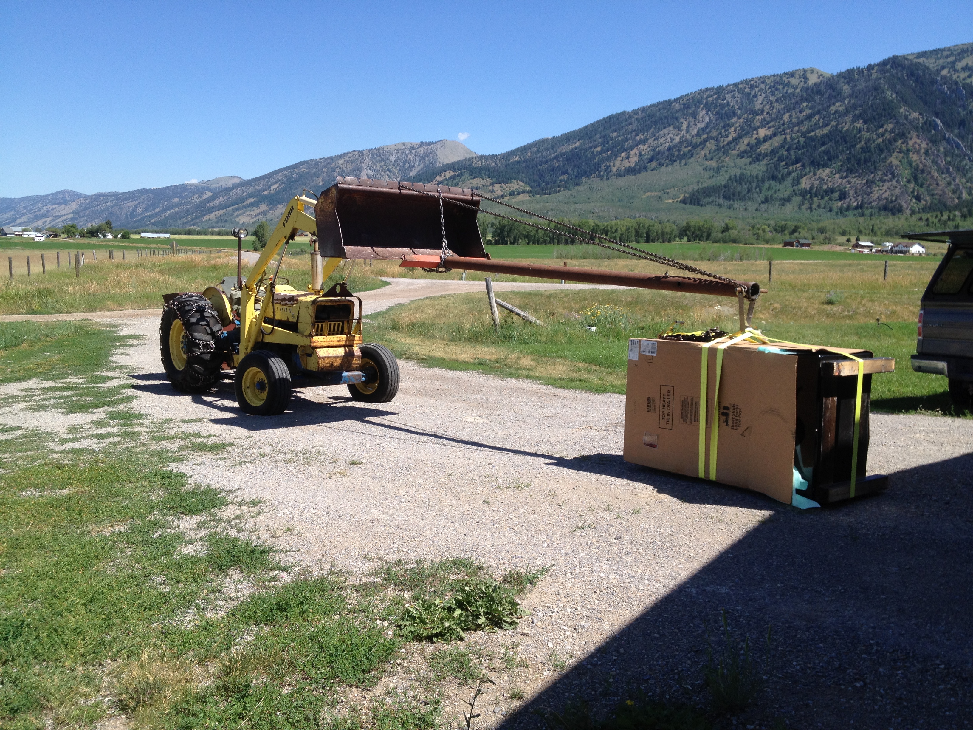

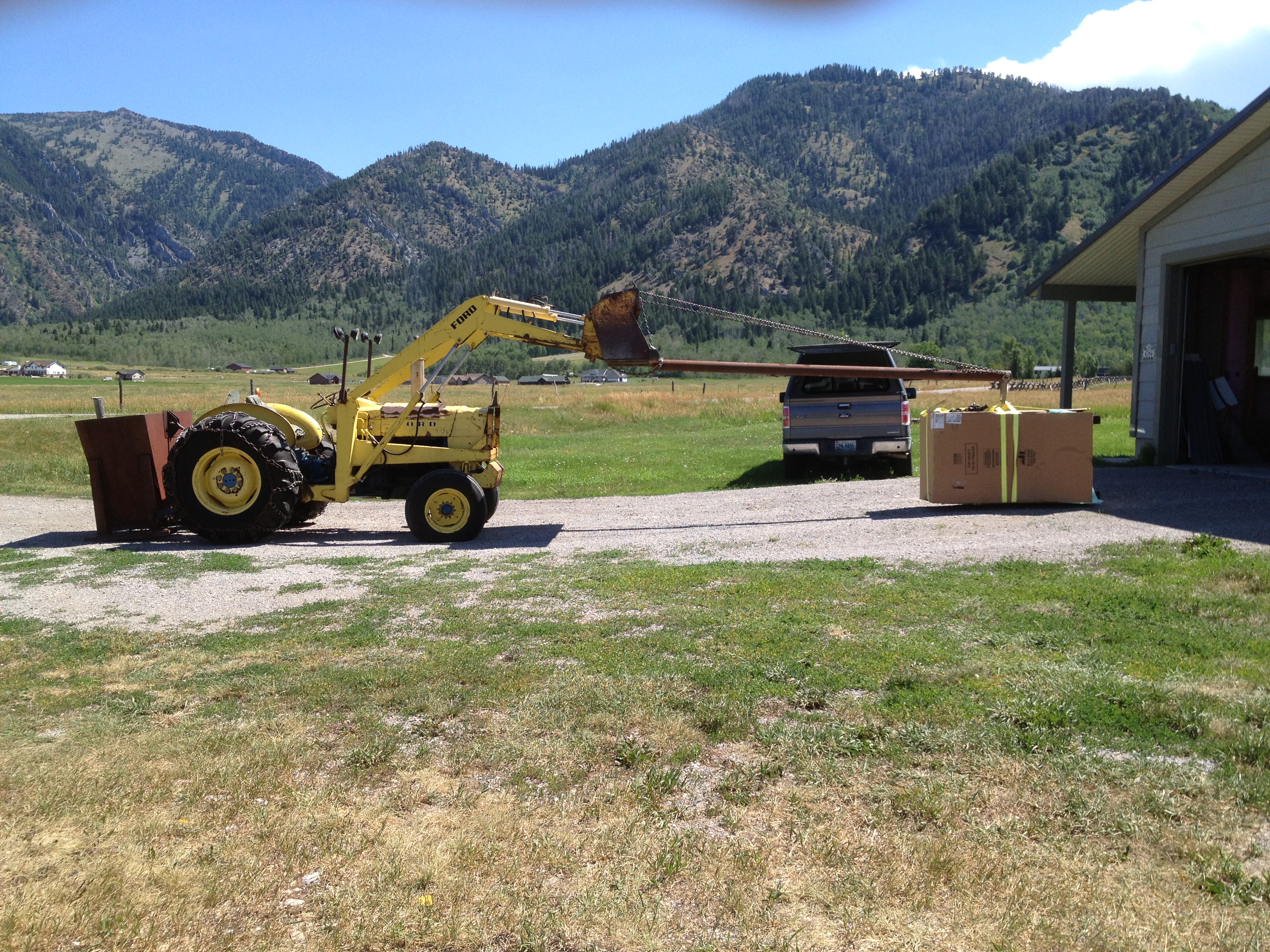

we bolted a pipe, (square tube would work fine) to the bucket of a small farm tractor and ran two cables to each upper corner of the bucket and put a bit of tension on them, the pipe had a loop welded to the end on the under side, and we put sizzer trusse up on a 40 wide building years ago, we left par of the end wall open
seem like the beam was about 16 foot long at the most, used the loader lift and the bucket cural , my friend ran the tractor I was up in the rafters nailing on spaces, and there was some one to hook the truss on the end of the boom,
nearly just like this web site shows, truss boom | N-News a little different idea but much the same, http://forestryforum.com/board/index.php?topic=67789.0

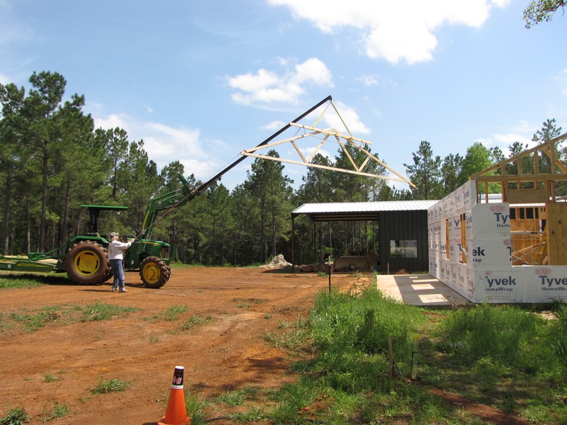

This is how I did it on my horse barn in 2016 and I raised them when I built my shop in 2010. It works well, costs maybe $200 for the day, you can set roof purlins on the end trusses real easy with it and there is always a tree limb somewhere that needs a lift to be able to cut it.
